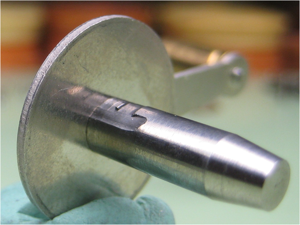

I jumped into this as the price was good. But I can still cancel. So if any of you has bad experience with this set, please tell me. It's a Depose set from the 50ties I believe.
I have several of these, some marked Bergeon, some no name (depose' is French for "patent pending"). These older sets have larger winding arbors than the newer ones marked "Nivaflex", but you can use a smaller arbor in a larger winder- the hole difference doesn't really matter, and if the cap on the winding arbor is really too small you can cut a hole in thin  plastic sheet and fit it over the arbor under the cap. On all of these, often, the winding hook is sticking out too far- it's good to trim it down with a file so it's about as high as the thickest mainspring it might see (the hook can damage the coils as you wind if it's sticking way out). Sometimes the hook is too wide too, again, easy to trim up with a file.

The arbors on this set are round they don't have the recess filed in were the hook is, the hook is a wire that is soldered in a hole through the arbor bent to one side so they are right handed.
I watched leo vidals youtube review of a new set of bergeon winders, the hook is filed from the arbor itself not wire and as the flat reccess.
here's an image out of the PDF on the modern and it's. Typically on the modern Springs of the part that goes on the arbor is very tightly circled and requires a hook that barely sticks out versus the old blued steel Springs where it could be just about anything and you definitely need a more aggressive hook. But the reality is you need all of these things because they're always be one mainspring that won't want to look at all even if everything looks like its right you may have to do a little bit a mix and match.
let's look at some images of handles for my pocket watch set that I like that goes in either direction as you can see it's a pin that six out and you'll notice there's two of them. Though actually do two separate sizes depending upon where it is as it moves in and out.
then this is what the old style handles look like for the Swiss set as you can see it's quite aggressive versus the modern
then here's what the modern ones look like. Then a note especially with the older ones they may not look exactly like this depending upon how much abuse they've seen or whether somebody got desperate and file them which is not a good thing to do
