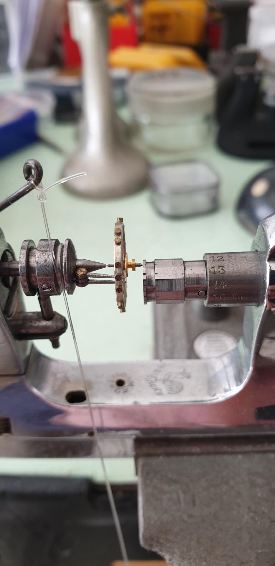

I am a bit disappointed in the new  jacot tool i bought because although it is a complete set, the spindle on the right (red arrow) isn't large enough to hold any of my PW wheels other than the balance and  escapement.  I tried both sides of the spindle.  The spindle on the left (yellow arrow) is also too small, but i'm thinking that might be ok since the left pivot will simply ride on top of the groove in the spindle.
Question: So if that is the case, how are folks polishing the pivots on the larger wheels.  Are you using a lathe or some other procedure/tool.  I appreciate any information that can be provided.  Have a good weekend.

Jacot tools should have the runners marked in pivot size, some have arbitrary numbers but most will be marked in metric. So if you want a 0.12 pivot, you put the part in a 0.12 bed (bed is the grooved part of the runner). Unless- you are starting with a larger pivot, say 0.15, then work your way down, from bed to bed. Some tools will make exactly the size pivot marked, some will make a pivot that fits in that size jewel (a slightly smaller pivot). The size is dictated by the depth of the groove, so when the burnisher will no longer cut, the pivot is level with the top of the groove.
Conical pivots should be set so that only the cylindrical portion is in the bed. Square shoulder pivots, bring the bed right up to the shoulder. On the pulley side, the runner is a simple female cone, and it works with the tip of the opposite pivot. As long as the tip gets in there it's ok. Yours looks fine to me.

Thanks guys, that's all very helpful.  Apparently I have the small size pulley-side spindle.  Based on my internet search I am guessing that finding a larger stand-alone spindle would be exceedingly difficult.  nickelsilver, what do you think about drilling out one side of the spindle to accommodate larger pivots sizes.  I wonder how I'd smooth out the new hole so that the pivot doesn't get damaged.  Do you have any thoughts on that?
How large of a pivot do you want to fit? Do you have a runner with beds large enough?
If you need to open one side of the simple runner, it's a little tricky. Assuming you have a lathe, you still need a cutting tool to cut the cone. I would make a simple 3 face cutting tool from carbide but I have the grinder for that. Maybe try to find a 90 degree carbide spotting drill? As I recall Steiner used 90 for their cones so should be a good choice. A regular drill tip isn't angled enough.
Right now i have pivots sizes .4 mm and .8 mm.  I don't think they fit correctly in the runners with beds, but i figured for some light polishing they would sit tall in the bed and could be worked on in that way; although i don't know if that then puts the pivot at an angle and makes it harder to keep cylindrical.
The drilling of the spindle sounds a bit more technical than i have the aptitude for and i don't want to ruin it.  so i think for now i'll try my lathe and then some day i might find a larger spindle or upgrade my entire jacot for one that comes with a larger spindle.
Thanks nicklesilver.  Arron.
Yes, if you put too large of a pivot in a smaller bed it will sit high and at an angle.
Since you have a lathe, it's pretty simple to make up a whole new single runner. They are often a nominal metric size, then reduced along a length for the pulley. You can make the cone by simply cutting it with a sharp pointy hand graver. For occasional use it doesn't even need to be hardened. But if your beds are too small it's kind of moot.
A workaround, and a good one, is to make a half-runner that fits your lathe tailstock. It can be as simple as a piece of wood dowel, or you can use brass. Drill it the size of your pivot, file it down so the drilled area is exposed, now you've made a "bed", grab it in a drill chuck in the tailstock. Chuck one end of your part in a collet in the headstock, and rest the pivot in the bed. Now you can use a pivot burnisher or file safely without stressing anything. I knew some old clockmakers who only worked pivots like this and they did very good work. After a while you end up with a collection of beds and don't have to make them anymore.
