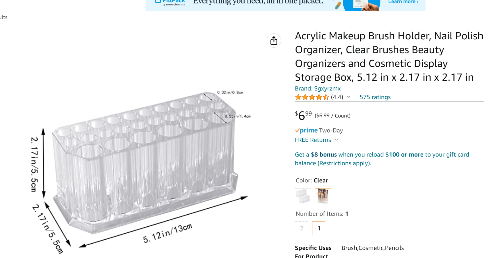

1 hour ago, Waggy said:
Not sure if this technically qualifies in this topic, but it is a thrifty 'tool' purchase:
I ordered one tonight.  Great idea, thank you!
Edited by thor447
