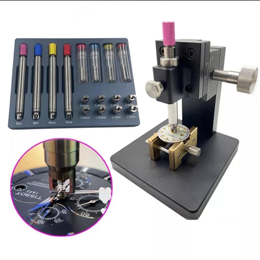

Does anyone have experience of this hand removal tool? I guess it's for hand fitting too? Now I have a very cheap and wobbly hand press. There's so much play that it's like doing everything free hand. This one's $176 in Ali. Any hand press suggestions?

I have one and I have had issues with it. The pushing needle is not exactly aligned the relevant holes and slot so it is extremely fiddly. I have only used this tool twice so it might just be me being cack handed.
Edited by clockboy
I bought a hand press, but find them fiddly to use. I prefer just to press them on by hand. A removal tool for chrono's is useful. Have you got the price right - I see it for £48 ($58)
There are different prices for parts of the set. Complete set is $176 for me. I like to press a little with tweezers and finish with a press for some precision. That tool doesn't seem to come with any hand fitting attachments but according to description it should accept screw-in Bergeon pushers that cost like £17 a piece.

Is the needle used just for keeping the hand from falling when lifting the hand? Have you used it as a hand press?
I purchased the hand lifting tool to help remove really tight hands such as the sub seconds fitted to Brietling chronographs.. I found to my cost using the normal method ie levers etc don’t work and the hand pipe becomes detached.

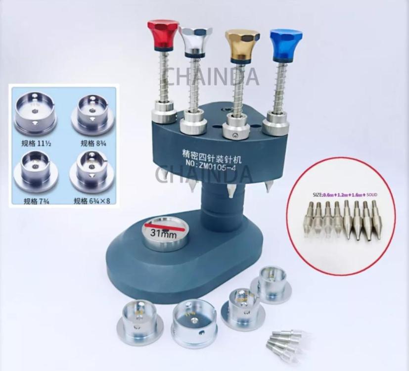

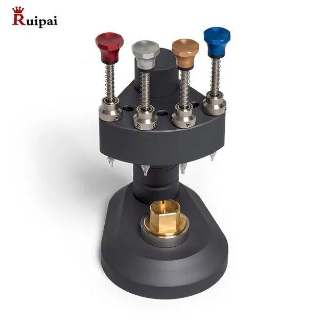

I noticed today that some sellers of the Aliexpress jeweling Horia clone are now including hand press attachments. This seems like a very precise way to set hands, but also an easy way to inadvertently press way too hard.
I don't have the movement holders for each specific movement, I just use a Bergeon 4040. So if the movement isn't sat exactly flat, and the often aren't, then the above type of hand fitting tools are no good. Hence I find just simple hand held pushers under a microscope work fine.

I have one of these and really like it.
One more thing. Don't you need to have many different size movement holders with it? The one I linked comes with four different sizes but even the biggest, 11½ Ligne, is too small for average Seikos. Larger holders don't seem to exist except for obviously the Bergeon ones that cost a lot.
Yes, although you don't have to. However, if you use the holders designed for the press then you don't have to worry about lining up the holder to get the plunger aligned to the center hands, which for me is one of the biggest benefits of this press. With a normal movement holder you can make it work by covering the holder mount with something flat but then you have to align the plunger to the hands every time. Of course, if doing a chronograph or sub-seconds watches you need to move the holder regardless.
Someone uploaded a 3D design so you can print out a platform for the press. You can also 3D print the movement holders so you can have a custom holder for any movement you use with the press.

Thanks for the quick reply. I just noticed this was discussed on a previous page. I knew I had seen the discussion but somehow didn't find it with the search. I ordered the press and a Bergeon 5409 copy too.
