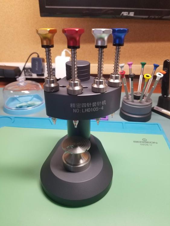

I received the hand presser.  I was surprised at how heavy this thing is.  It is solidly built.  No slop with the pushers that I have heard about with the cheap cheap hand pressers.  The extra tip storage is nice.  Though, I'm not sure that I will be needing extra tips.  It came with a set of plastic ones and a set of metal ones.  I'll be using the plastic ones to help protect the watch hands.
I'd like to remove the lettering on the head.  Maybe acetone?  I'll try a bit on the underside to see the effect on the gray finish.
Tried it last night to finish off my latest project and it worked quite well.
I paid just under $100 for it, which includes shipping and tax.  This one looks to be a good budget alternative to a Bergeon 8935 at less than 1/10th the cost.  Better option than the version of the Chinese Horia that comes with the hand pressing tips.

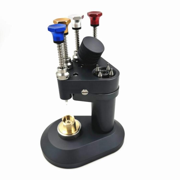

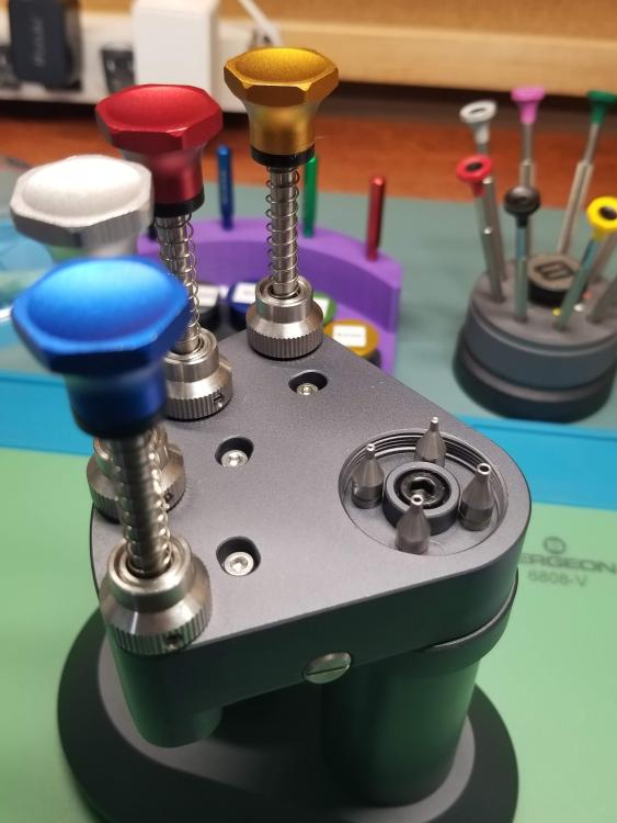

I'm curious if all of the Bergeon 8935 clones have a cap on top for storing extra tips or is it just some of them?
Had no idea the cap came off, I will check mine out when I get home!

Let us know how you get on with it. I bought a cheap one, and hardly ever use it. Unless you can hold the movement perfectly flat, there's no point using an expensive hand press.  If you use proper movement holders, then it makes sense, but using normal movement holder, it's often hard to get the movement flat in the holder.
I have no problem using hand tools under the microscope.

So far so good with using the hand presser.  I use this holder with it.  It is really just a platform to set the movement on and fits perfectly into the cup of the hand presser.  It does have an adjustable central pin to support the center jewel.  Though, you have to adjust it from under the holder, which isn't ideal.  It would have been better if you could spin the top of the holder and that would adjust how much the pin protrudes.  I thought about modifying it to do so, but had not gotten around to it.

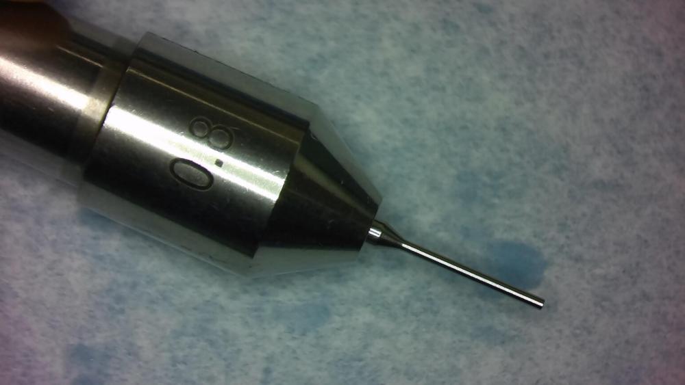

I measured the jeweling set, and I'll say the sizes seem consistent, but a little small compared to the printed numbers. Pushers seem to come in about 0.04mm less than marked (220->216). As far as I'm concerned that shouldn't affect its effectiveness much. The actual pushing edge looks decent, but could be dressed to a mirror finish. They come apart and back together without any issues.
Here is one pusher out of the box.
and after a little dressing.. (first time trying, and probably needs a bit more):captured_photo.thumb.png.767d17798677cbd838de86cfafb5c623.png

How did you tidy up the ends of the pushers ?
Alex has a good video on polishing pushers and stumps.
Yes, exactly... followed alex's video.
I have an older favorite set, but I bought this set because it was cheaper than replacing the few missing pushers, and I figured I'd get a whole set of stumps as well. That set cleaned up great following Alex's instructions.
