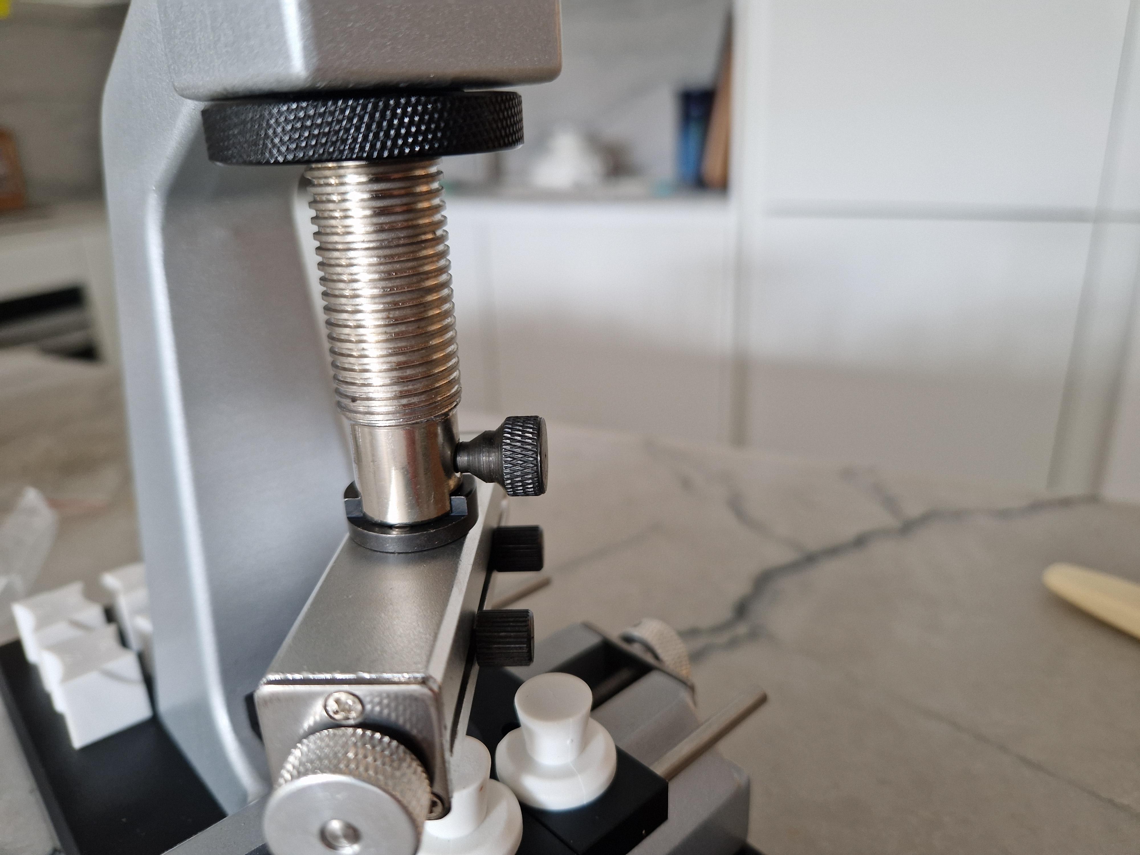

Hello all,
I'm happy to report that the new case opening tool from Vevor is much better. The lateral play is minimal and feels just right.
Funnily, it doesn't look like the one on their website. Literally none of these three points (from the pic on their website) actually applies (except Point 2 - it is metal, but a different colour):

It looks, however, much like the one posted by @Malocchio
Here are two photos:
20241004_113808.thumb.jpg.2d839e96aa0492d3db2952f6a21538ba.jpg20241004_113819.thumb.jpg.b67040a18a966735a3f103ca9294b59a.jpg
From the initial inspection, I'm very content. I'm glad to have sent back the other one, which was inferior to this one.
That's the problem with AliExpress. It's a gamble as to what you will get.
From your pics, it looks just like the one I have (apart from a different handle).
I think some of the play in mine came about due to bad packaging, resulting in the broken handle and bent frame.

I'm not sure if we understood each other correctly but I tried to tell that I'm happy with mine. No plastic knob, not too much play. Seems like a good buy.
Yes, it was clear: You are happy. My new one looks like yours. I'm also happy with the new one 🙂
