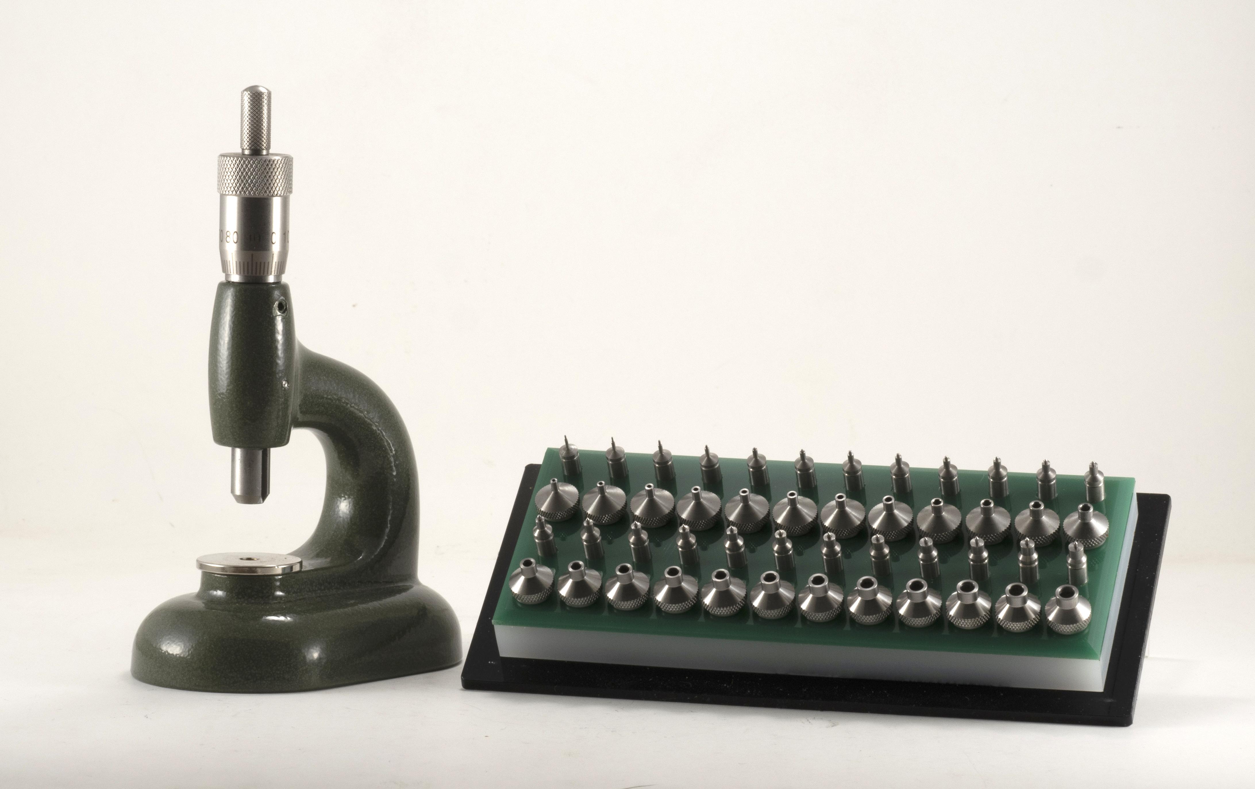

Hi all
Time for the next tool in this series
This time is the good old Jewelling tool
Seen before on the forum but still well worth a second look here.
Again from Aliexpress for £117 for the tool and a nice selection of 24 pushers and anvils which are all well made and seem to do what they are supposed to do,
https://www.aliexpress.com/item/4000261581571.html?spm=a2g0o.order_list.0.0.119c1802OtQ8wu
Obviously a clone of the well known Horia tool but a well made tool none the less and at a fraction of the originals asking price.
Not used it in anger yet but have used it a couple of times to adjust end shake and that function was performed faultlessly so doubt a jewel replacement will be an issue for this tool either, once a replacement jewel has been found that is.

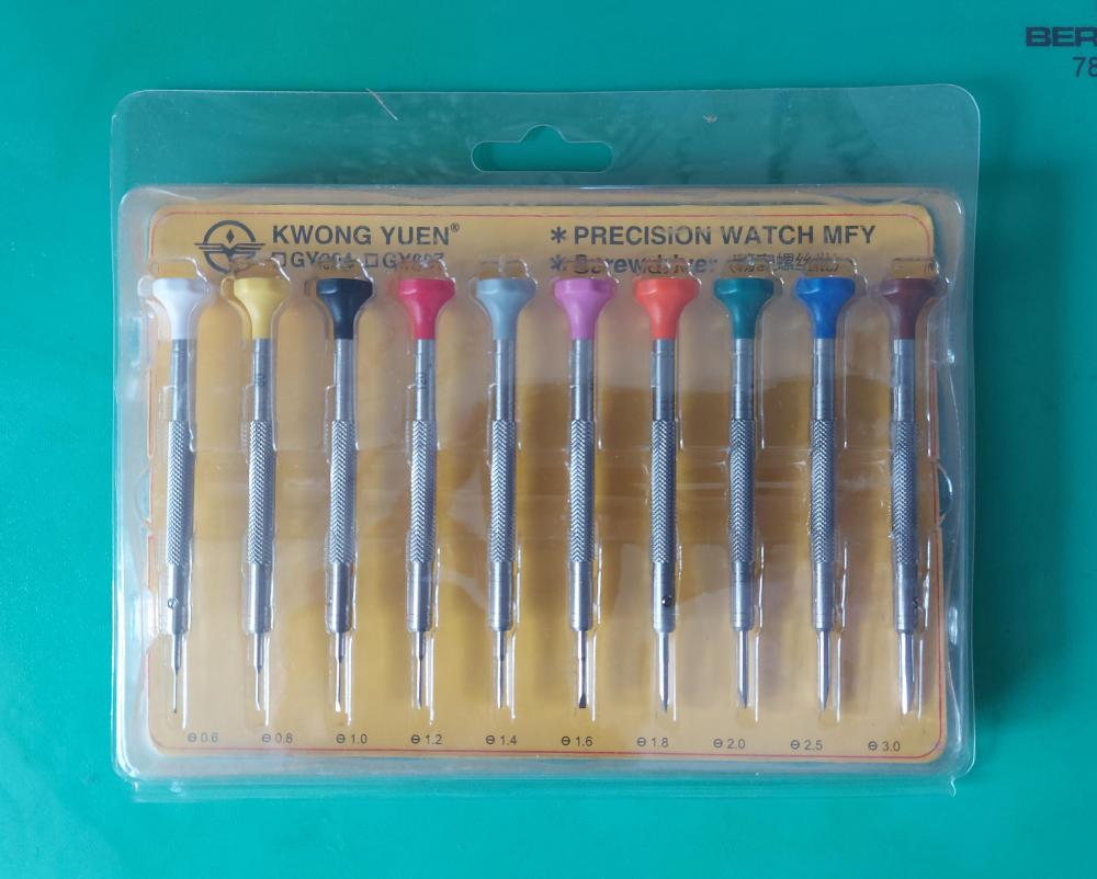

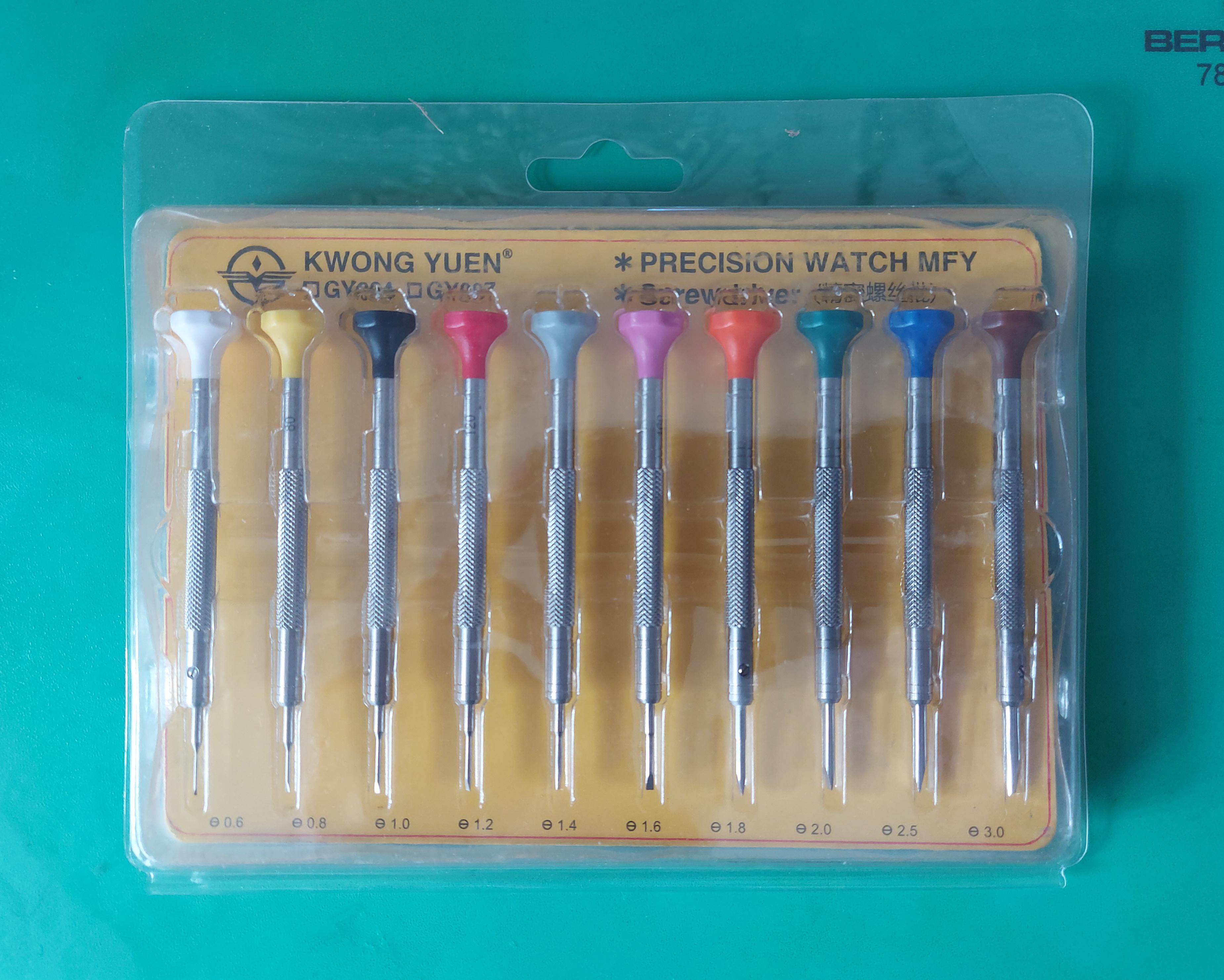

Hi all
Time for the next tool in this series and this time we introduce a little controversy
Yes we are now talking Chinese Watchmakers Screwdrivers, could there be such a thing as quality watchmakers screwdrivers from China, I think so.
I had in the past tried some low cost drivers from China and to be honest after a little bit of work, hardening and tempering and honing the blades they worked quite well, although in the end I settled on the French (A*F) set that Cousins sell, these were an excellent set but my only gripe would be that the thinner blades where a little to bendy and it was quite easy to bend them if applying pressure on a tight screw.
This led me to these.
https://www.aliexpress.com/item/1005002528364614.html?spm=a2g0o.order_list.0.0.56751802D1Kqw7
These turned out to be a very high quality set with very rigid hard set of blades. Replacement blades are also available from the same seller should you need them.
For £23 plus VAT & P&P they are quite a bargain.
Again like some of the other tools in this list their similarity to some well known Swiss drivers may or may not be totally coincidental 😉 .  I can highly recommend these, so much so I have just bought a second set, just in case 😉
Stay tuned there are some more controversial tools to be added to this list soon.
You're right about that Paul. It works flawlessly also when replacing jewels. BTW great thread and initiative!
I have this Chinese Horia jewelling tool clone and I'm more than happy with it. As far as I'm aware the only problem is that QC isn't 100 % perfect so don't expect absolute perfection. I have written about this previously. See the below link:
You had me worried there for a minute.
Just sat here checking every single one of the 24 sets, top and bottom and luckily all of mine are on spec and fit fine.
The CNC man must have been on the ball when they made mine
Yep, it happens, but be aware that the CNC man isn't always! I've read about other minor glitches in QC for this tool, but hey, for the money, it's a no-brainer.
Out of curiosity, if you had a few pushers/anvils that were an issue, could you easily replace them? Are they expensive?
This would be one issue with buying these Chinese tools, they sell a full set but nothing on their own, so if you wanted one pusher you may have to go looking for a Swiss version, mind you new they want almost as much for one pusher the the Chinese are asking for the whole set of pushers and the Anvil so it would be cheaper to just buy another Chinese set.
£99 for a full set including Anvil from China or £935 just for the pushers from Cousins is a no brainer to me
