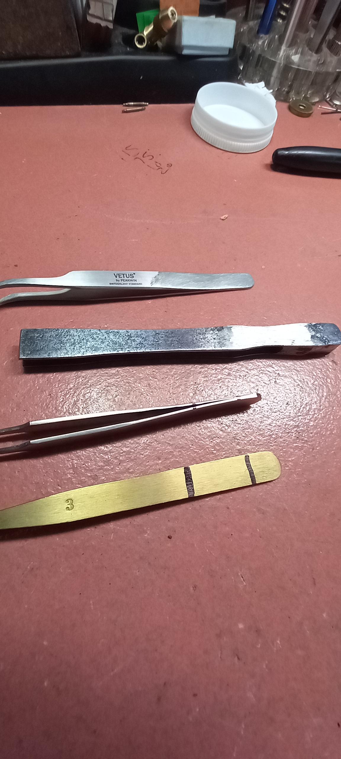

Can you tell us more about how you thin your tweezers and perhaps illustrate (in words or with a picture) exactly where?

Just around the join H , where the pair starts, here are 4 that I did when I started. The vetus I think were the first, so a bit rough looking.  The second pair down are very heavy strong machinist's tweezers, I had to thin both the flat and the edge ( you can see were they curve in then back out ) because the tension was unreal on them . Third are titanium  and the bottom ones are brass. I dont actually use any of these now except maybe the machinist one in place of pliers. I used a miniture drum sander to take out the bulk of the material then finished them better by hand.

...The vetus I think were the first, so a bit rough looking...
Back on Chinese tools... How do you like the Vetus tweezers? Where did you buy them?
I really can't remember where i got them, they were one of my first pair, quite cheap. The tension was stupid and even now after reducing it, its way too tight. I only use bent 7s for hairsprings, without a lot more work these would trash one.
Excellent explanation and illustration. Many thanks! 🙂👍
