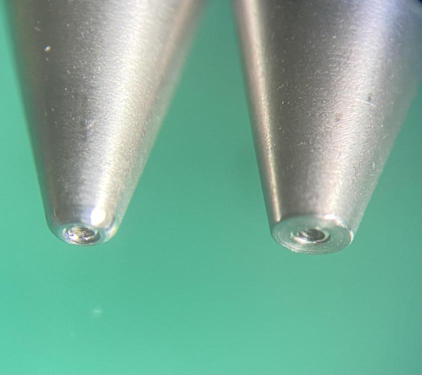

On 3/22/2022 at 12:08 PM, Paul80 said:
Next up is a Basic Staking set again found on Aliexpress.
I just bought this Chinese Bergeon clone for €107,- and was curious to see if it would actually be usable.
Unfortunately, I got very disappointed.
The punches are apparently not hardened and are therefore unusable for tasks such as riveting a balance staff.
Here an image of the tips after the riveting process. The staff was harder than the punches.
The punches are apparently not hardened and are therefore unusable for tasks such as riveting a steel balance staff.
Oh damn, that's bad. Quite ridiculous actually.
This is what I supposed, but you are the first to confirm. Seems all the other buyers of this tool keep silence about it or just use it for display?

I've had the same experience with my set. Also the rounded punches need reshaping because they are not rounded all the way to the hole. So the part that strikes the balance staff might as well be a flat punch.
14 minutes ago, HectorLooi said:
I wonder if it can be heat treated to harden it.
I'd like to try but would need some guidance from the collective wisdom here.
Place it on a fire brick and heat it with a blow torch till cherry red, then quench it in cold oil. It will be fully hardened and brittle at this point. (Assuming that the steel is hardenable.)
Polish it back to steel color then heat it again till straw color and quench it.
Is this last step cosmetic or functionally required to make it less brittle?
Thank you! Would it be just the tapered portion of the punch that I heat to cherry red / straw colour? Or the whole punch.
And I'm assuming any reshaping of the tips should be done before tempering. Good assumption?

The punches are anti-magnetic. They appear to be made of chrome steel.
Can they still be hardened? I'm in doubt about it. 🤔
Edited by Kalanag
The staking set is „qualified for free return and refund“. So I sent it back today and hope for refund. I‘ll let you know.
