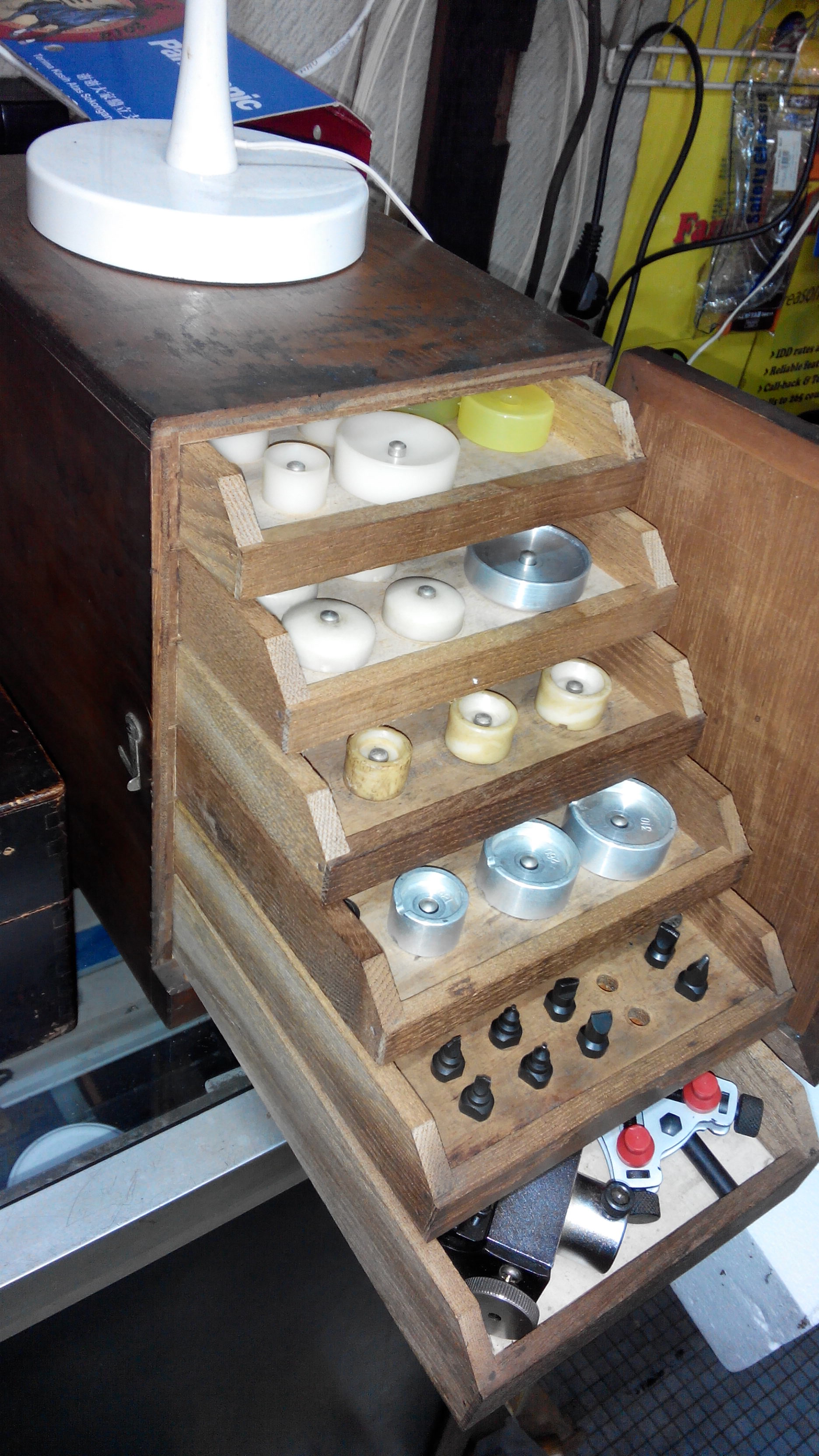

This is a Seiko case/crystal press and case opener that I'm using. I love it as it served it's purpose well and save space.
The pics above show it as a case opener with all the case holder dies and the clamps.
The set is now changed to a case/crystal press by replacing with a longer handle and hooking a latch on the body. And clamping a dies holder at the base.
The dies of plastic and aluminium material in different shapes and sizes are part of the set. The yellow soft plastic dies are add-on. Very useful for odd shape cases and stone set cases.
The wooden box where the dies are kept.
