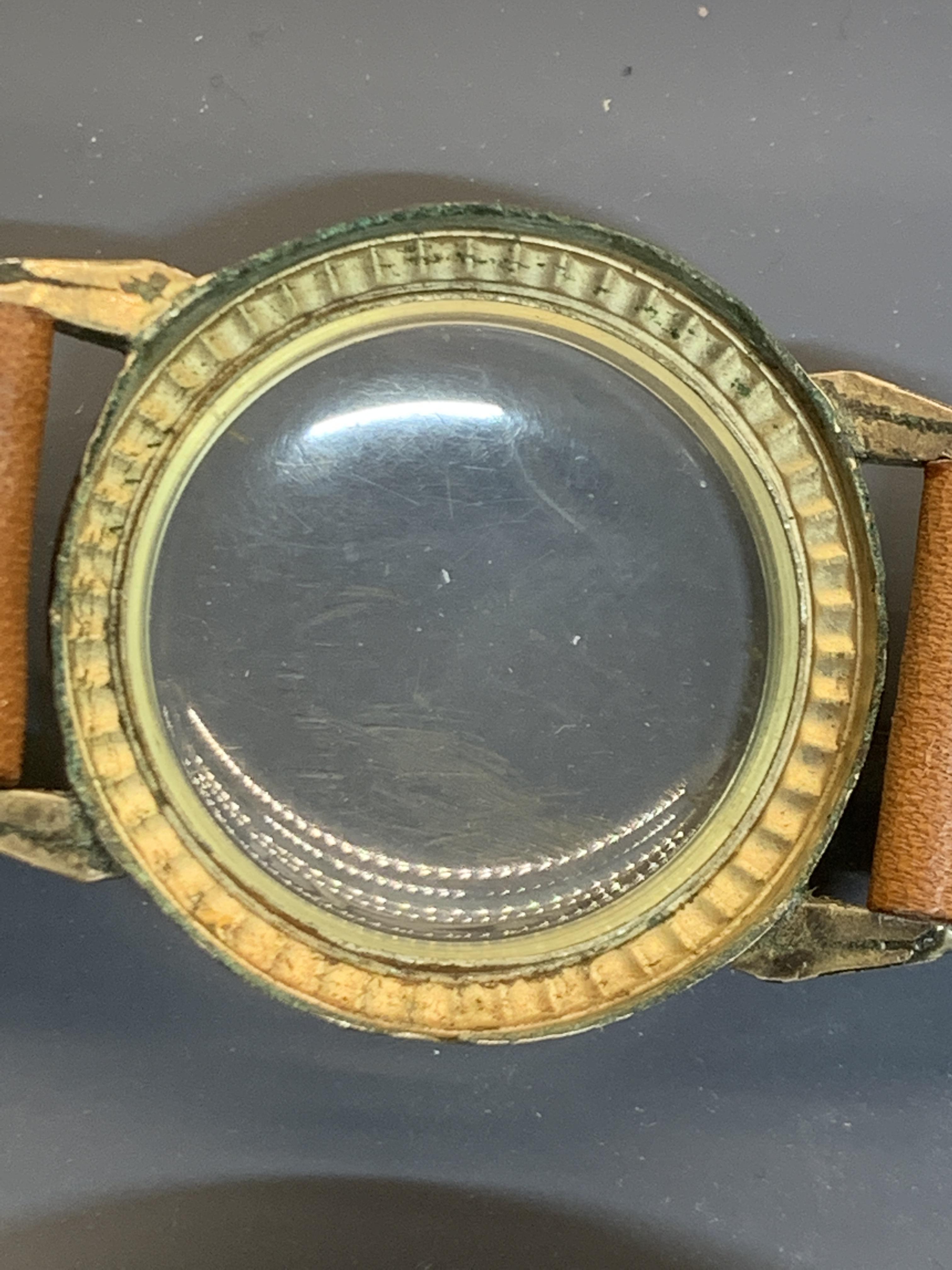

this isn't a factory model from Elgin. its a replacement case offered by jewelers for when the original case had too much wear.

Any ideas on finding cases for Elgins that have been stripped?
sorry for the delay,  no not much of a chance with your model as both the case and dial have been swapped out, so it would be pot luck as to watch model the movement originally came from.

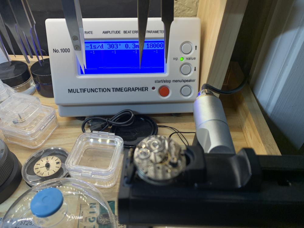

That took some time...Mainspring, the mainspring was definitely broken in two...and the 4/0 was a perfect fit...but during reassembly I noticed the plates didn't really want to go back together so I looked closer...and found a broken jewel.  I got to looking a bit more and found another...so I got another movement.  I realize its not worth the work...but I liked it so I wanted to bring it back.  I rebuilt the new movement which had a bad jewel that the old movement had in good shape...a little swaping and I was in business.  Got the entire thing back together and put it on the timegrapher and it was looking GREAT...until I put it upside down at which point it stopped.  Through a little investigation, I noticed that the balance cock jewel was cracked in 4 directions and was also oblong.  At this point, I became a bit frustrated and set it aside for a few months.
I had another jewel on the old movement...I was not comfortable changing it, so I hit pause...till today.  Today I finally took it out again, pulled the hairspring off of both assembles, pulled the jewels out, examined them and the old movement had a good jewel so I cleaned it, lubed it, and reassembled everything and threw it on the timegrapher!  It was pretty good right out the gate, I did have to speed it up just a smidge and I did check all directions.  Its not perfect...but it never was and never will be.  I am very happy with the results and threw it back in the case which looks pretty much exactly how it did above.

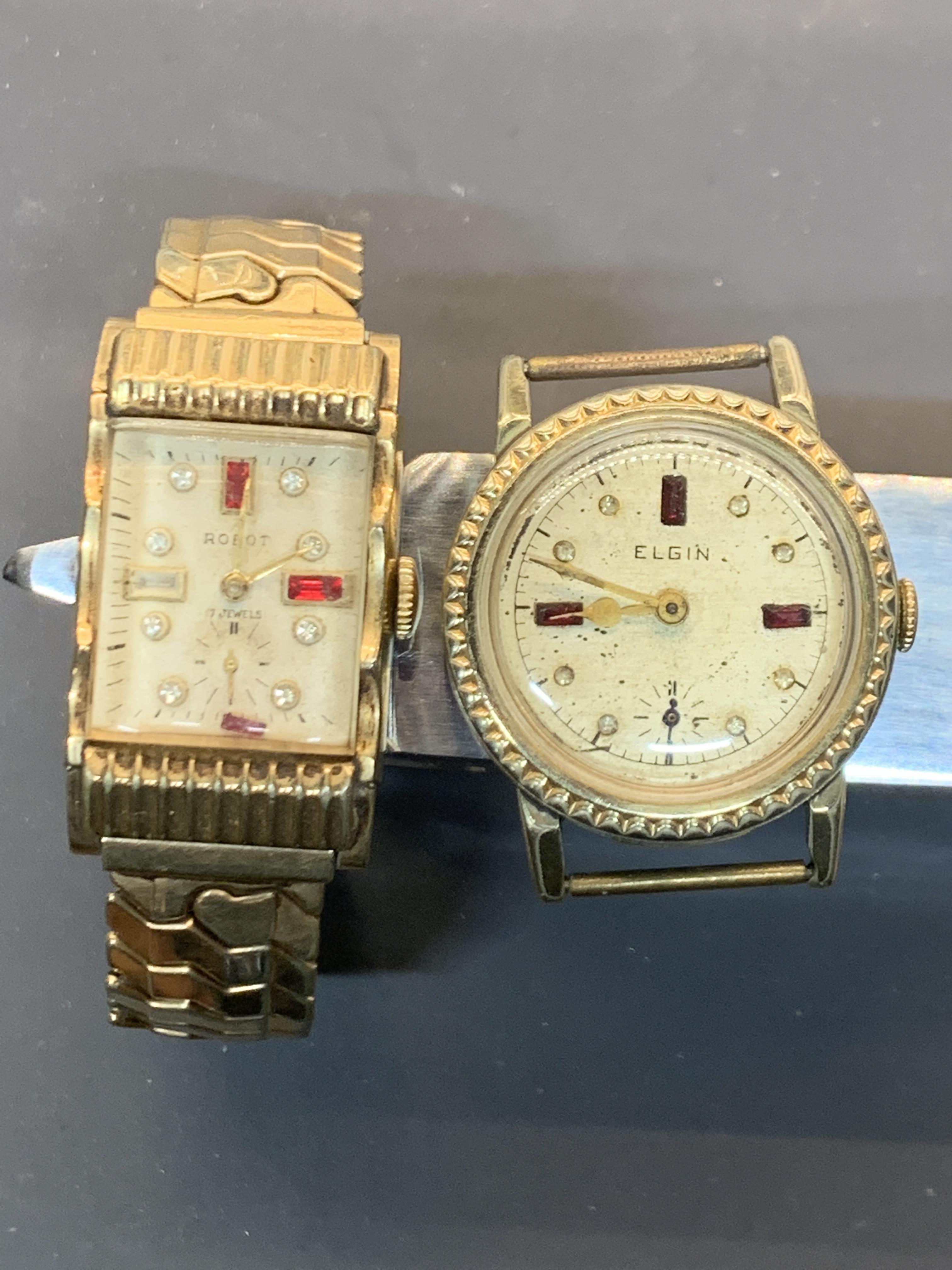

I have picked up another Elgin that looks like this one and a Robot that seems cut from the same thread!
The round watch movement is not as jeweled and does not work...probably the mainspring...seems like they are all broken.  The spare movement I bought for this project also had a broken mainspring.  I also messed with a Chinese 2650, a friends son had purchased a inexpensive pocket watch that stopped ticking.  It meant alot to him so I took a look.
The impulse jewel fell out!!  It was just gone, just a hole left...so I grabbed a balance off an $11 movement and got it ticking again.  He also had an Citizen Eco-Drive that the hands fell off of, easy fix there, and the band was falling apart.
