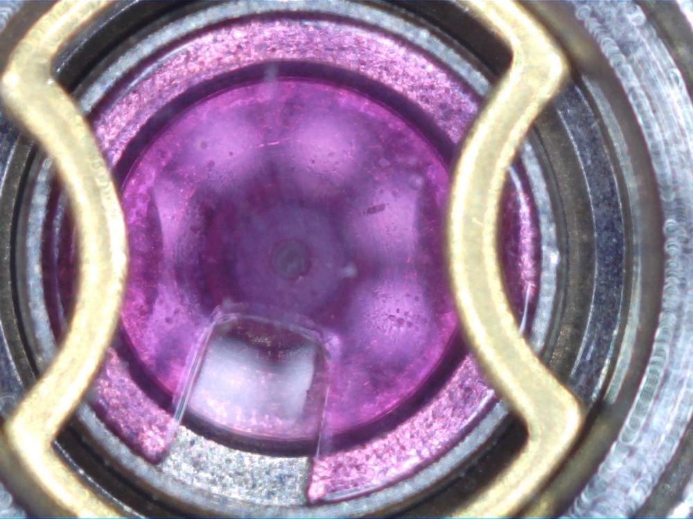

Where are slotted cap jewels used?
By FabioBastardo · Posted
Does anyone know what the watch movement is on this old watch. No name on the dial just the word waterproof where a name should be. Interesting logo see photos -
