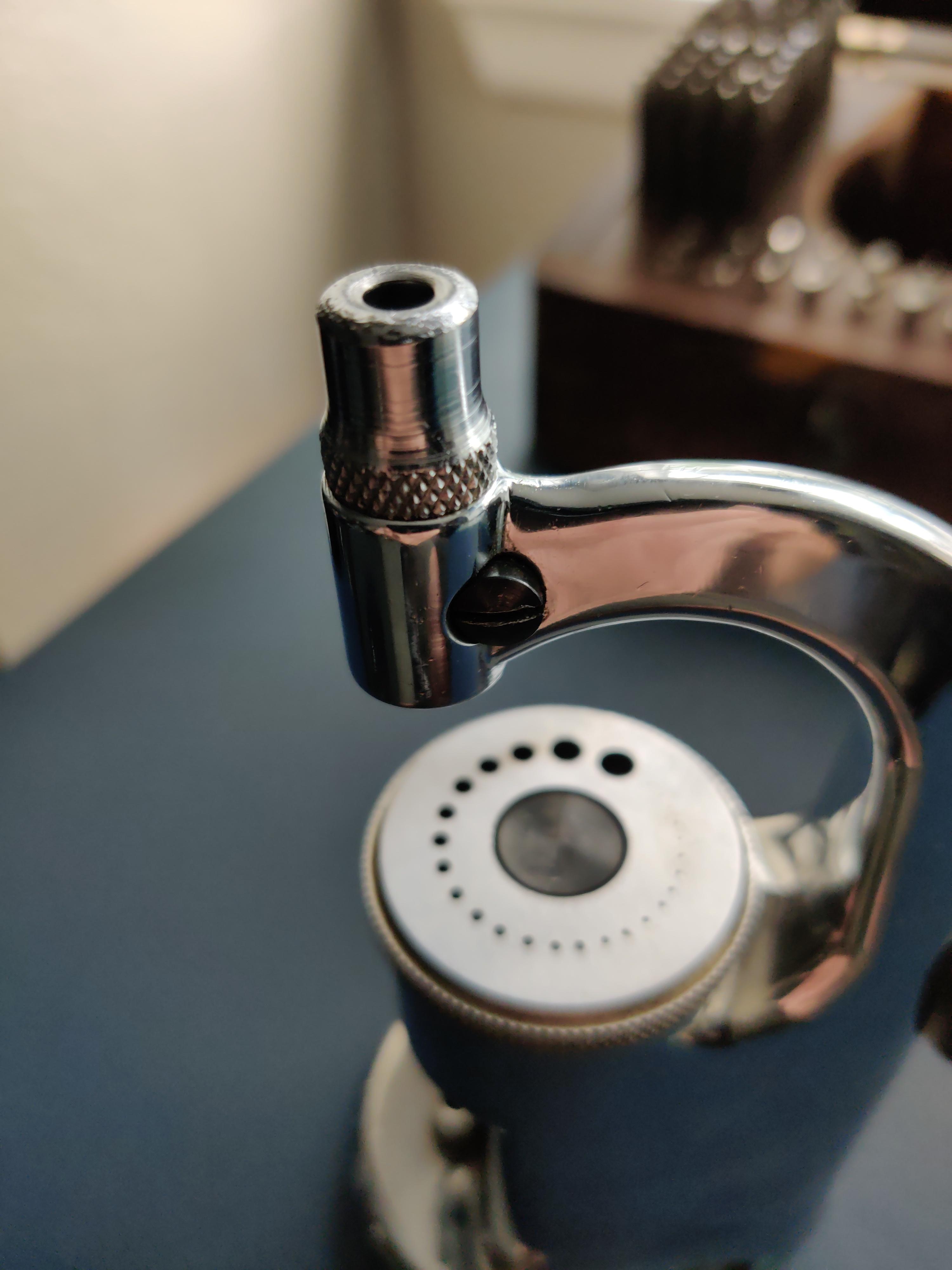

Hi all.  I have just received a similar K&D staking set in the post and wondered if the knurled knob on the top of the frame should move.  If it should, mine is very much stuck.  Just thought I would ask before I force things.   Cheers, John

Thanks for the comment LitttleWatchShop regarding the movement of the knurled knob and sleeve at the top of the frame.  Strange that it would be knurled like it was supposed to move. At the moment the stakes won't slide through easily, so a bit of cleaning of the rust pitting is on the cards.  Thanks again, John
On my Moseley staking set the knurled knob is for adjusting the sliding friction on the stake. It is locked in place by a screw. The idea is that you want the friction adjusted so that the stake will stay in place and not just fall down, but still be loose enough that it doesn't interfere with punching.
Thanks for the response. That's what I would have expected but the K&D has no locking screw.  At this stage I will clean it up and see what happens. It may just be a force fitted during production and not meant to move.  It works as is, so I won't try forcing things for fear of breaking it.  Thanks again, John
Ah interesting.I have this set too and only recently discovered that the top knob is eccentric. I was thinking it was for fine centering adjustment but if I can actually adjust friction that would be very helpful. My set is also missing the small black cylinder that receives the bottom end of inverted stakes and I have been looking at fabricating something to replace it but from photos that hole looks eccentric too.
I also wonder now if my set is in the wrong box. It isn't possible to close the lid if the top friction knob is installed in the frame. But if it's intended to be locked in place it would seem inconvenient to install, set, and screw lock every time you pull the staking frame out of its box.
The top knurled nuts on all of mine are eccentric and to adjust the stake centering with the anvil holes.

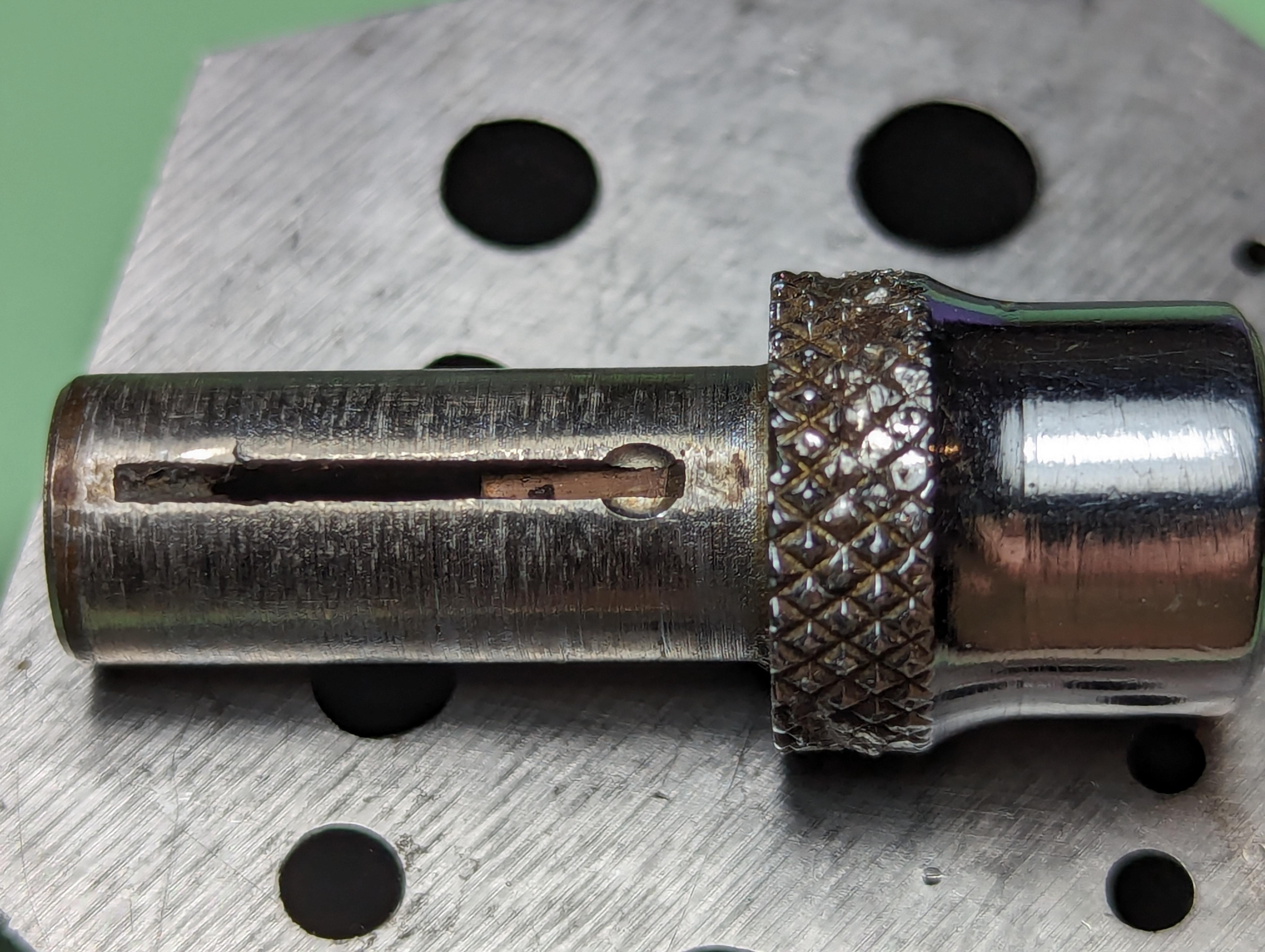

Hey @dadistic, long time, no chat! Following this thread, I realized that one of my staking sets looks exactly like yours, but unmarked. I decided to investigate.
When I remove the knurled inset, I find a vertical slot with a flat spring in it to provide some friction/pressure to hold the stake. On mine, the spring is held more or less in place with some mushy stuff--no idea what it could be. Like maybe some ancient Rodico.
A rather odd setup to me.
That still seems to be what mine is designed for. No position has any effect on friction. And it feels like overkill to be an eccentric adjustment since the anvil plate already has enough motion. It's one more thing to knock out of adjustment at the wrong time.
The nut is more of a fine tuning alignment that you don't quite get with the front to back movement of the anvil. When tightening the anvil it can want to pull itself central to the tapered head pin in the middle, though you do get a little front to back play, just not always enough if the frame isn't perfectly in lline or has had a knock. Not sure about the stake friction adjustment I haven't come across that before.
Well well. I looked closely at the nut and it looks like it had the thin interior friction spring @LittleWatchShop mentioned but the part is broken. So that's why I can't get more friction, but the thing is still an eccentric and is helpful especially to align with an inverted stake used as a stump.
Yup, that is the same as mine. Use a watch mainspring.  Find one the correct width and cut it to length!
