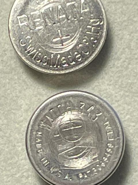

Thanks for the kind welcomes in the introductions forum!  Also for the advice, but now I must post what the problems are but no diagnosis and the causes.
I appreciated the information on what battery would replace the Watch Battery 343 which was on the last battery I had in the watch.  It would have been a mercury battery and those are no longer sold.
One kind soul suggested an AG 10 would work, and I went to Batteries Plus to pick one up.  They assured me a 389 RENATA is the equivalent and it's listed as a Silver Oxide 1.5 watch battery.  The dimensions were the same (diamter and thickness) as the 343.  I was excited to see if it would produce movement.  But it did not.  I also moved the hand with the stem but no movement happened.
I attached a photo of something I noticed about 25-30 years ago when I set the watch aside, which could be a clue.  There is a 3-pronged electrode inside the case, that sits almost flush to the inside atop what looks like gold colored mylar.  I suppose that's an insulator.  But, the electrode can swing side-to-side.  I moved it carefully to one side for the photo.  The 3-pronged electrode on the battery cover is mounted in the center.  It occurs to me that the electode inside the caseing could be the issue but I have no experience here.
I also took a photo closeup of the BENRUS case.  Two lines below the stamped name it is stamped "OPEN THRU CRYSTAL".
If that can slide easily side to side that's a problem. That your negative power contact That is supposed to go to the circuit board and should make a nice firm connection it shouldn't move.
Yes, it easily slides back and forth and when a battery goes in, I think as the case cover is screwed down, the negative power contact moves.  I suspected that was the issue because then when the cover is opened and the battery is removed the negative electrode has moved.  It also seems the negative electrode is more “flattened”, like there is no springiness to it.
Would you think it’s repairable by a newbie?  I suppose I need to disassemble and replace a component?
Thanks for looking and commenting!
mark

Hi mf60. It does look like the contact has broken away. Was the watch stored away along with its battery still inside. If so there is a good chance some leakage of the battery may have also occurred.
No I don't think leakage occurred because I noticed that looseness many years ago and I kept the old battery in case I could ever find an identical.  I had stored the watch and battery for many years.  It would be interesting to find out when those mercury batteries were banned.  I doubt that I knew that battery had contained mercury.  It's stiing here next to me on the desk as I type it, next to the new RENATA 389 Silver Oxide battery.  The old battery is a Union Carbide WATCH 343.
I had already tested the old battery with my old battery with my ZTS Pulse Load tester but I tested both again and the RENATA 389 came up to 100% on the tester but the Uion Carbide was dead.
AS I recall that contac was loose many years ago and perhaps that was the problem all along.  It was stored with the battery in it for a while, after I noticed the contact issue.  That was many moons ago.
