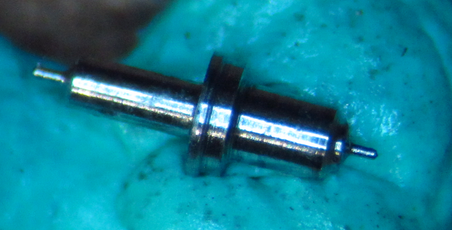

Well...it is about the journey, not the destination.  I show the progress here in this figure, but there is a problem.  The dimension for the balance beam hole specified did not work for my balance.  Probably been wallered out over the years of repairs.  Instead of 120, I get 133.  Discovered that AFTER the cut.
I can save it by going back to the pivot and working inward.
OK, here it is.  I dont think I gave enough of a depth on the HS side.  I can put it back in the lathe and improve it.  I did not do a single-pass mill.  Instead, I flipped it to do the roller side.  Never would have happened for me the other way.  I have pretty good Levin collets, so it remained quite true after the flip.
This has been extremely hard and took SO many hours.  I have great respect for you professionals who do this regularly!!

Cool. LWS it looks  good.  You've made a decent  looking bal. Staff. How many on  here can say that. Probably not many .
Well, when testing the staff in the watch, I discovered that one of the pivots was a little too big, so I had to chuck it up and turn it down a tad bit.
Now the balance is fully assembled and running in the watch.  Have not put it on the timer because I want to enjoy this victory before taking any hits for erratic behavior.
As noted earlier, the roller is not in great shape. I tweaked it as best I could.  If there is an issue, I will blame it on the roller and not my staff!!!
