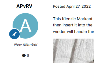

For instance when I come to the message board I click on the unread content. Go down the list and see what's interesting. But as you're relatively new here everything that you've never looked that will be considered unread new content even if it's vintage. I circled something in the image below may be clicking on that will help so you only see the newest stuff.
Occasionally I run in the something like this where I'll see something of interest click on it and end up in the middle of a very long discussion. Because of someone replies to a multipage discussion and there at the end the message board will not take me to the end but it will take me to wherever I last was reading on that multipage discussion. So yes odd quirks the message board.
Then discussions like this are interesting and basically a waste of time to purchase a paid in because look at the original posting person? Only did six messages and was last here in 2022. Often times with newbies variety reasons they don't get whatever they want and they don't stay very long. That means trying to help newbies out can be a waste of time if they're not going to stay.
