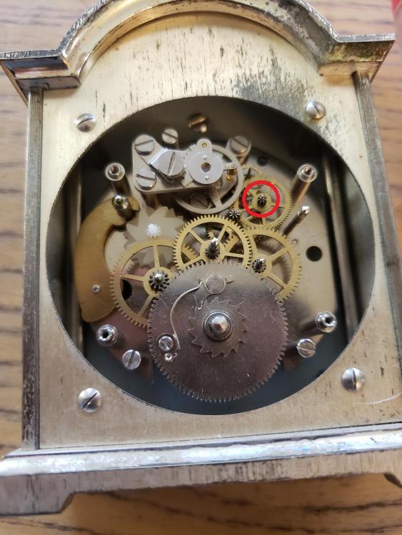

I picked up this cute clock (see pic) for $1 at a yard sale and have made it a personal project to try to get it working again. Professional repair is not currently in my budget and I am enjoying trying to do it myself, but could use some information/advice please.

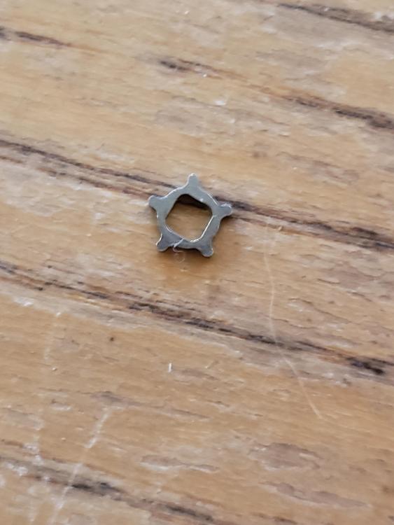

Originally the knobs turned to set the time and alarm, but the wind-up key was stuck and the alarm only made a slight click. I removed the back and found a loose screw - once returned to its place the key turns again, but still won't power the clock. I then removed the 2 top plates and found 3 loose cogs. When the cogs were removed the alarm began working. I returned 2 cogs to their place, now the wind-up key spins the hands then rapidly spins back and stops, and the alarm is back to just a slight click. The 3rd cog (see pic) is still removed as I am unsure of its proper placement. If anyone can help me find a manual or diagram, or advise me on repairs, I would be deeply appreciative.

The 2 cogs with blue dots are the ones I found loose and put back. When they were removed completely the alarm worked, but alarm went back to just a slight click when it tries to engage as soon as I put the cogs back.

Ok, do you know where it should be? That is where I found them floating when I opened it, and it slightly engages the small cog at the top (to the right of the timing screw assembly), but doesn't fit quite right. The alarm also forces the minute hand forward about 5 mins when it tries to engage, but engages and rings fine if that cog and the one below it are completely removed.

Don‘t know, but you can follow this logic: The pinion on the escape wheel should mesh with the so called „fourth wheel“ which again has a pinion that should mesh with the third wheel. The third wheel has a pinion that meshes with the center wheel on which the minute hand is positioned. The center wheel should have a pinion that meshes with the teeths of the main spring barrel.
The wheels that have not been in place should be the fourth and third wheel.

Well first off I would advise you to listen to OH, but also I would remove the movement from the case to carry out any work,  it will make lining up the pivots a lot easier. If you don’t there’s a strong possibility that you will snap a pivot when putting the plate back on.
