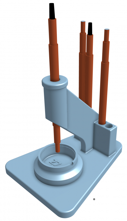

I bought my son-in-law a 3D printer for Christmas, never having even seen one myself. He went on vacation and left it with me to play with for a week. I'm an old machine designer so I have no problem with designing things using 3D CAD software. I had seen someone else's idea for this and I didn't like their design, which used way too much plastic in my opinion and was too bulky.
It took me a couple of hours to design it and 8 hours to print it. I had to chase the holes with a 1/4" drill bit afterward. It works the same for my Bergeon and Horotec pressers.
I already have numerous things I want to do to change the design, but at 8 hours per copy, I don't think I'll make many more than this one. Let me know if you would like the STL so you can print your own.

Will do, but I need to make some changes to the design. I accidentally made the storage holes all the way through the part! Dumb ass. I was thinking of rounding the corners a bit as well. This one also has a boss on center that I planned on using with a movement holder with a matching hole, but that might be problematic with other movement holders that have a flat bottom, so I probably will remove that boss for a model that will be published on Thingi.
Ok, I made changes to the design and I started printing it. It will take all day to print it on my slow machine.
What I didn't mention before is another issue with the previous design. The bottom of the trunnion had a mess of plastic that I had to clean off. This is because there was no bridge to that surface and the printer couldn't get a clean surface. I still need to learn more about 3D printing. You must design shapes that can build on a surface from below or close by from below, so if you want a piece that overhangs, it should probably have some draft. This new design has that and I've cleaned up some things. The holes are made a little bigger in hopes that I won't have to chase them with a drill bit and the storage holes are blind now. This picture shows an assembly with one of my movement holders. I put a 40mm spotface in the base so my movement holders will stay put, but that recess should be large enough for most other movement holders not to interfere.
The dumb thing is that I don't change hands that often like modders do. I spend most of my time overhauling movements and restoring cases and crystals. Putting hands on a watch takes me about 5 minutes out of several hours of other work. But, I will say that I have had to re-do hand installs because I didn't press on right. This tool should help me do it better and more efficiently.

Thank you! The Horotec and Bergeon pushers that I have are close enough in diameter that they both work fine with a 1/4" hole. I don't think it's critical that the hole be a perfect fit anyway. We just need a guide that mostly holds the tool straight. Even if the hole was sloppy, one could bear down on one side of it to keep vertical.
I was thinking of a design that used a V-groove and spring loaded clamp instead and that could use any diameter pusher.
But your suggestion of printing my own pushers has really got my head spinning and makes me think I could just make my own complete device with my own tips and everything. I could make a turret style unit like the fat city Bergeon one! Maybe I'll think about that some more.

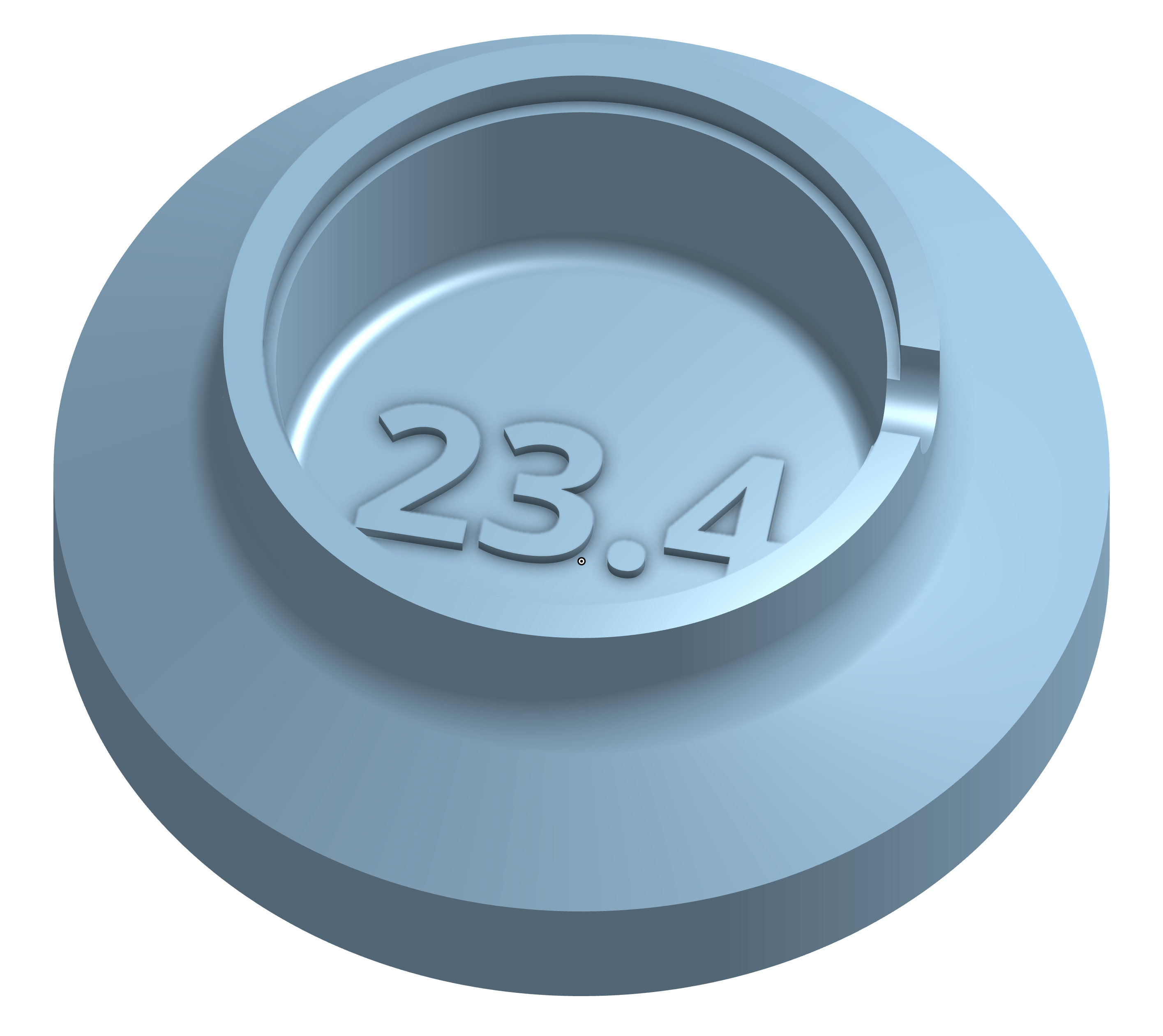

I made up a quick model, using my standard design as a basis. Getting the fit just right can take some trial and error and this one has a clearance that has worked on other Seiko movements. The 4205 is a ladies size caliber with a 23.4mm casing diameter so a fair amount smaller than I'm used to. Try this out and let me know if it needs tweaking. Here is a link to the STL file on my Google Drive: LINK

Wonderful thank you very much! I'll dust off the printer tomorrow and give it a go. Yes that 4205 is tiny and a pain to clamp in my 4040 type movement holder.

Hi Saldog, so I had a quick look and the 4205 mainplate itself is 17.52 mm. In a ladies watch it would come with a spacer ring that is 23'ish mm, but with the divers I'm using it for there's no spacer ring around the movement, it attaches to the dial with a plastic disk spacer sandwitched in between. I've tried using OnShape as you've done (I've even found the model you've made) but I've go no clue how to drive OnShape lol
Ok, I had the spec sheet from Seiko on that movement and I grabbed the wrong casing diameter. There are two sizes for that one and I picked the larger one. I saved another file. Give this one a try: link

Holy crap, that was quick!!!! Thank you thank you! I've seen VTA's holder but I honestly prefer your design because of the large base. Seems like it'll be much more stable with your design
Edit: Forum somehow merges threads and it's driving me bananas
You, sir, are an absolute legend!! It all fits nice and snug. Brilliant!

Just an update on the hand presser model. I actually used it for the first time last night on a Seiko 6117-6410 Navigator Timer watch. It worked perfectly.
My problem is that I wear magnifier glasses that warp my vision so it is hard to see if I am holding the presser perfectly straight. I want to correct for what I think is not vertical and I end up pressing the hand on crooked, either angled up or down but not level. This machine is strange because when I'm using it, my brain thinks I'm pressing the hand on wrong, again because of my glasses. But when I look at it after pressing it on, I'll be damned if it isn't on perfectly! When I trusted the tool, it became more natural. I didn't know how much I needed this tool until just now. I think I can't live without it now.
Maybe I'll work on a tool that has the pressers built-in. Getting the action right will be key as 3D printed parts usually don't slide well. I might have to make a hybrid using an easily-acquired metal part (scratching head and looking into the sky now). Maybe also an easily-acquired bushing so the action is silky-smooth. Need to do a deep dive on the tip designs needed and come up with a turret-style design that has all of the sizes needed locked and loaded. Sounds like fun to work on!
