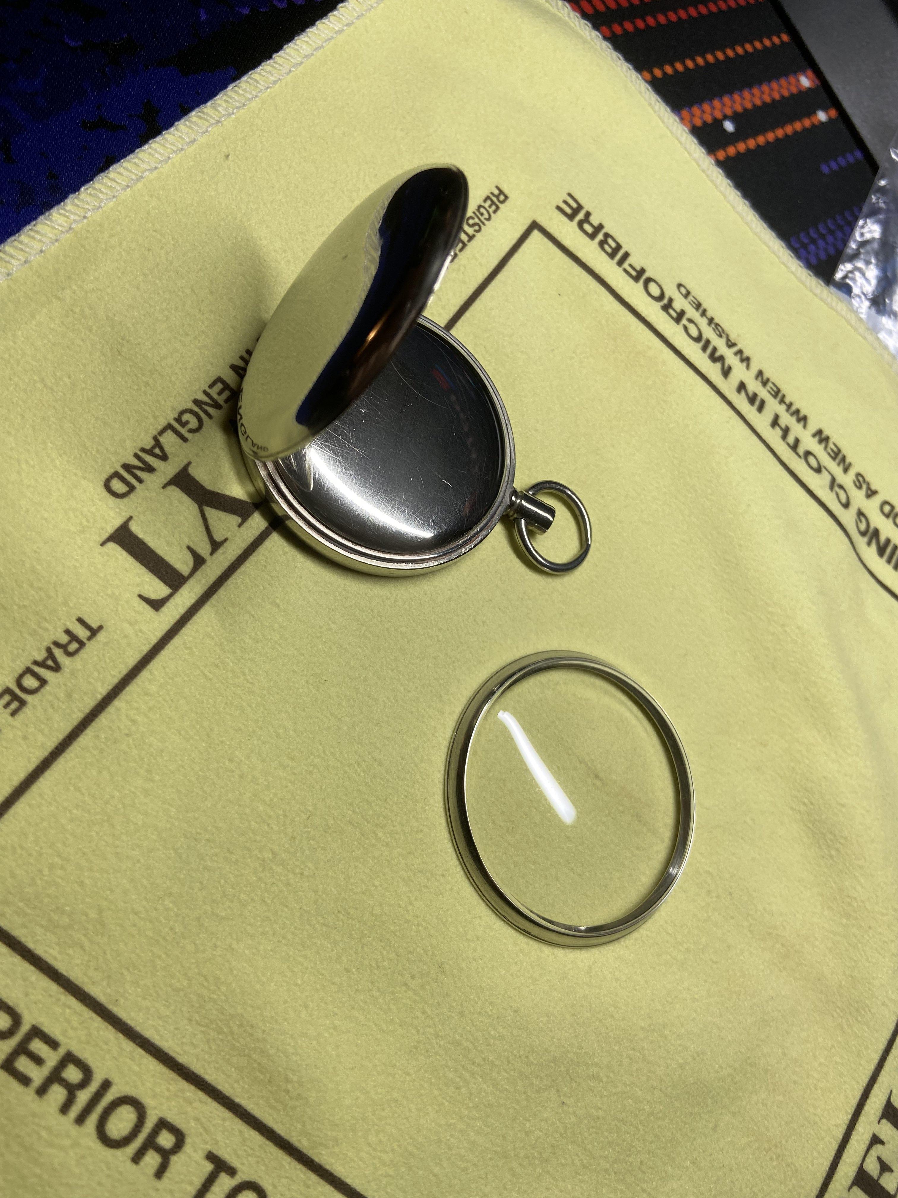

I even polished up the case today, fitted a new crystal and cleaned up the dial in anticpation of full assembly today! How naive of me... 😂
Before:
After:
