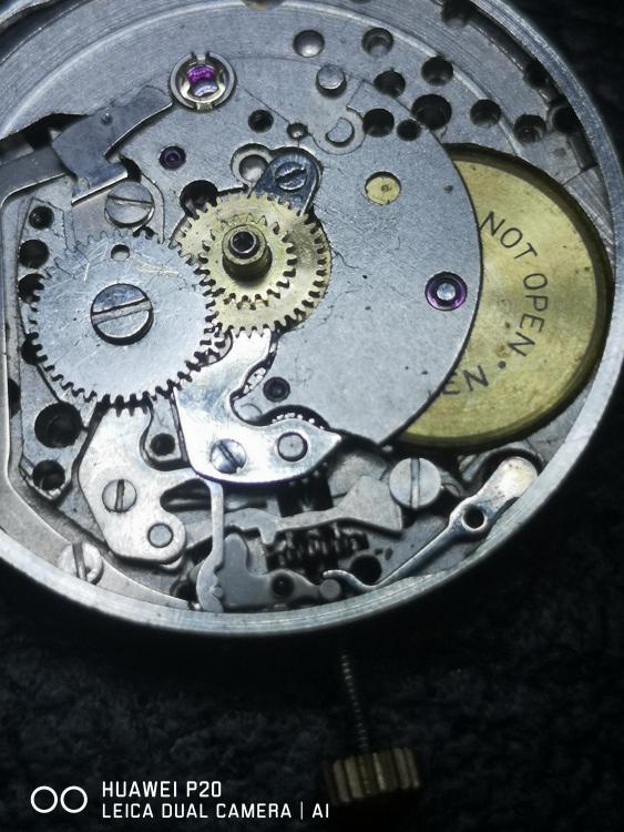

Last part now on this zodiac 88. The keyless parts seem to be a bit amiss, If i wind it up as it stands nothing happens. To make it wind up i have to press the crown and stem in and hold it in and turn.This will wind it up a bit but its very hit and miss. If i return to normal position nothing happens when i turn it. If i pull the crown and stem out it turns the hands which it should do.
Have i done something wrong with the keyless setup???
cheers
gary

probably a worn winding pinion or the winding wheel. Also check if the hole where the stem goes in the movement is worn as this will affect the handwinding.
Anilv
It looks like it's together right. Make sure everything is well lubricated, there's a lot going on in this system. You might find that just oiling the sliding pinion where it fits on the stem helps. Otherwise it could be like Anliv says, a worn sliding and/or winding pinion.
