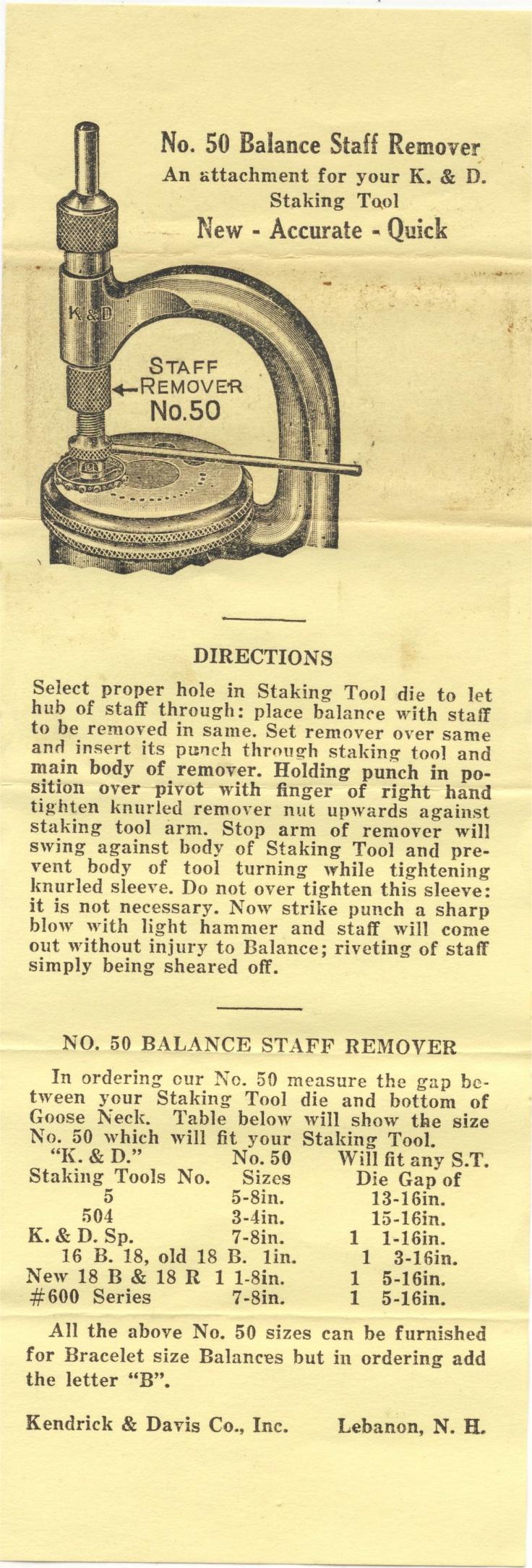

21 hours ago, clockboy said:
You will need a staking set/tool to fit a new balance staff. You will also have to have a way of removing the old staff without causing damage to the balance. The traditional way was to cut away part of the staff using watchmakers lathe. There are other tools such as a Platax tool which are no longer manufactured so a used one would need to be found.
no matter what you need a really decent staking set.
then watch repair there are opinions on how to do things. Conceivably everyone was trained differently exposed to different tools and things people at different knowledge of things. People have different perceptions of things.
Now you will note in the quoted section above removing the balance staff. The reference to using the lathe the cutaway part of the staff. This would be either cutting away the ribbons are weakening the rivet C can drive the staff out. I was actually taught that in school. Others will cut the hub off on the backside. Doesn't really matter which method you use as long as you don't destroy the balance wheel in the process.
What about knocking the staff out the video indicates that's very bad but is it?. notice the reference to the Platax tool this is a very nice tool but astronomically expensive if you ever confined one and it does exactly that it knocks the staff out. I also have an image of a tool that does basically similar stuff. Well at least as far as knocking the staff out the other tool will allow you to remove the roller etc. ill have to have an accessory for your staking sep to do that or another tool. Yes this is also watch repair you will never have enough tools
as far as knocking out staffs safely goes there variety of factors in play. Several of the American companies made staffs specifically designed to be knocked out.  Elginium and was very proud of their later version the balance wheel made out of a very hard material that you could knock the staff out because the arms would withstand that. Rolex even has a staff that can't be knocked out a test he pressed out with a special school as there's no other way to do it. If you are knocking a staff out the rule is you just gently tap the staff doesn't quite come out then you most definitely have to cut something if somebody got really carried away with the riveting it's not going to knock out even if was supposed to knock out.
So basically end up with lots of variations lots of opinions lots of methods and some are very bad or can be bad and some can work very well.
