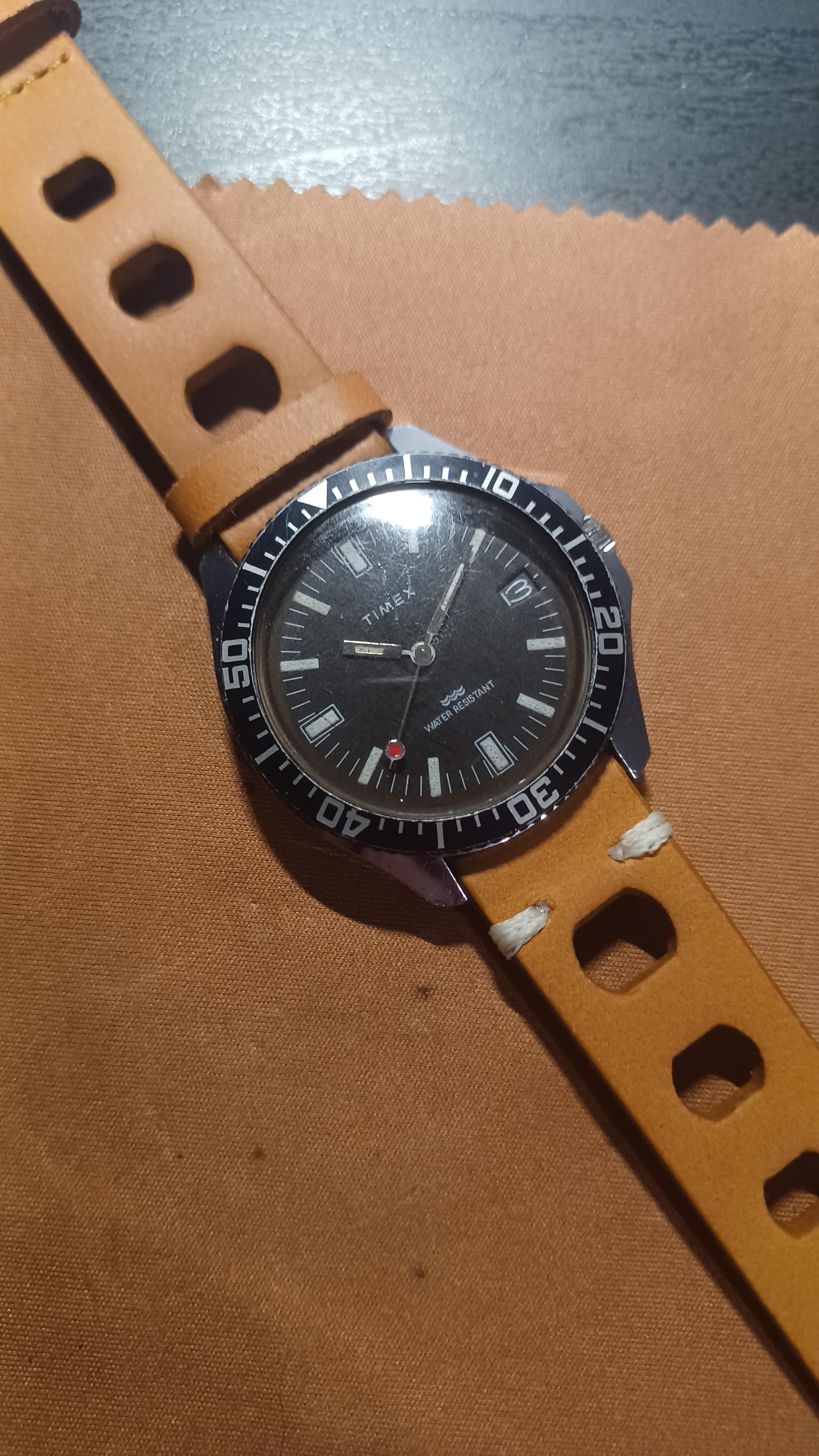

As mentioned I the title, I recently acquired my first project watch, a 1980s Timex Red Dot Skindiver (I think that's what it's called) with a Timex M25 manual movement. The only problem is that I cannot get it out of the case! The case seems to be blocking the movement from getting out in the back, so I believe the only way to get it out is to remove the crystal and coax it out through the front of the case. I don't care about preserving the crystal, as it is too far gone for me to repair, so I am wondering if I need to get a crystal remover or if I can remove the crystal with other tools without hurting the dial. Or perhaps I am being blind and there is merely a screw that needs to be loosened?
Any help would be appreciated, thank you!
Hello Lotus,  Welcome to the WRT forum.  I'm not very familiar with vintage Timex watches however I found this YT video that may help you with that model.  I'm sure there are many others who will chime in to help you if this video doesn't answer your questions.   Best of luck to you on your journey into this hobby.
Red Dot Diver is a nickname and this is actually a Marlin.  Based on the hands I'd say it was second generation and from 1984.  Yes, you will need to lift the bezel and the crystal to remove the movement.  I don't see anything wrong with the crystal that a good buff and polish won't fix.  What is wrong with the movement?   BTW - you know one diver leads to another...like this 🙂   The diver upper right was the latest addition.
I think something might be wrong with the keyless works or motion works, sometimes the hour hand will not turn with the minute hand when setting the time and I cannot change the date at all. Other than that, the train wheels and balance are all fine and working properly.
Also, thank you so much for the advice!
I'll take a guess and say that something broke off on the date frame.  This is causing the issue.

On 6/7/2022 at 03:51, Lotus said:
Come accennato nel titolo, ho recentemente acquistato il mio primo orologio da progetto, un Timex Red Dot Skindiver degli anni '80 (penso sia così che si chiami) con un movimento manuale Timex M25. L'unico problema è che non riesco a toglierlo dalla custodia! La cassa sembra impedire al movimento di uscire nella parte posteriore, quindi credo che l'unico modo per farlo uscire sia rimuovere il cristallo e convincerlo a uscire dalla parte anteriore della cassa. Non mi interessa preservare il cristallo, poiché è troppo lontano per essere riparato, quindi mi chiedo se devo procurarmi un dispositivo di rimozione del cristallo o se posso rimuovere il cristallo con altri strumenti senza danneggiare il quadrante. O forse sono cieco e c'è solo una vite che deve essere allentata?
Qualsiasi aiuto sarebbe apprezzato, grazie!
A mio modestissimo parere, devi prima estrarre la Tige, e poi si libera il movimento, dalle foto non capisco se ci sono delle viti che lo bloccano, ma sicuramente se prima non estrai la tige, non esce, fidati.
Il movimento esce dalla parte anteriore della cassa dell'orologio. Quindi il cristallo deve essere sollevato. Google Traduttore
Per quel poco che ho potuto vedere nella foto postata con fondello aperto, secondo me la tige va estratta.....
si, togli lo stelo. Il prossimo è sollevare il cristallo.
