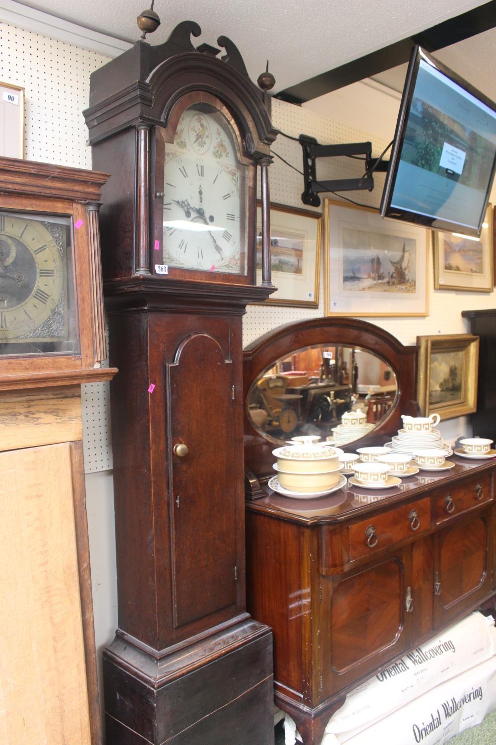

Longcase clock by Moore of Warrington with painted dial 30 Hour with swan neck pediment
