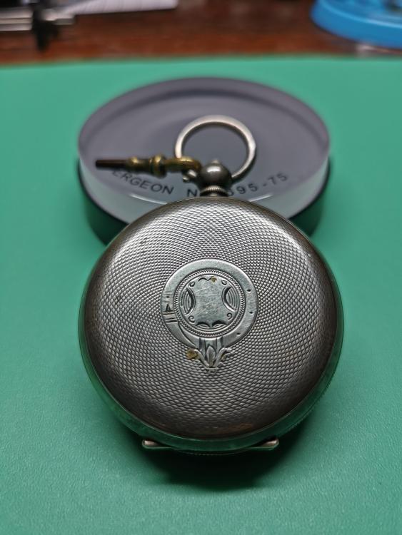

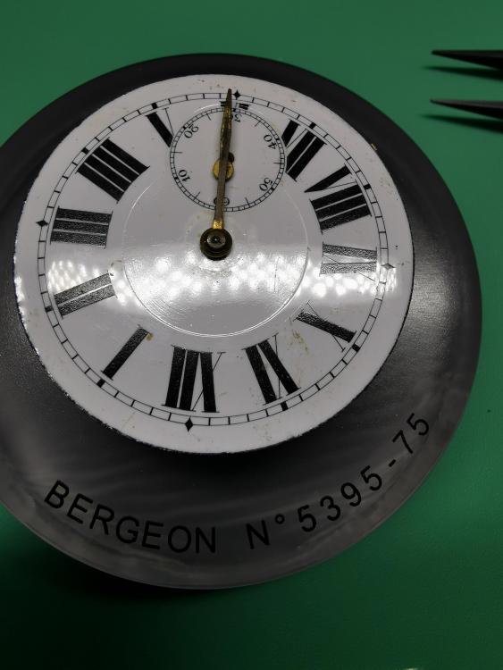

Hey guys,
Having successfully disassembled my first pocket watch, I am struggling to identify the movement.. The only markings i can see are a "144552" stamped on the bottom plate and also the case, and a "40" stamped just on the bottom plate and a "50" on the top plate..
Google hasn't turned up many leads off the back of this info, so i'm a little stumped as it stands as to how to identify this movement..
Pictures attached.
Thanks in advance,
Adam.

From what I see I would say its one of those movements where you have a square at the back for setting the hands the square is part of a long pin that goes through the center wheel and is friction tight with the cannon pinion pressed on. It doesn't have the normal keyless work. More then likely it is Swiss or French many of these movements were made on or near the border of both countries.
when the world moved away from semi hand made watches cottage industry watches and mass production started the Swiss/French flooded the markets with watches like this. The only reason the serial number is there for inventory control purposes there are no spare parts for this watch for instance.

Knowing the manufacturer of the watch will help. Post a picture of the dial and case.
See below.
Yes you're spot on - key-winding and adjustment via two square arbors on the back.
Cannon pinion was a PITA to remove (the movement as a whole is really gunked up with old oil and about 100 years of dust and crap), ended up having to use my staking tool to knock the center pin out the back of the movement - after which i was able to remove the cannon pinion easily.

Other than being very dirty, everything looks intact. Balance staff isn't broken etc. Although most of the crystals are cracked of partly missing, so i was hoping to get replacements for those and so wanted to know the movement in order to know which sizes i'd need..

You ought to be able to measure the size of the hole in the plate and the size of the pivot hole in the jewel and then order replacement jewels from a supplier like: https://www.ofrei.com/page939.html or Cousins since you're in the UK https://www.cousinsuk.com/category/jewels-pallet-endstone-jewel-holes
Of course, you'll need to be able to knock the broken ones out and carefully insert the new ones and adjust the depth to achieve the correct amount of end shake. This wouldn't be what I would suggest as your first watch repair project.

These may not be friction fit jewels. Early pocket watches often had jewels that were burnished into the plate. A small lip was left that after a jewel was set in, which was burnished over the edge of the jewel to hold it in place.
