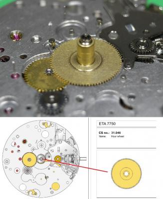

ETA 7750 Service Walkthrough
The 7750 was first available in 1974, having been one of the first movements to be designed with the aid of a computer.  It's hard to believe that the 7750 is still the industry standard movement for chronographs considering it's history.
It was developed over 40 years ago by Valjoux, who was then a legendary movement maker that was part of the giant ASUAG conglomerate.  But by the end of 1975 production was stopped due to the onslaught of the Quartz Era, and the 7750, along with many other mechanical calibers, was abandoned.  Industry demand for this movement was so low that the stock produced in that 1 year manufacturing lasted until 1982!  Such was the devastation of cheap Japanese produced quartz watches to Swiss manufactures.
History may have forgotten the 7750 except for the local management at Zenith who ignored the orders by Valjoux to destroy the dies and equipment used to manufacture the 7750, instead hiding the equipment away from corporate eyes.
You can find many more fascinating facts about this caliber online, and it's well worth the read.
This walkthrough will be very detailed, and I hope this will give people the courage to tackle this movement.  I've serviced quite a few calibers, and this is one of the most beautiful, with a very logical layout.

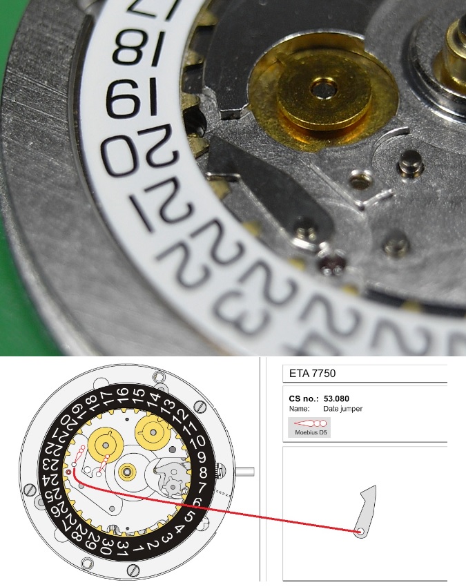

Next remove the jumpers for the day and date.
The jumpers differ from one another, so here is a reference photo so you can see the difference.

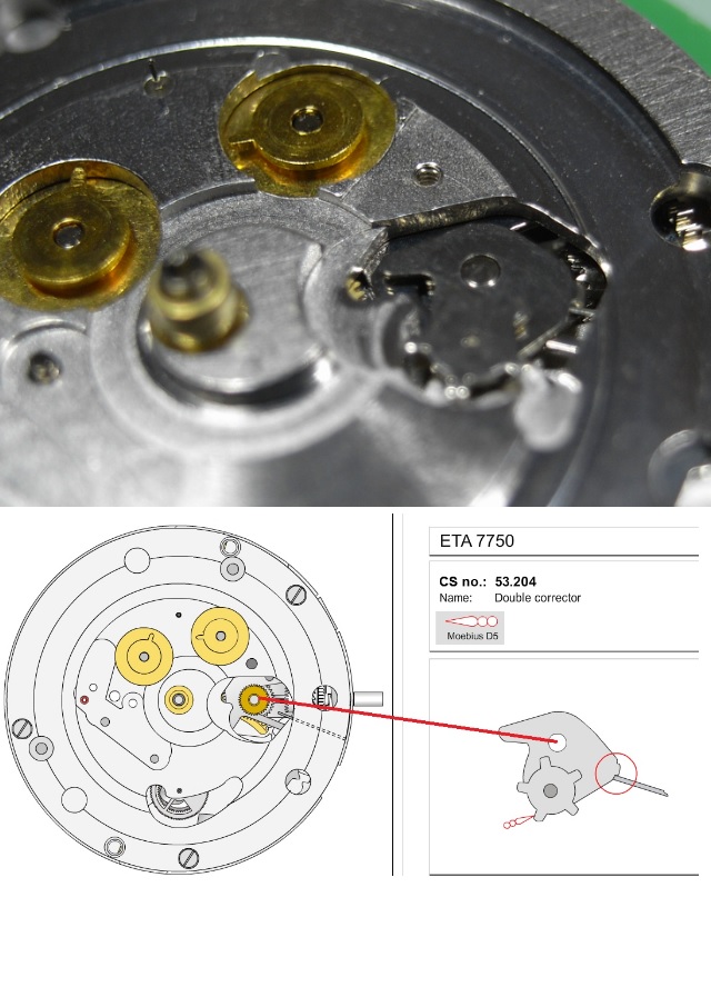

The last piece to remove on the Date Platform is the Double Corrector

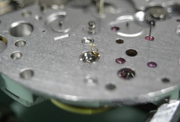

Be careful when removing this plate, as there is a fine spring pressed into the plate that can be easily damaged.

Remove the Hour Wheel

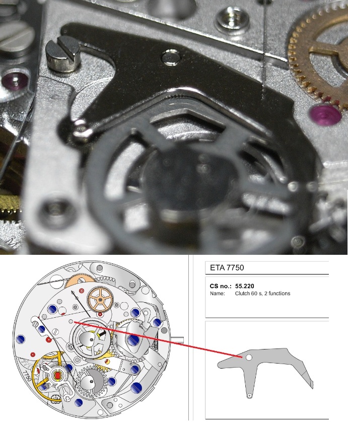

Next remove the Clutch 60s, 2 Functions.

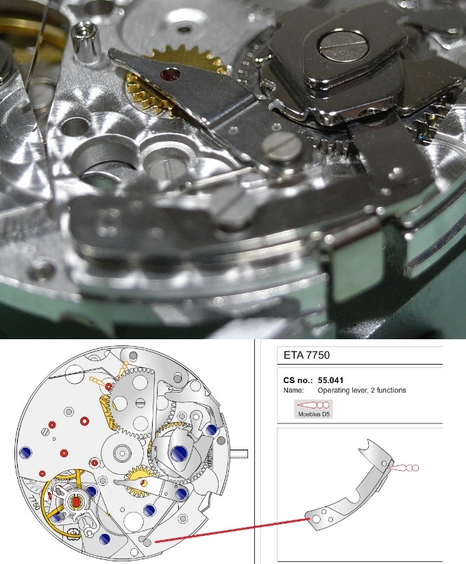

Unscrew (1.4 Driver) the Operating Lever, 2 Functions.

Slide out the Operating Lever Spring, 2 Functions.
This spring can be fitting in both directions; but only 1 way is correct.
Here is a reference photo of it's correct orientation.

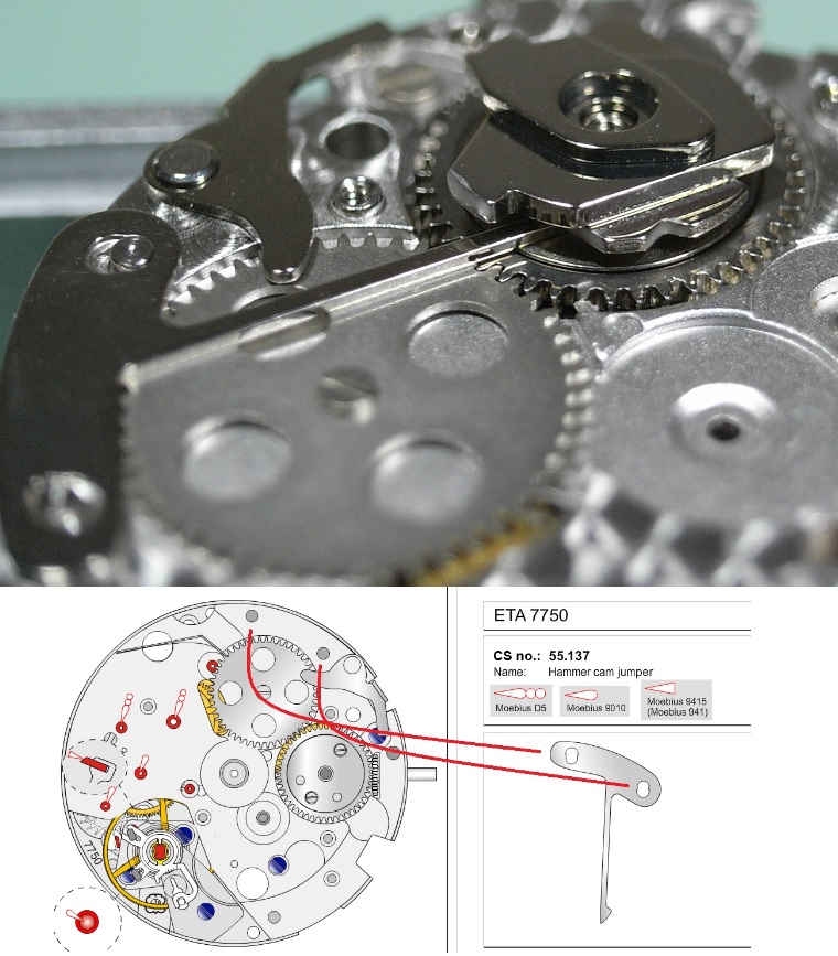

They show to remove the Chronograph Cam before removing the Hammer Cam Jumper.
This in my opinion is not the best way, as all the force from the jumper is pressing on the cam whilst your trying to remove it, and could lead to damage.
Instead I move the Chronograph Cam until it reaches the notch as shown in the photo below.
Then lift the Hammer Cam Jumper up to the top of the Chronograph Cam, which will release it's tension.
Then, just as you removed the previous hammer, rotate the jumper to the opening in the slots, which will free the spring.
Now you can unscrew (1.4 Driver) and remove the Chronograph Cam safely without tension on it.

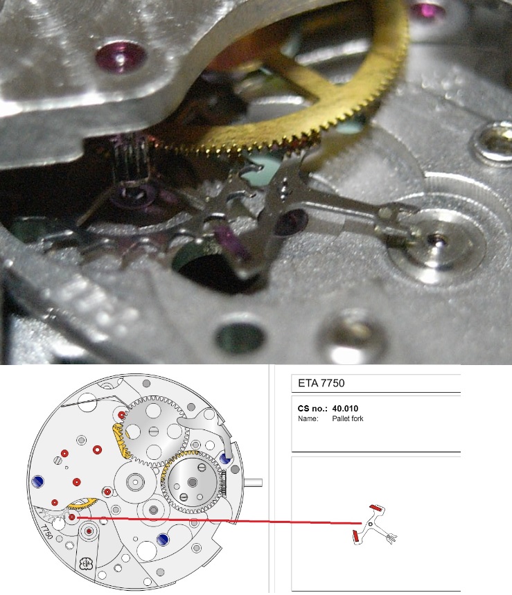

Then unscrew (1.4 Driver) the Pallet Bridge and remove the bridge and Pallets.

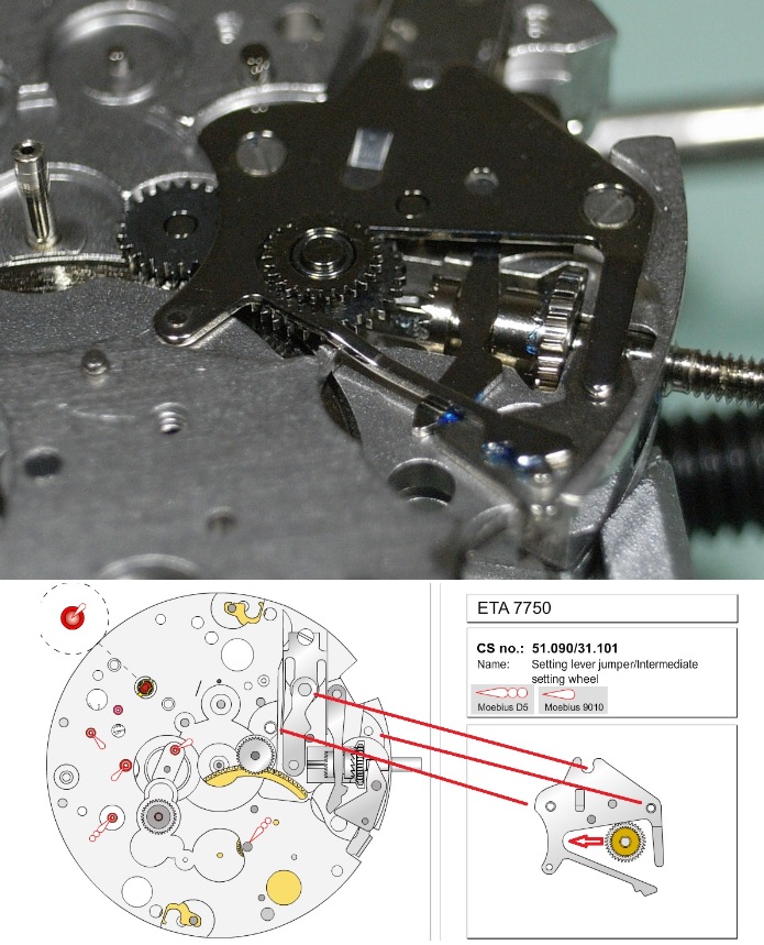

Firstly, release the tension from the Setting Lever Jumper.
Then unscrew (1.2 Driver) and remove the Setting Lever Jumper.
These are unique screws with pointed ends, and below is a reference photo of them.
This will also remove the Intermediate Setting Wheel.

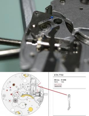

Then remove the Yoke.
Remove the Setting Lever.

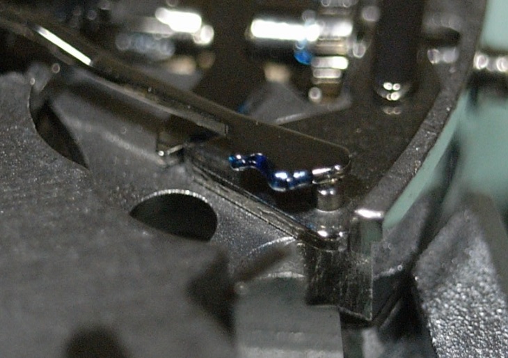

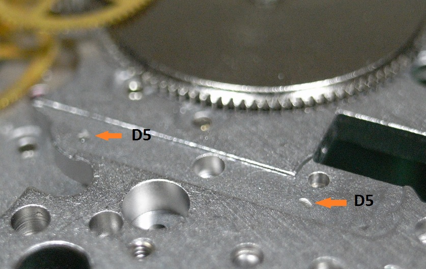

Place 2 small spots of D5 as shown, so the Stop Lever will have a smooth action.
Install the Stop Lever.

Before installing the Rocking Bar, lubricate the points on the spring.
Install the Rocking Bar.
Install the Setting Lever
Install the Yoke.

Construct the Setting Lever Jumper with the Intermediate Wheel
As noted above, the screws for the Setting Lever Jumper are the ones with the pointy threaded ends.
Be sure to lubricate position points on the setting bar before you lever it into place.
Install the Setting Lever Jumper / Intermediate Setting Wheel.

Once the movement is turned over install the Pallet Fork.
Then install the Pallet Bridge.

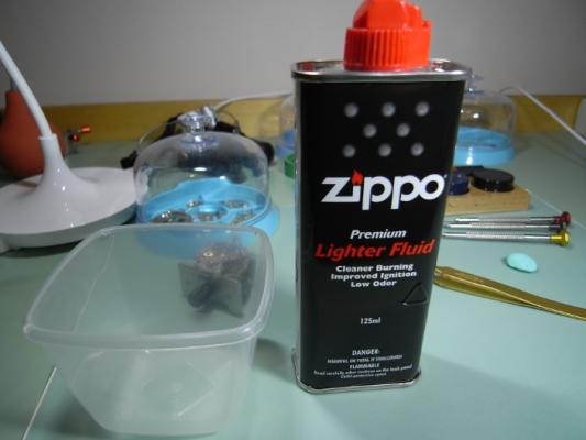

Cleaning them carefully by soaking in a container with Lighter Fluid ... I use Zippo Fluid.
Once clean, dry the Balance and Incabloc Jewel and place a drop of 9010 on the Jewel as shown below.
Make sure it covers at least 1/3 to 1/2 of the jewel, without the oil touching the sides of the jewel.

Next to be installed is the Hammer Cam Jumper. Here is my method for installation.
Place the Hammer Cam Jumper into position, turning it clockwise to lock it into the slots.
Then place the Chronograph Cam on it's post, so that it rests on top of the cam jumper ... as shown below.
Then while holding the arm of the cam jumper back, seat the Chronograph Cam into position and affix the screw (1.4 Driver)

Before installing the next item, which is the Operating Lever, 2 Functions, be sure to lubricate the hinging point from underneath with D5.
Then install the Operating Lever, 2 Functions.
Be sure that the spring arm of the Lock is out from under the Operating Lever and screw down (1.4 Driver).
Place D5 into the little slot opening in the top of the hinge point.

Before placing the Chronograph Bridge onto the movement, you need to oil the jewel circled in the image below with D5
After oiling that jewel install the Chronograph Bridge.

Install the Clutch 60s, 2 Functions.
The Clutch needs to slip underneath a small click spring for the Reversing Wheel, so be careful not to bend and damage this spring.
Then gently lift the arm of the Clutch over the Oscillating Pinion.
Yes, it's a delicate job, but with a steady hand, patience and well dressed tweezers, it's not too hard.

One other troublesome operation for people is installing the Clutch Spring.
This is my method of installation.
Slide the long arm of the spring into it's position until the shorter end is touching the automatic bridge.
Then with your tweezers grab the point illustrated below and lift it over the locating screw.
Once over the screw, push it forward and until the loop is seated on the locating screw.

Install the Hour Wheel

Install the Date Indicator Driving Wheel.
This time you line up the wheel's driving tooth with the post for the Intermediate Calendar Driving Wheel.
Failure to do this will result in improper synchronization of the day and date.

Install the Double Corrector, making sure the spring is correctly positioned.

Install the Date Jumper.
Be sure you have selected the correct jumper, as the Day and Date Jumper are not Identical.
