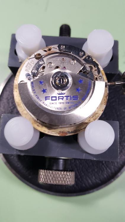

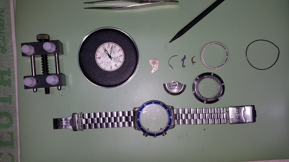

I am by no means a Certified or Professional Horologist.  But I have had a passion for Time from the age of 8.  I have broken and rebuilt many timepieces but this was an ABSOLUTE life saver!!  I was able to use the tutorial, highlights and parts catalog to rebuild a FORTIS B42 Chronograph and bring it back into action.  Thank you for the excellent job and assistance.
Attached are some of my progress photos
