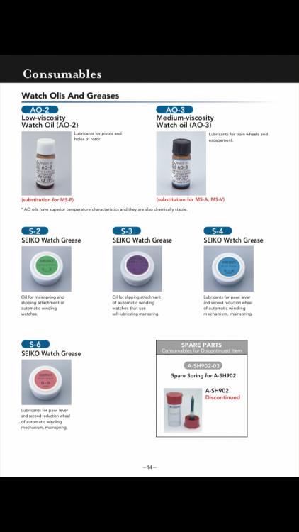

Looking at the Seiko documentation for the 6r15/nh3x/7s26 etc, I see that Seiko basically uses one oil - Citizen AO-3A and one grease - Seiko S6, to lubricate those movements. They also use Seiko S4 grease but for just one part - the first reduction wheel.
Reading the various threads, it appears that those working on Seiko movements however just use the Moebius 9010/9104/9415/9504 combination with 8141/8217 for mainsprings.
A question: does anyone here actually use the Seiko oils? How do they compare to the Euro alternatives?
Also, what braking grease does Seiko use in their 6r/nh/7s barrels - S3 or S2?
Seiko doesn't mention any Citizen product. You may have read about "A oil", that's Moebius 9010.
Thanks.
The 6R15C/D says “AO-3(Moebius-A)” which I had assumed was Citizen AO-3A (sold by CousinsUK).
With the discontinuation of the 6R15, I purchased a complete NE15 movement and a 6R mainspring barrel for future servicing of my Sarb 033 and 035. Doubt I will ever need to replace the mainsprings but good to have spare parts for the future. I also have a NH36 put aside as a parts donor. You can probably tell I am fond of my Sarbs.
Probably that means either one, but didn’t wanted to mention Citizen explicitely.

7 hours ago, JohnFrum said:
From the 2011 and 2021 Seiko Watch Repairing Tools catalogs:
I don't suppose the catalogs are PDFs where can we get a catalog?
Then there's a problem with catalogs or even tech sheets for that matter. Like for instance the Rolex tech sheet specifies Rolex lubricants. The problem is Rolex doesn't sell those lubricants which means you can never service a Rolex watch because you'll never get the lubricants. The same as the Seiko watches nice catalog but can we order the lubricants out of the catalog?
That means typically people come to the discussion group like this and ask what can I use instead and then people make recommendations of what can be purchased and what does work versus whatever is specified by the manufacturer that none of us will ever probably get. Although sometimes the Seiko and even citizen lubricants are available out there but they're hard to find.
Then there's a problem with catalogs or even tech sheets for that matter. Like Although sometimes the Seiko and even citizen lubricants are available out there but they're hard to find.
PDFs attached
Esslinger in the USA and Cousins in the UK currently have the Seiko S4 and S6.
Cousins also has the S3 and the Citizen AO2.
A number of Japanese online sellers offer the Citizen AO3 as well as the other lubricants
It does not appear that S2 is still being manufactured by Seiko. It does not feature in the 2021 catalog and online sellers don’t list it.
seikotoolcatalog2021.pdfseikotoolcatalog2011.pdf
As regards use of S4 and S6 greases on pivots, the following advice is noted:
Lubricating the pivots of train wheel
Before assembling the wheels, apply S-4 to the bottom surface of the hole jewel.
Set the wheel by inserting its pivot in the lubricated hole jewel.
Note: No effect can be expected by lubricating the hole jewel from the upper portion after assembling the wheel.
