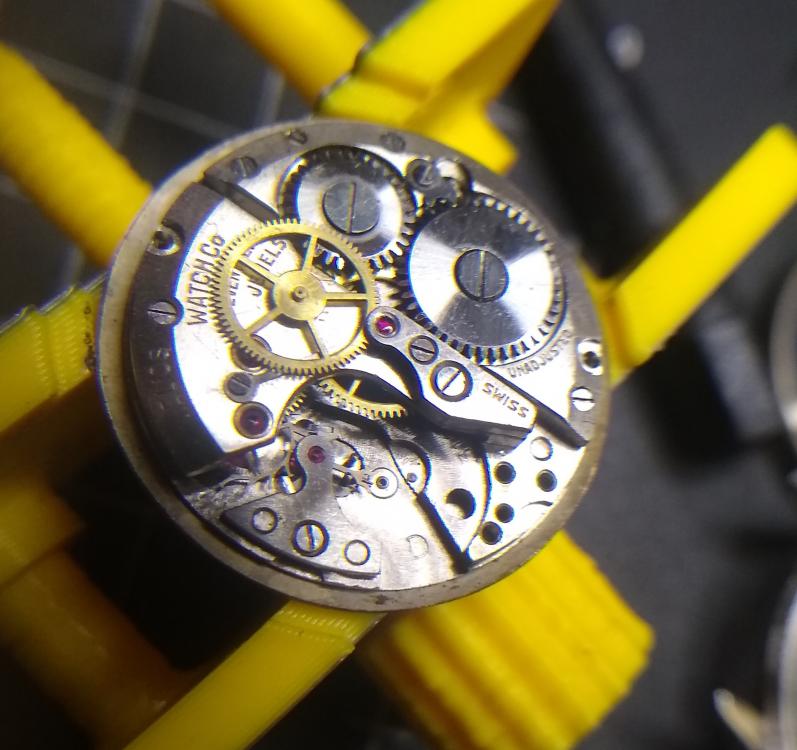

It has "Helios" stamped, on the left side of picture. Then it has "WATCH CO" with "SEVENTEEN JEWELS". The marking under the balance cock is the letter "D" and it has "315" just above it under where you see "SWISS".
Closest I can find is Bifora caliber 934 or Dugena 704, going by the little top plate.  10 1/2 size
