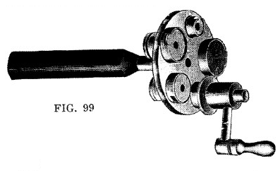

Could the above tool, which appears in CSOW, be inexpensively re-created?  Have you ever seen one in real life?

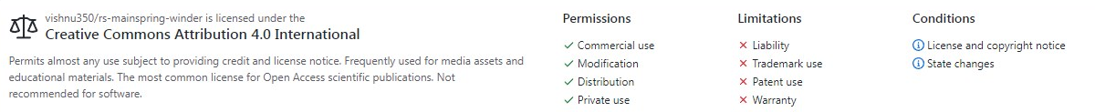

This one appears to be be open-source:
Have you any opinion on it?  Seems to me you would need
Eyup G. I have two slightly more modern versions of this tool. Neither of them rarely fit. You are relying on only five options of sizes. Often the size differences are either too big or too small. I also have a fully adjustable winder that has a limited minimum size. Its a bit of a faff to use and really only fits pocket watches.  The coned example you have ringed is an extreme and tbf i do think that hand winding is getting a bit of a bad rap here. There are good and bad ways to approach the technique. Obviously a bad technique will give a poor result adversely a good technique will yield a good result. This is my opinion Obviously from my experiences but until it has been thoroughly tried and trialled by any individual it honestly should not be discounted. As always do what works for you but dont be affraid to try something different 🙂

Watchie swears by this tool, in fact he sleeps with it under his pillow 😴  lol. ( nothing wierd i suspect but then again knowing watchie who knows 😉 ). Bloody hard to find one anyway , I've tried many times over.
I’ve got my eye out for them as well NEW. I think it took one of the two guy’s who have them several years of searching, hence the thought of making them.

the only thing I have found for master craft is a US boatbuilder, I wouldn’t know where to start on a patent search.
Tom

I will list some pros of using the 3D printed RS winder:
  • Its free. Do whatever you want with the design files, make it suit your needs.
  • You can get a good 3D printer under 200GBP (Eg. Kingroon K3PS). And it is an objectively better purchase to a hobbyist/tinkerer. See purchase advice megathread on Reddit : https://www.reddit.com/r/3Dprinting
  • Plastic will never scratch steel, at least in general.
  • Its considered disposable.
  • You can just print the sizes you care about and not care about the rest.
  • There is a learning curve to using it, but once mastered it is a joy to use and will not fail on you. Practicing is important.
Cons of using should be obvious. If it isn't, please read it here:
https://github.com/vishnu350/rs-mainspring-winder#warnings-and-advice
