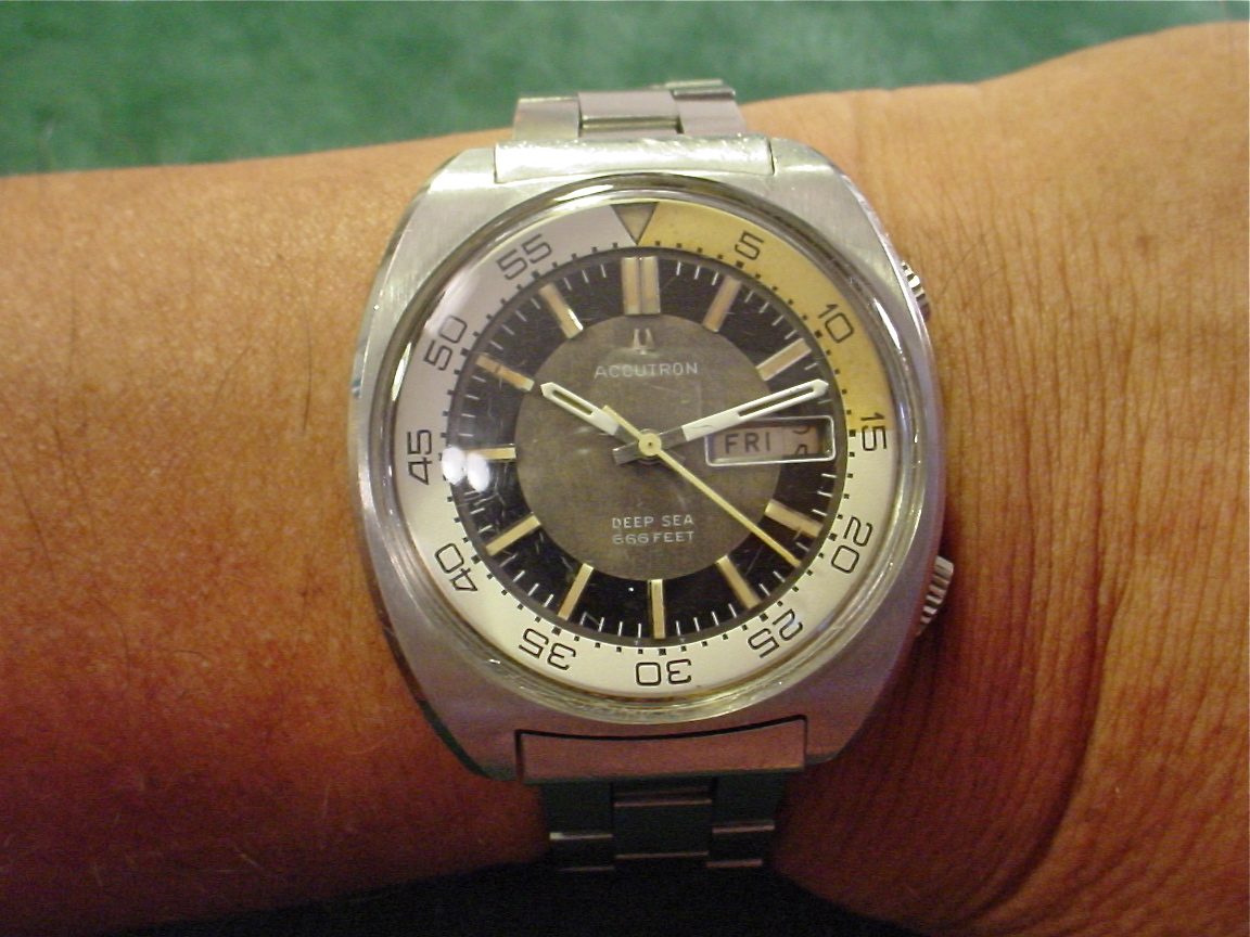

Hi , I picked up this Bulova Accutron 2182 Deep Sea 666 ft. at the swap meet today . It was not running and I discovered it did not have a battery . That's the good news .
  Both stems and crowns were frozen in position . The 2 hr  stem has a gear that rotates the inner bezel and there is some rust preventing rotation . The 4 hr position stem was stuck in the setting lever and freed up for removal on loosening the setting lever screw .
 I want to take the crystal out but am not sure how to approach this . I don't know if it is acrylic or glass , and if I should press or knock it out using my nylon press dies , or if I should use a crystal lift for this .
 Any help is appreciated .
  This watch is the same as the models that say "Snorkel" on the dial . Mine says "Deep Sea ".
The picture I'm attaching is from the internet , but mine is similar .
Thanks , Louis

Do you think the glass is high enough for you to try your crystal lift? If so try it but don't force it. If there is a tension ring you don't want to damage it. Why not try removing the back and approach it that way. You won't know how the movement is until you take a look. If the movement comes out you could use your fingers and pop it out.
Thanks for the reply guys . I do have the movement out and have tried to budge the crystal with my thumbs with no luck .The crystal is high enough to use a crystal lift and I don't think I would damage it ... At this time,  I Think it's glass and will wait to see if anyone else has experience with this or similar watches . I'll keep trying to dig up some more Info . I'm concerned about the crystal gasket in this 1970 era diver and I have never worked on or sourced parts for a Bulova .

  One small step at a time , so I will try to figure out how to take out the crystal first .
Well ,... " No Guts , No Glory ".......Can always come back and bite you .  But in the case of removing my crystal , that I felt was glass , I popped it out with a holder and a nylon case press die . To my surprise it's acrylic with a tension ring....quite beefy for this diver .  The best part of all that is the crystal has no scratches . Just a very itsy-bitsy bit of haze that will polish out quite nicely . Poly-glass would even do it but I use a diamond paste in oil compound . Another plus is that the internal rotating bezel is made of brass with all of the gear teeth intact ,...the same for the gear the turns it . So the case parts are going into my ultra-sonic for a spa treatment and now I can concentrate on the movement . I've ordered the battery for this accutron which originally called for a 218 battery , but has now been replaced by a 344 battery .

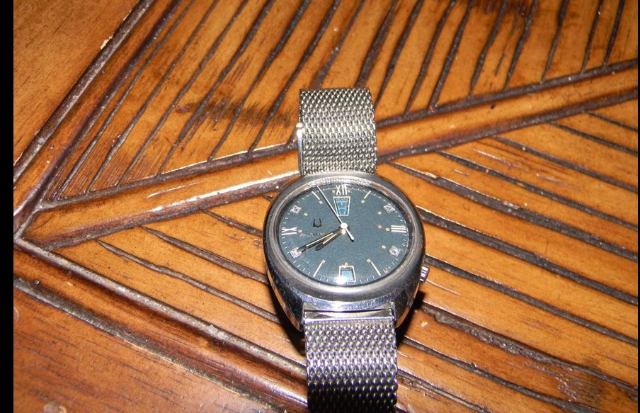

 By the Way , I picked up a clean Bulova Accutron 2182 at auction this morning .

Thank You Alaskamick and TheFixer . I Picked up this watch and bracelet at the swap meet for $50 not running and found several problems with it  . I picked up 2 movements on the bay ....both complete including dial and hands and of those 1 works . I'm in the process of making a wearer out of it .
  In the meantime I got the tech sheets and opened up the original movement and I DO agree with Alaskamick that accutrons are not something I want to spend my time on . I have worked on other electrics and electronic watches but I think I'll stick to the mechanicals .

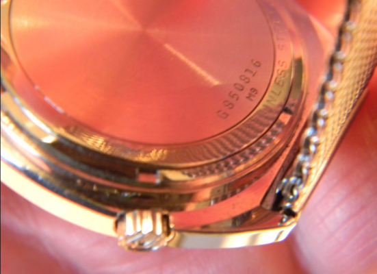

As much as I hate to admit it ,....I got the fever and picked up this working Accutron. As I was searching Accutrons lately . since my swap-meet find  , I was surprised how these watches seem to hold there value ,...working or not .
After saying all that , I'm through with Accutron purchases .....Honest .

Well the good news is that I finally got my swap-meet Bulova Accutron 2182 Deep Sea watch working and keeping good time .  The other good news is that Man , did I learn a lot about Accutron movements using my original broken movement , 2 donor movements ,....1 working and 1 spare for another project to get it working , 2 pdf tech manuals...1 downloaded from some watch forum and 1 purchased on Ebay and downloaded , and Youtube videos .
  After getting the stem off and removing the movement I was able to press out the hefty acrylic crystal . The inner rotating brass bezel came out easily and cleaned up well . The crown and gear that turned the bezel was frozen in place with crud and a little rust . I kept it covered with penetrating oil for a few days with no results . Then I used some paste made of Alum and hot water for about 12 hours...I kept adding drops of hot water every few hours as the paste started to dry out . After putting the movement in my ultra sonic cleaner after the Alum , the gear and crown started to wiggle a bit . Next I soaked the gear in vinegar for about 12 hours and the gear and crown finally started to turn freely .
 I next installed the working donor movement , but either the crown and stem would not stay in , or the calendar would not work correctly . The coils on the tuning fork are magnetized and every tiny screw and spring would be drawn to the coils . If a part pinged off , especially the springs for the calendar indents ,....check the coils and 50% of the time they would be stuck there . I decided to put the project to rest for about a week and started to study the tech manuals I downloaded ,
 I finally took the project watch out again and very meticulously lubed and installed the setting mechanism and calendar works using the tech manual as my guide . installed the movement into the case with the crystal and rotating bezel , and  BINGO , it all came together....at last .
