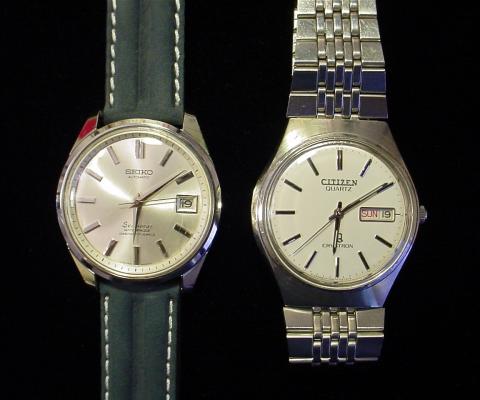

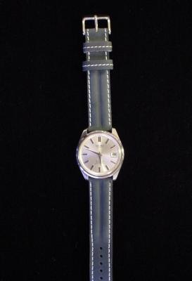

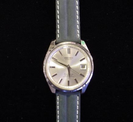

I had a chance this weekend to work on the Seiko 7625 Sea Horse and Citizen Crystron I got last weekend at the collectors show here in Honolulu .
The Seiko had a loose screw wedged in the balance that had stopped movement in it . The condition I bought it in . Fortunately there was no damage to the rather pristine movement . I disassembled it , did a clean in the ultra-sonic , and lubed the movement . I did a light buff on the case , bezel , and case back to remove small scratches . Then I did a light polish on those parts and the crystal...which has a small crack . I was able to source a new seiko crystal on the bay and that's on the way .
  After reassembly , I installed a new blue-ish leather watchband that has been waiting for the right watch .
  On the Citizen , I was able to source a new battery cell and it took off running...I like that .  Next I put the case parts into the ultra-sonic along with a Citizen CQ Stainless Steel bracelet I had for a while waiting for a Citizen with that signature on the dial . I then did a polish on the case and bracelet and reassembled the watch .
 I think that they came out looking and running pretty good ...........  Aloha , Louis
