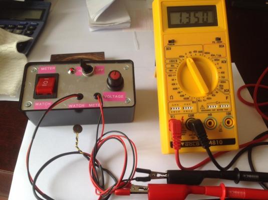

Hello Louis,
The instructions are usually in the PDF Service Manuals.  I have the same sort of meter but found that It needed to use a power supply as described on the iinet link.  It is quite simple and runs off a 9V battery and is used in conjunction with a voltage meter.
The meter you have also uses the movement holders that come with it but I can't see them in the pic you posted.
The iinet link also has instructions on the use of the meter you have bought, you will find some of the features are now redundant in modern terms but it is still of value.  I recommend you soak yourself in the info off that link as many questions are answered along with instructions on phasing.  I found it of tremendous value.

You need to go through this site with a fine tooth comb because there is a wealth of info there for the taking including the circuit diagram for the power supply I made.

  FYI , I received the Accutron 700 test meter and the movement holder with the jack in it...neat . The power supply you built that's connected to your meter is for what ? To supply power for testing instead of using a button cell ?
