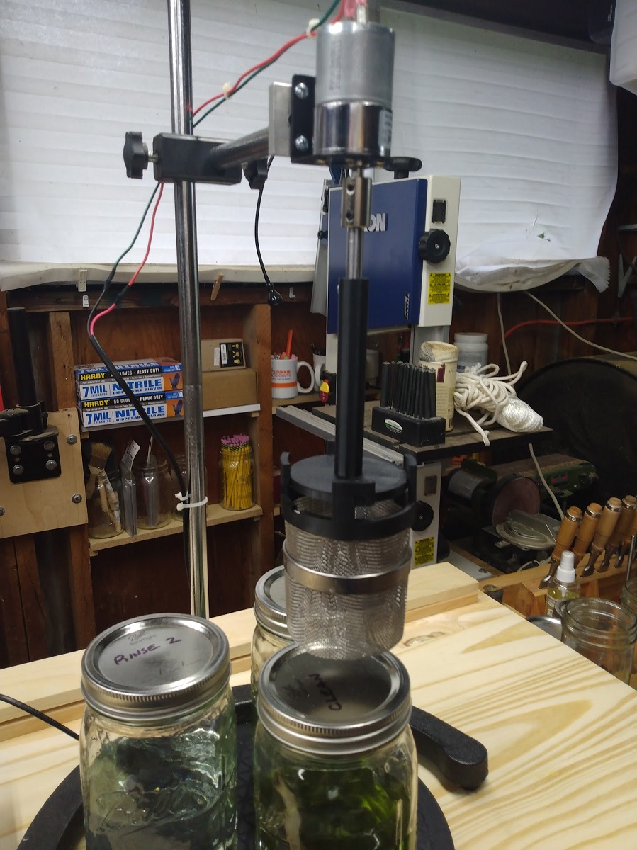

Hi all - here are some photos and description of my v1 diy watch cleaning machine. It is made of bits and bobs from the garage, dollar store, and amazon.
I should first note that after much googling, what I made was directly inspired by a thread on reddit I came across by chance - here - https://www.reddit.com/r/watchrepair/comments/vk00i1/a_simple_watch_cleaning_machine/
Prices included below are in Canadian dollars.
The frame of the machine is a lab support stand from Amazon. I was lucky to get this from warehouse deals for $18.89. Regular price is around $50, so a bit pricey. On the bottom of the stand I laser cut a holder from dollar store MDF (I think they call it 'craft board' to fit the jars I also got from the dollar store.
I was hoping to use mason jars for the height and the nice sealing lids, as in the reddit thread, but the nice parts basket he used there was too expensive for me to order in Canada. I instead used wide mouth jars from the dollar store, I think they were $2.50 each.
To load the parts, I have a pencil holder from the dollar store (~$1.50?) into which I have a bunch of pieces of stainless steel mesh ($20, amazon, for 5 sheets). I do not understand why formed products are so expensive (eg. the real baskets for watch cleaning machines). I cut a hole with a hole saw in a piece of wood and forced the mesh through with the cutout to make the rough 'baskets'. Not the nicest, but what I have at the moment for v1.

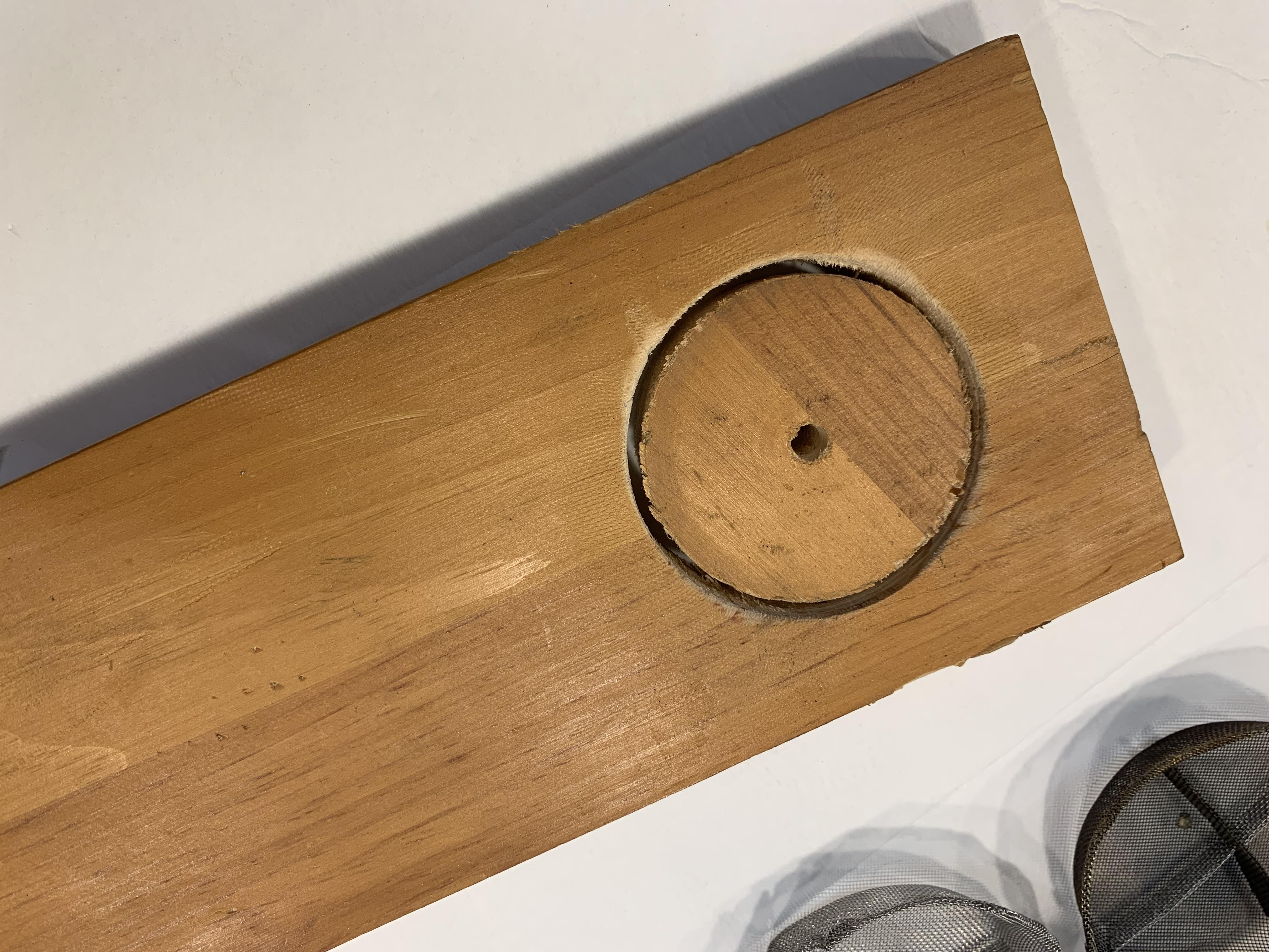

Starting off here with the amazon stainless steel mesh product and the wood used to form the baskets. Some cut up pieces folded over inside to make compartments. I tried to solder these in place but that was a failure. So at the moment they are just set in there, and do move around.
I think I will end up ordering some of those tiny little mesh baskets with lids - I have seen them for a reasonable price on etsy, of all places. Also I saw the parts basket used in the reddit thread on etsy for a more reasonable price as well, so may order to give it a try.

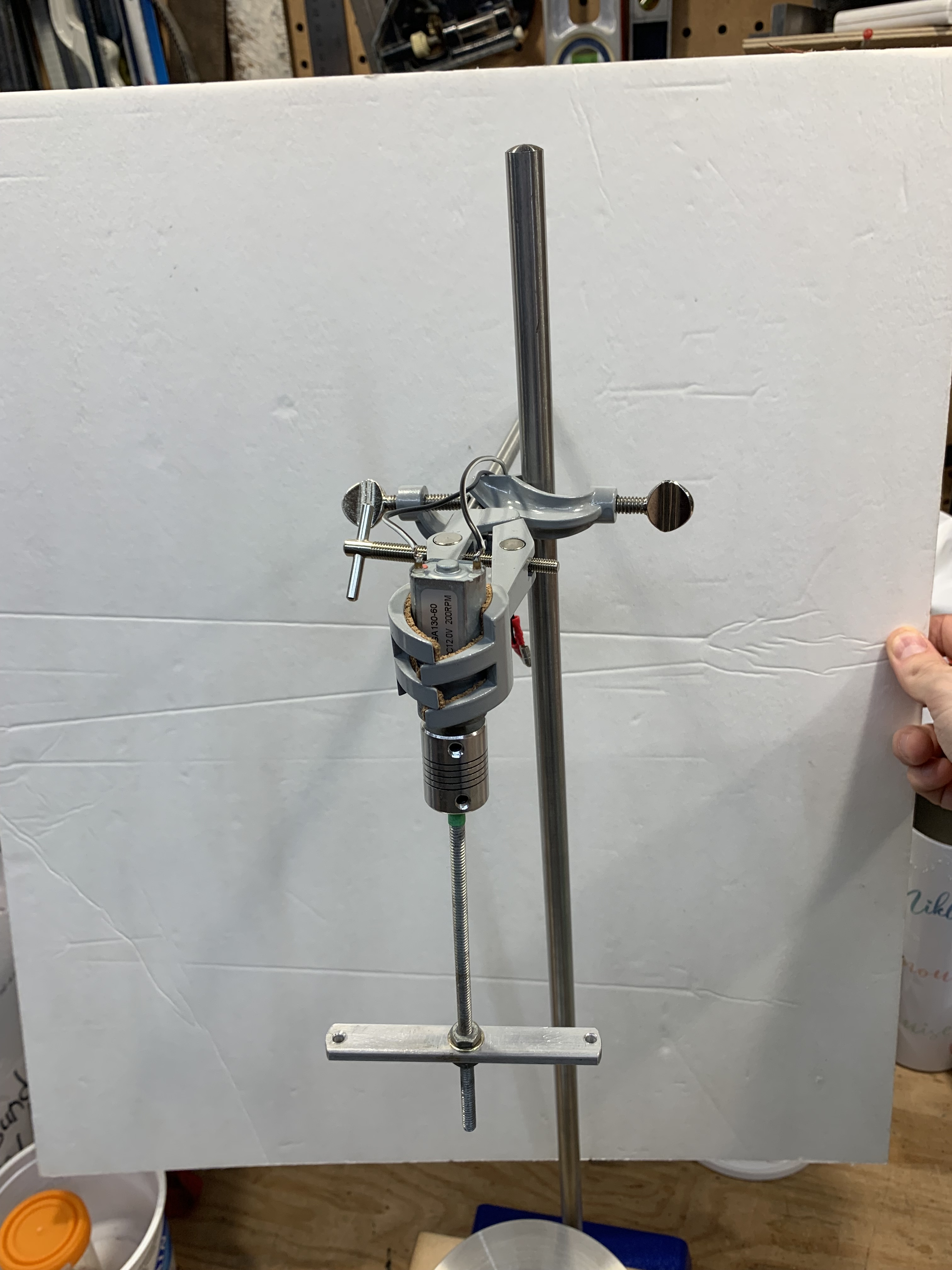

The lab stand came with the clamp and gripper. In the gripper I have squeezed a 12v dc motor. Amazon, $15. It is 200 RPM. You can get these for extremely cheap on aliexpress, but I didn't want to wait for the shipping. I have subsequently ordered/received a 500 rpm motor from aliexpress - my thought was to use a potentiometer to slow it down, but have the extra speed to spin between wash/rinse/rinse. I think that the 200rpm is nice for cleaning but it doesn't do a good enough job with centrifugal force to get the first cleaner out, puts soap into my 1st rinse. Maybe my DIY solution just isn't the best.
I have a flexible coupling, 4mm (on the motor side) to 5mm (approx diameter of the bolt I am using, I did have to add a bit of tape) to connect things up. At the bottom of the bolt there is a piece of aluminum, drilled so I can screw the pencil holder on, once loaded. A bit of a pain, but not like I am doing it all of the time. In a future version if I get that nice basket I may use little spring clips to grab its handle.

Couple more photos of my current attachment method.
I should note that I lost two parts from the basket when cleaning. One was the click spring - was at the bottom of 1st cleaner jar. So tiny it slipped through even the fine stainless mesh. The other was a spacer that Raketa uses on their balance bridge - it fell into where the pencil holder mesh meets the bottom and it was only luck that I happened to see it in there, shining a light. Another reason to switch to those little baskets with lids, I think.

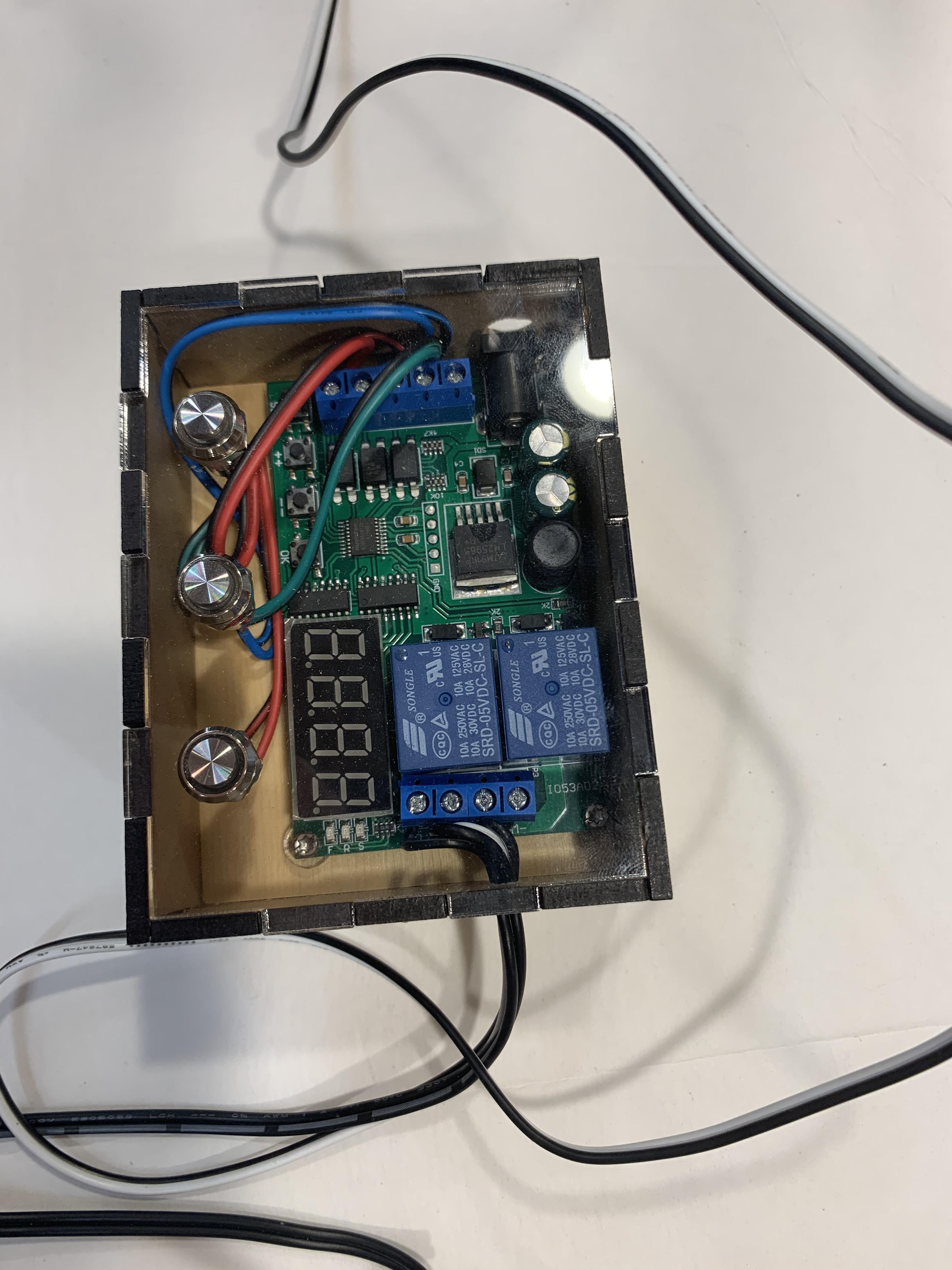

To control the machine, I have a pre-built controller, same as the redditor used ($20, amazon. I think it would have been close to the same price from aliexpress). It has multiple modes, but the one I found useful is where you can set time for direction one, stop time, time for reverse direction, and how many times this repeats. I have this on a little box I lasered, the redditor is just running it out in the open. It is dual power supply - a nice barrel plug for 5V, or can take up to 24v.
When the DC motor stops to change direction, it is very sudden. I would like to get a litlte circuit for slow start/stop, but haven't been able to find if these exist. I don't have the know-how to build myself, only to wire up something someone else has built. I like how the mastermatic is nice and easy when it changes direction.

Well done! Thanks for sharing! Again it seems to be obvious that the mesh basket is the most difficult to build component. That‘s why I ended up using a tea strainer.

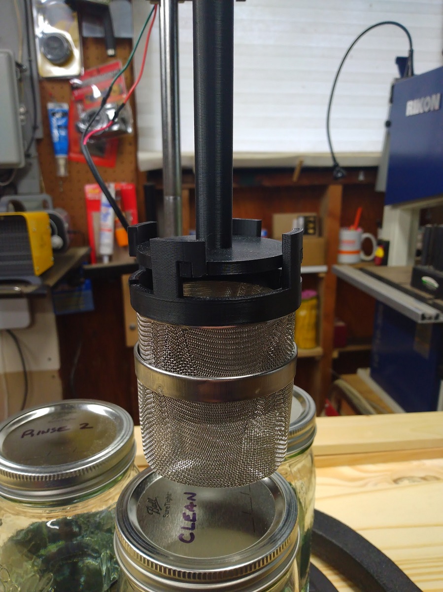

One more DIY machine 😉
The holder is 3D printed.
And here a short video:
https://youtube.com/shorts/murZNtfE3Kk?feature=share
Update: After a quite disappointing cleaning test I found out that the vortex caused by the rotation of the tea ball lets the liquid rise up at the jar wall and the inside of the ball fall dry. Designing a cleaner is not as easy as I thought 😉

I am glad to see that my post on Reddit inspired Charette's version of the watch cleaner! I have since added a 3D printed L&R type holder for the baskets. I use a 200rpm DC gearmotor and I think the speed is just right.

^^^ that looks great! I was also tempted to 3d print baskets but was worried how the chemicals would affect them. I folded and ordered the Elma baskets and holders this morning. I’m hoping to use a stepper motor to drive the lot with - it should have enough torque and would allow me to have it work bi-directional. We will see if my idea pans out.
3 hours ago, watchweasol said:
Hi Jack  a creditable machine well thought out.  Is the basket a DIY job also. Very good.
Thanks very much! The baskets are sold on Amazon as small task basket. https://www.amazon.com/gp/product/B0058ECYIY/ref=ppx_yo_dt_b_search_asin_title?ie=UTF8&psc=1
I cut off the handles and fit one basket inside another. I have cleaned about 10 watches so far. Used the L&R cleaner and rinse. I specified ABS plastic for strength and hoping to have better chemical resistance. I do not really submerge too deep. The liquid just hits the bottom of the 3D printed assembly. Another Reddit user designed the 3D parts and I had them made at Craftcloud.
