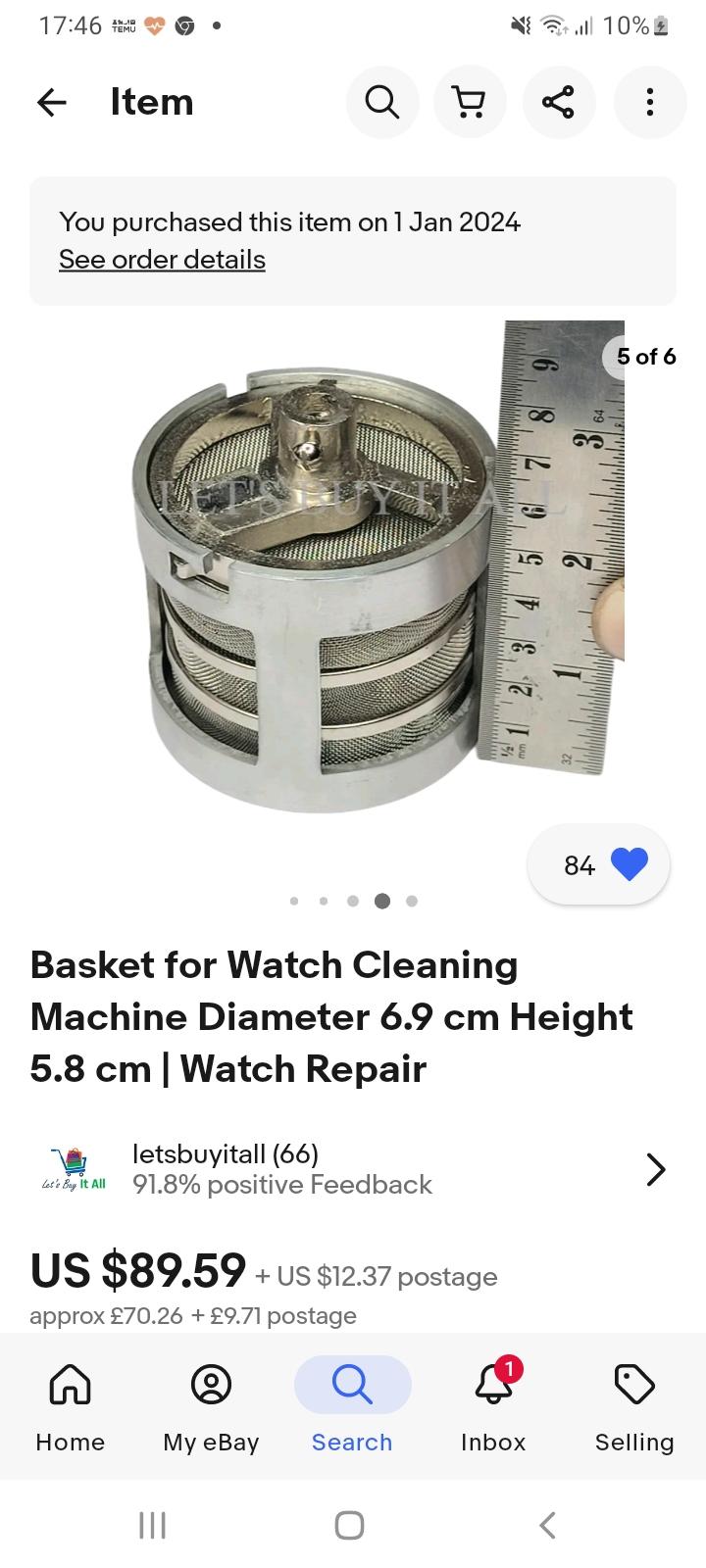

Hi swiss, Gert hasn't been around for about a year now, hope hes ok. I dont know where you are located but this is a good non automated option from Germany. Basically a lab stand, and a spindle motor connected to a fancy voltage regulator with a timer stop.
https://www.ebay.co.uk/itm/394609966471?mkcid=16&mkevt=1&mkrid=711-127632-2357-0&ssspo=pd7hhiotsps&sssrc=4429486&ssuid=tBiLZaCfRb2&var=&widget_ver=artemis&media=COPY
@Neverenoughwatches Hi. Thanks for the link. I'm for Zurich. I am planning to build something similar to what Gert had. I was wondering about the parts he used. The device from the link would probably do its job pretty well, but I'm interested in the different agitation levels and so on. And if I do it myself I would not have to explain to my wife, why I invested thousands in to a cleaning machine, that doesn't actually do much of cleaning. )))))

An home made motor shaft connector to connect the 8mm motor shaft to a basket (not sure what i'll use yet for a basket)
I made a basket from the plastic parts baskets cousins sell. An upgrade is on its way from India courtesy of HectorLooi's information.

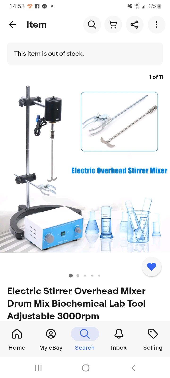

Would a standard lab stand be any easier to work with ?. Drilling a hole in the bracket so you can solder the adjustable rod in.
Do you have a link for the stand, it could be easier if i stuff up.
I've had an idea, i'll weld or braze a small 1 inch long square bar to the back of the bracket, this will push into the hollow arm of the stand then a bolt through it to keep in place, doing it this way makes it less likely i'll knacker the stand.
