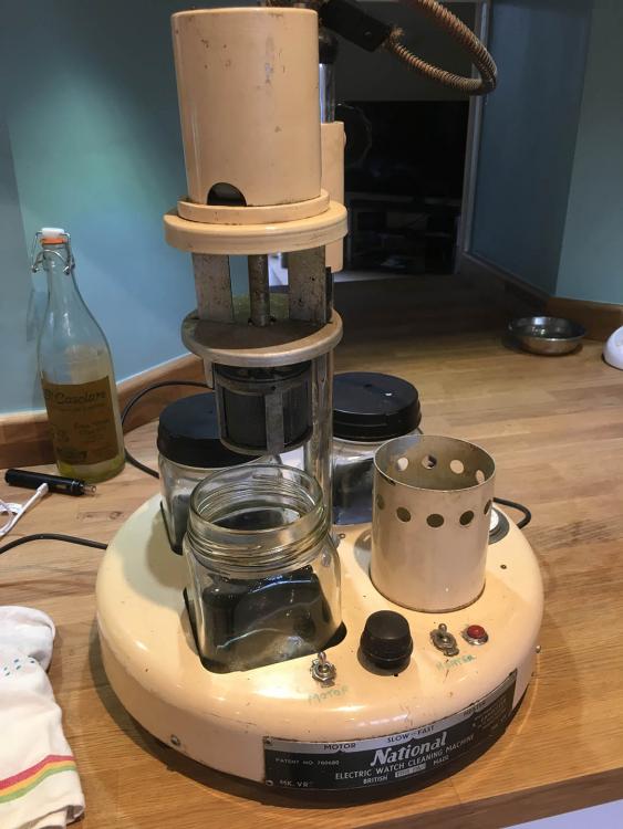

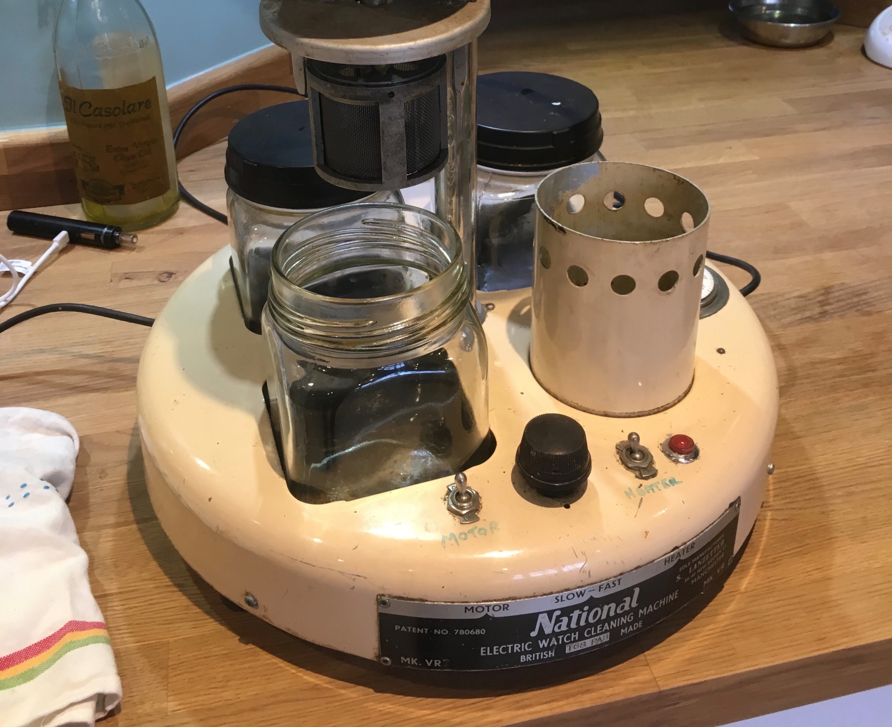

Thanks so much. I hadn't thought of replacing the whole thing. I notice that the National basket has an inner diameter of 54mm (from memory) which is smaller than the more modern Elmas.  Your idea is excellent and I'll keep my eyes peeled.
I have attached a picture of my machine for reference.
Thanks again

I have just picked up a National Electric Watch Cleaning Machine, all works fine apart from the heating element. I have a new one to put in. I will also be stripping cleaning and re painting the machine.
My question is does anybody know where I can get some more baskets that will fit this machine? It only came with one small basket.
Please put a picture up of basket and holder you have ... it's a little hard to imagine how the one you are looking for should look like!!
You have a number of options open to you, try and find a National electric complete basket off the bay but I think you would have more luck finding a bag of rocking horse poo than that. The national uses a three prong bayonet fitting that is 80mm across, the basket fits to a shaft with bayonet fitting  that is connected directly to the motor.InkedIMG_2500_LI.thumb.jpg.b0879c8b97b3e820dab72ca12b32cc5c.jpg
The photo above shows a National basket compared to probably the most common type of basket which is a Elma basket these are approx 70mm across, the dividers from the elma will fit snugley into the national basket so divisions can be created in the basket using these, I can with my national basket create 3 useful layers using elma dividers.
The Elma bayonet fitting is not wide enough at 70mm to fit directly to a national machine, but you can remove the shaft and fitting from the national by loosening the grub screw that hold the shaft to the motor and replace it with a Elma shaft and fitting again held in place with a grub screw, this would allow you to use elma baskets and dividers on the National machine,
