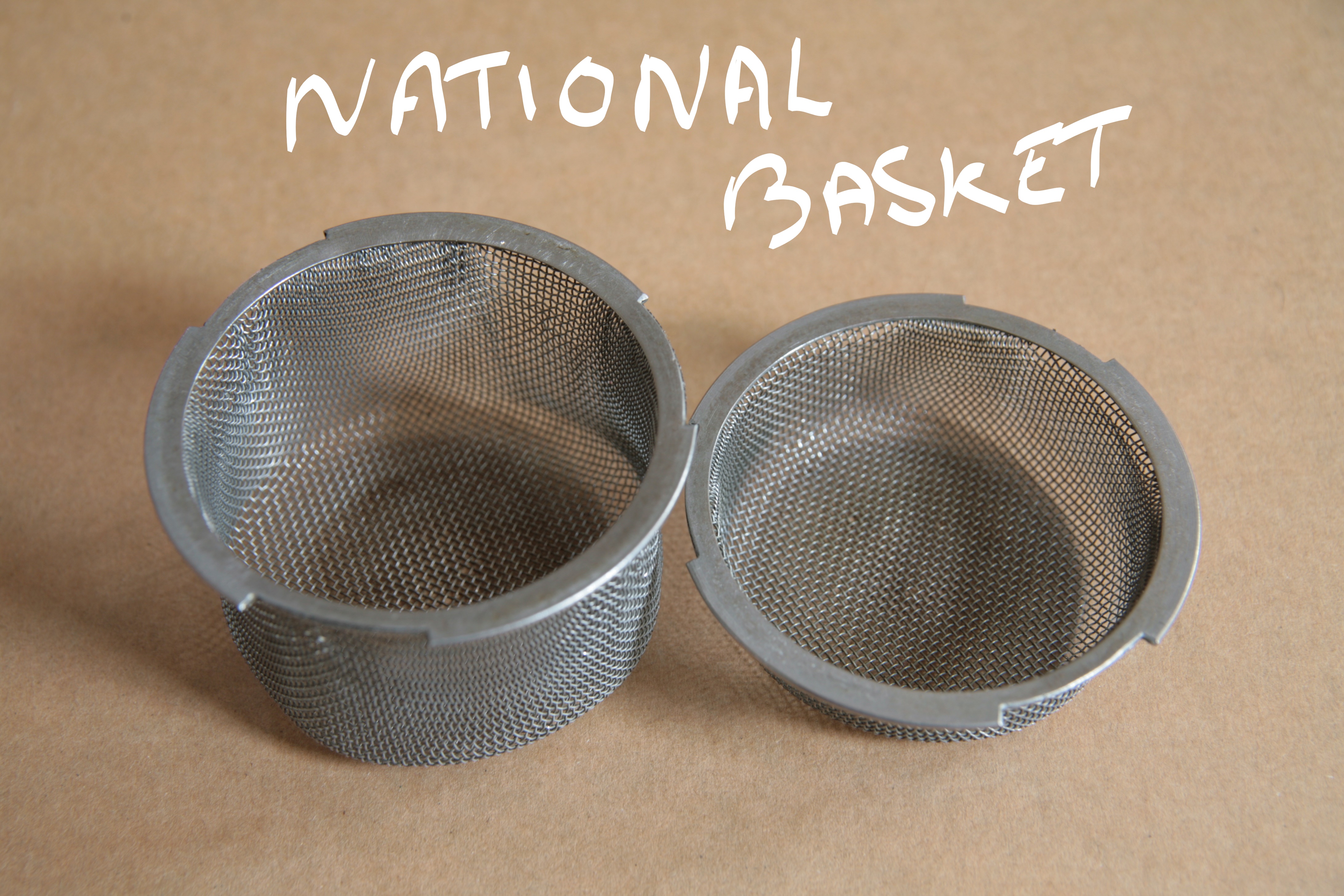

You have a number of options open to you, try and find a National electric complete basket off the bay but I think you would have more luck finding a bag of rocking horse poo than that. The national uses a three prong bayonet fitting that is 80mm across, the basket fits to a shaft with bayonet fitting  that is connected directly to the motor.InkedIMG_2500_LI.thumb.jpg.b0879c8b97b3e820dab72ca12b32cc5c.jpg
The photo above shows a National basket compared to probably the most common type of basket which is a Elma basket these are approx 70mm across, the dividers from the elma will fit snugley into the national basket so divisions can be created in the basket using these, I can with my national basket create 3 useful layers using elma dividers.
The Elma bayonet fitting is not wide enough at 70mm to fit directly to a national machine, but you can remove the shaft and fitting from the national by loosening the grub screw that hold the shaft to the motor and replace it with a Elma shaft and fitting again held in place with a grub screw, this would allow you to use elma baskets and dividers on the National machine,

Below is a two part national basket which is pretty much what they came with InkedIMG_2512_LI.thumb.jpg.87006c12aad6bdb36651a1b2e8cfb228.jpg
The elma basket dividers can be fitted into these InkedIMG_2513_LI.thumb.jpg.ba51d7741b230d1738f42d37eab6028e.jpg
And small mini baskets can be placed in anyInkedIMG_2514_LI.thumb.jpg.5d3829f6794d4bde6ea6ed32eaaefc7b.jpg
So with a bit of adaption or the use of elma basket parts you should be able to cobble together a useful set without spending a fortune.

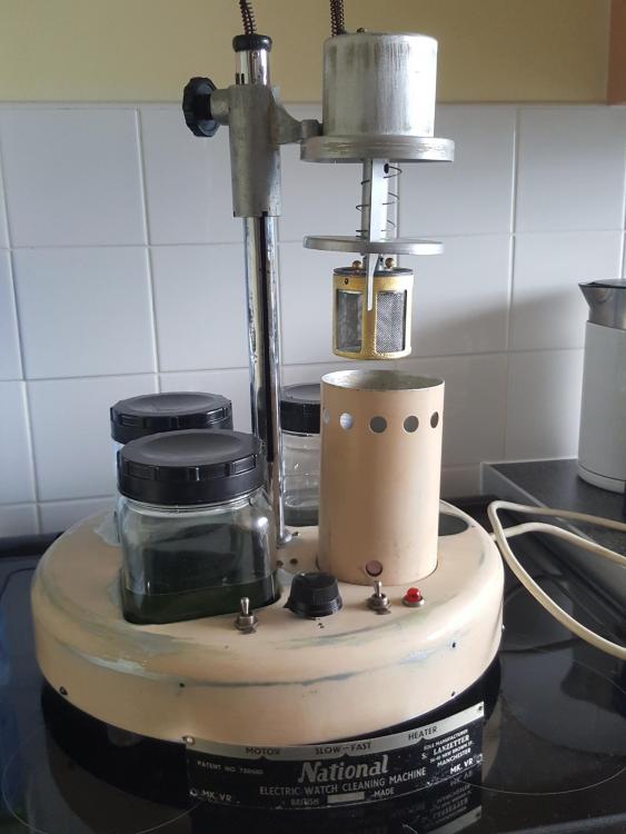

I have recently bought a National electric watch cleaning machine on eBay. I rewired it and bought L & R Extra Fine Watch Cleaning Solution and Rinse No. 3 in a three jar set up.
The problem I have is the watch parts don't come out clean. I put the basket in each jar for 12 mins and then dry over a really low heat hair dryer I rigged up in the watch cleaning machine, instead of the ceramic heating element. The fluid is half an inch above the basket when submerged and the metal wave breaks in the jar help the fluid not foam up. Technically everything is perfect. I have even put the watch parts in different parts of the basket to make sure it wasn't the way I was loading the parts into it. I originally put all the parts into wash and rinse without precleaning or pegging out in any way, to see if the solutions would clean the parts without having to pre-clean. They don't even look like they have been cleaned. Although the brass wheels like a lot shinier. Admittedly these are watches from the 60's that are filthy. It seems a long way to do it if I have to pre-clean all gunky watch parts, like pith and pegging the leaves etc. Is that usual practice?
I have added some pictures. I have recently sanded the machine down, ready for a respray, that's why the aluminium sign is not attached. The pic of the two jars are: The big jar is the first clean jar, which turned this green colour after my first wash. I think it was the dirty baskets, which I thoroughly cleaned after. (hindsight is a great tool!) The little jar is the colour it is when fresh. The two rinse jars are still colourless.

The colour of the fluid looks wrong. The rinse is clear and the cleaner a very light brownish colour NOT green. Was there contamination in the cleaning jar. The only other issue I can think of is if the jars are not spinning at the correct speed.

I have a national watch cleaning machine similar to the one you have the basket set up looks very different to the one I have attached to mine, on mine there is a fan like part that the basket attaches to this churns up cleaning fluids as it spins ensuring good agitation of the fluid.

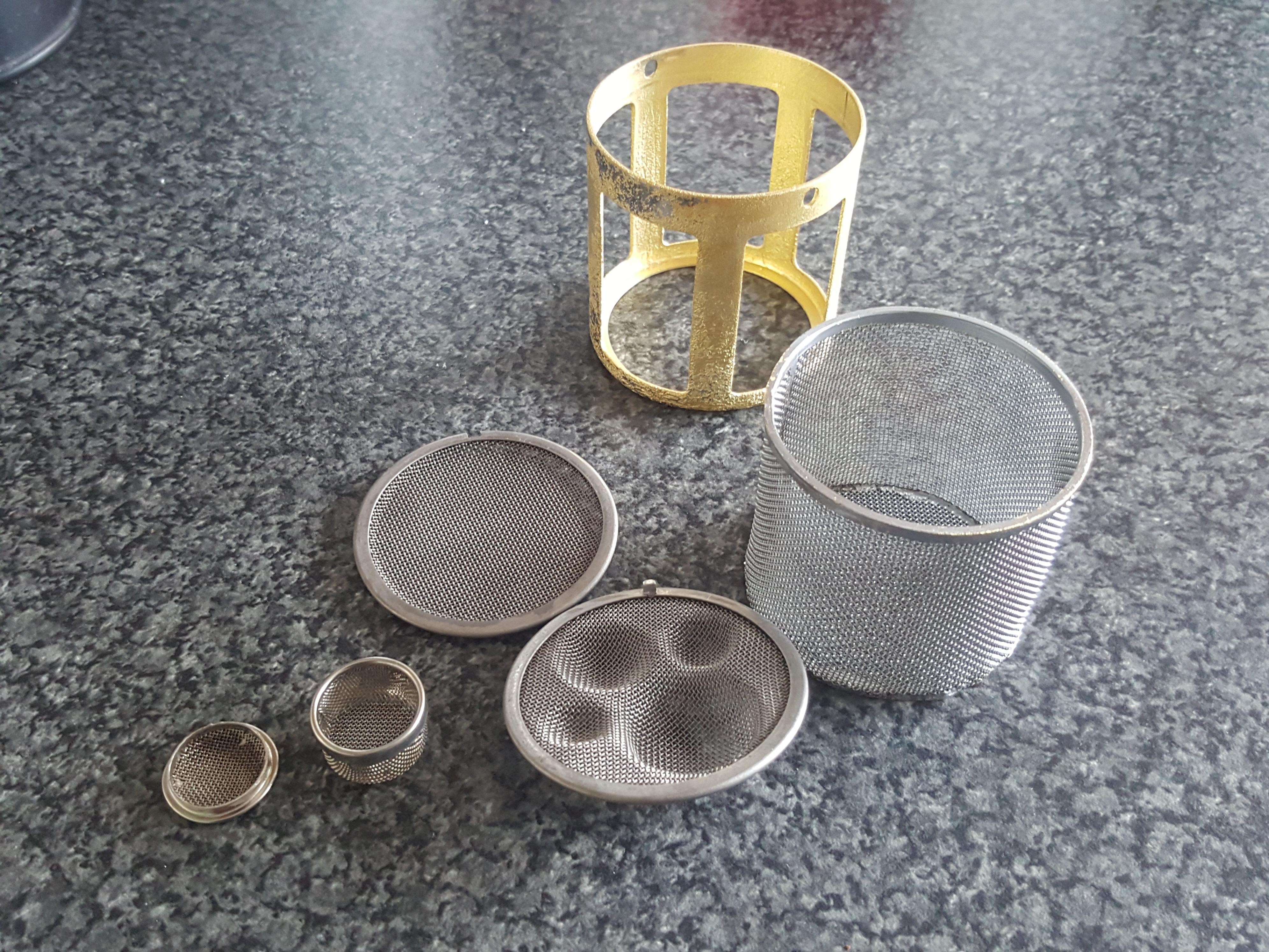

The brass basket holder you have looks very corroded i would be inclined to think the brass is reacting to the cleaning fluid causing discolouring of the fluid maybe re chroming would help with this.

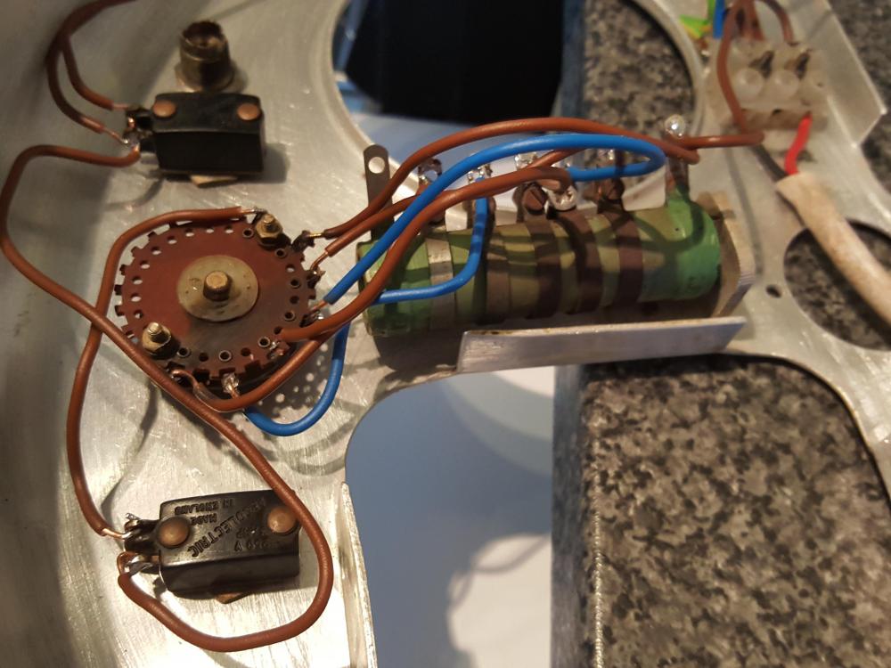

Does the rheostat speed control function correctly this machine would date from the 1950's so it could be worn and not spinning fast enough.
The colour of that cleaner is wrong, new cleaner should be colourless. The jars do not spin because it is not automatic (clockboy is having a senior moment) I get them too. L & R are probably the best you can buy. Do not buy ultra-sonic fluid because your machine in not of that type. 12 minutes in each jar is fine. Not sure, about your heating chamber and the time you have it spinning in there. If you raise the basket, each time and spin off that will help when switching jars and the heating to dry.  I think it’s down to the cleaning solution.
The cleaning fluid was colourless. It changed to green the first time around, which makes me think the baskets were a lot dirtier than I first thought. I think the shaft was probably changed, that's why there is another basket arrangement.
I think that green colour might well be the brass reaction maybe, although I'm surprised at this happening as brass wheels are being cleaned.

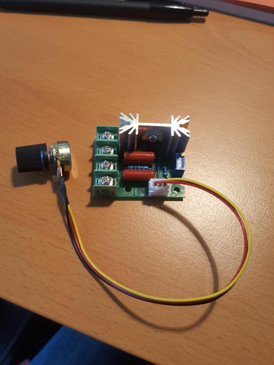

Thanks for all the replies. I'm going to change the rheostat, although I did rewire everything before even turning it on... It was 1960's wiring after all! I've got a variable voltage controller, which doesn't fry the motor, as it takes into account other factors than just dropping voltage.
I've attached a pic of the old rheostat wiring and the voltage regulator. I'm going to have to change that basket. That brass is not helping at all. If I can up the speed without it shaking itself to death, change the cleaning fluid and change the basket, then I reckon it was worth the investment and it surely has to be quicker than hand cleaning/ultrasonically cleaning with lighter fluid/IPA.
