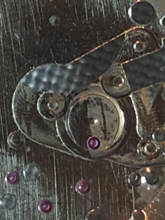

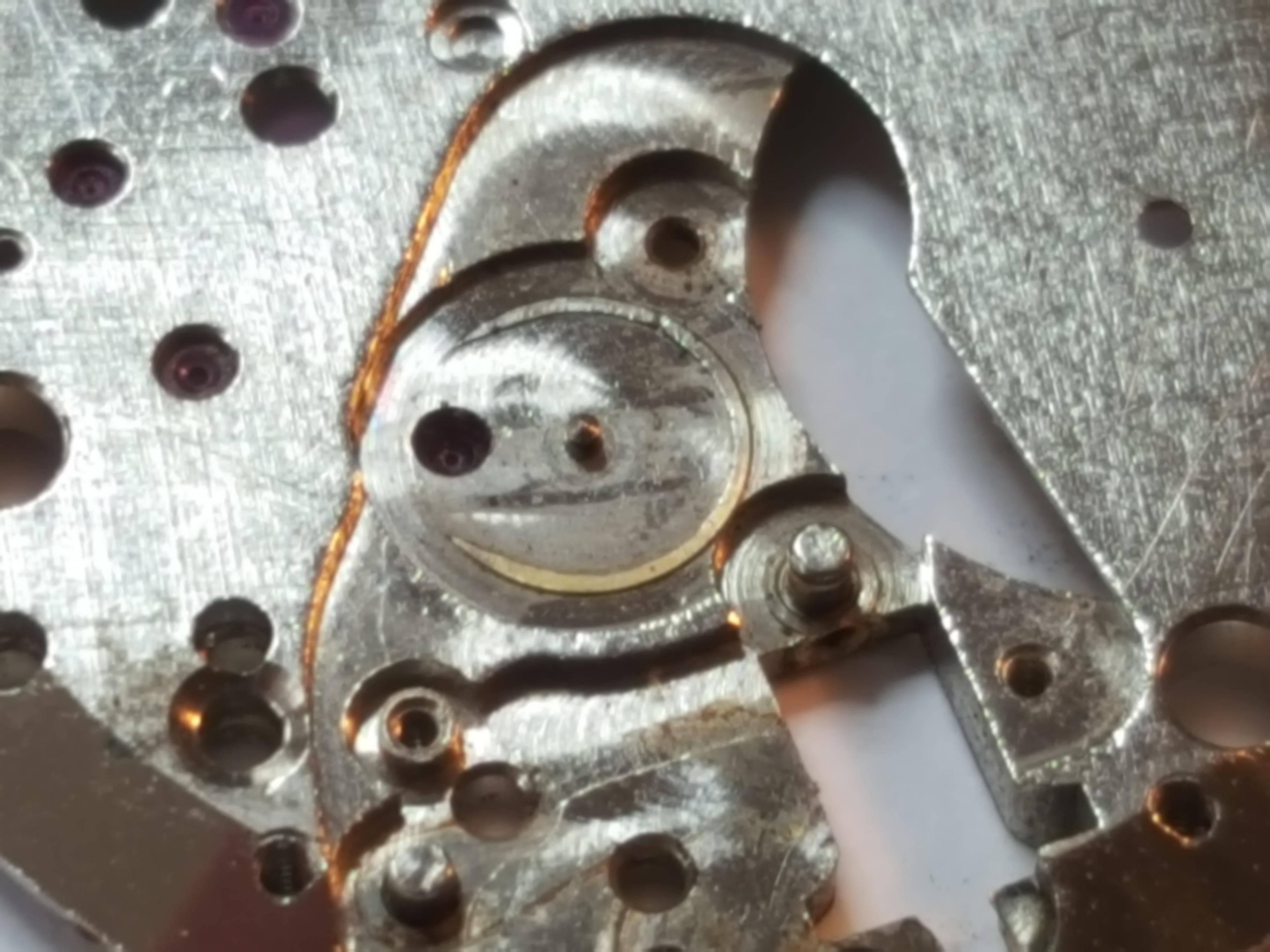

I've changed the basket and placed the plate in on its own and it still comes out with a film of muck on it. I made sure that I kept the speed down to avoid any bubbles, but not so slow. I did change the cleaning solution and this one has turned a yellowy colour.
This is getting infuriating now. I don't know what I'm doing wrong, apart from trying changing the cleaning solution. But that's an expensive experiment.
I have used it for a few years now with great results. Have you tried cleaning a different watch. Thinking it might be something already impregnated onto the watch. The fluid still looks to be the wrong colour. When fresh it is a very light brown colour. Also noticed how fast your basket is turning seems a bit fast.

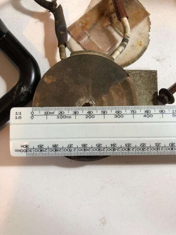

I have got a National Electric Watch Cleaner and as expected the heating element is bug***d (sorry, not working). Everything else is OK and the motor and bearings are nice smooth with good control from the speed dial. With a bit of TLC (and rattle-can black) it will provide me with good service.
Does anyone know if the heating element from the Elma RM80 (90) is a good match for this machine? It basically just needs to operate at mains voltage and fit into the space where the old element used to fit. I could use it without the heater and just bodge something with an old hairdryer to provide a warm airflow, but I am hoping that the Elma element could be used. Has anyone ever tried this?
I am going to re-wire it and makes sure it is up to current safety standards, as it still has its original (seriously old now) wiring scheme. New Jar seals will be needed but I have some aviation fuel/chemical grade 3mm rubber gasket material I can hand cut to suit, so that will be OK. The jars and lids are sound and just need cleaning (and the seals). And it has a complete set of baskets, which is a plus.
I have included a photo of the old heating element for a size reference. Unfortunately for me, Elma do not state size of their replacement element.
