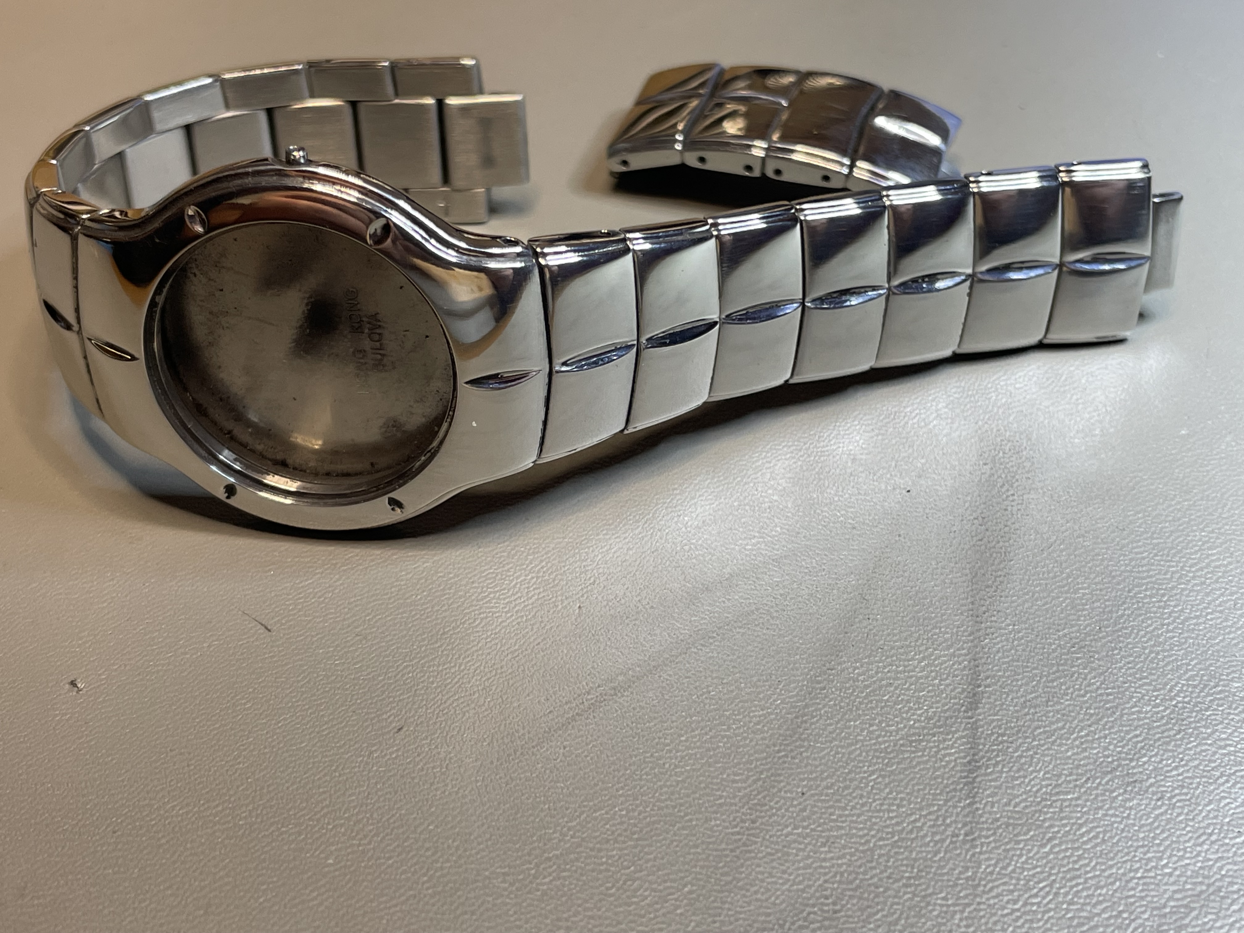

Earlier yesterday while having lunch with a friend of mine who knew that I had been trying my hand at watch repair, he asked me if I'd take a look at a watch he's had in a drawer for a few years that quit running.  He knows basically nothing about watches and just asked me if I could get it running and just clean it up a little bit.  When he gave me the watch it was a small Bulova quartz watch.  It is a pretty interesting looking watch with an incredibly thin case.  I knew that I could help him with it so I agreed to take it back with me.  I'm assuming it's just a battery on the Miyota 9U13 quartz movement so I went ahead and ordered one last night.  After I got my Lord Matic crystal installed yesterday evening I decided to get a little bit of the cleanup done on the watch while I wait for the battery to come in.  I pulled it apart and removed the crystal (which will also be getting replaced as it had quite a large crack in it towards the top - not pictured).  It had what looked to be an integrated bracelet, but they are really just designed to look that way.  The pins to remove the bracelet were very stubborn, so I just decided to clean it as a unit.
68438941904__92F9B8AB-A128-44F1-AADA-00545156AE38.thumb.jpg.d07cabf3db5042db7967fb23826bfca1.jpg
Once cleaned I could really see how beat up it was.  The picture doesn't really tell the full story, but was just covered in scratches and dings.  Since his original request was only to get it running and to clean it, I asked him if he'd be willing to let me attempt to get out a lot of the scratches and try to make this thing look a bit better, aside from just getting it running.  He agreed.  I began with some 800 grit sandpaper, then moved to 1000, 2000, and then some micron sanding papers.  I didn't want to sand too much on a few of the biggest problem areas, but I'd say that I got 95% of the issues resolved.
I ran it on my buffing wheel with some blue and red polishing compound to bring it to enough of a high polish to use a starting point before brushing:
FYI - I did not bother with the back side of the case or bracelet.  They had a brushed finish that was in really good shape and did not need any attention.  All work was done to the edges and forward facing areas.
After about 5 minutes of applying the brushed finish using 3M Very Fine, then 3M Ultra Fine Scotch Brite pads, I'm really pleased with how it came out.  I kept the edges of the case and bracelet polished, and brushed the rest.
I think this watch is going to be stunning when it gets it's new crystal and is reassembled.  Since he's a good friend of mine, we decided that the cost of work would be him covering the cost of any parts, and my lunch!  It turns out I really liked doing the case refinishing work.  It was a learning experience that I really think turned out well.  The lunch was good too, so I suppose it is worth it!
