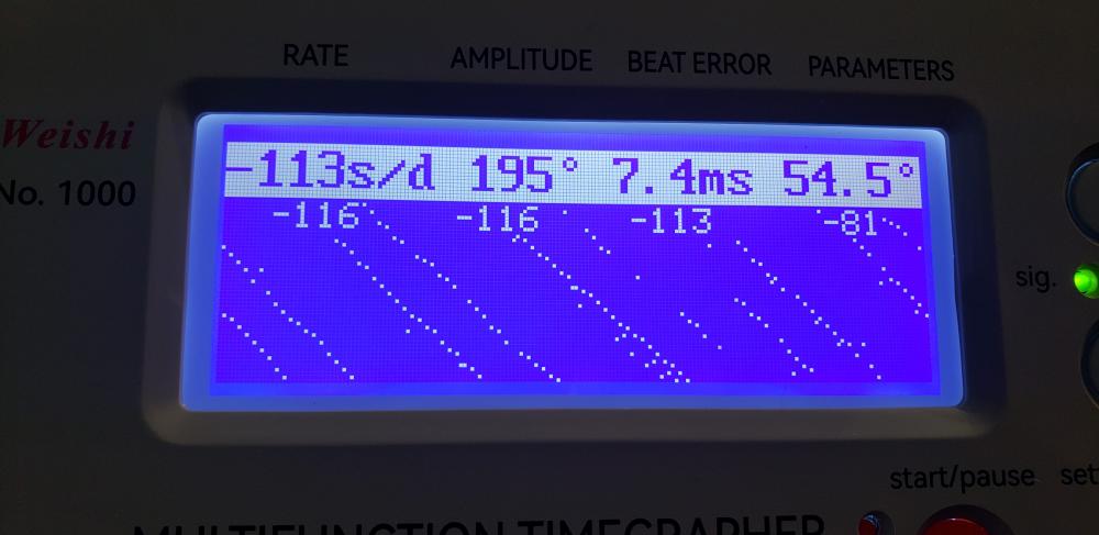

First off let specify the watch.  Seiko 6139-7100.
Just cleaned it, inspected it, reassembled and oiled.  Put it on the timegrapher and im getting 300 degrees of amplitude with .6 ms beat error dial side up.  Ive not seen a seiko get that high in amplitude so makes me think something is significantly off.  1st pic
Move it to dial side down and and amplitude drops significantly but improved beat error.  ( this amplitude was in the realm of what I was expecting given the age and wear of this watch) 2nd pic
Put the watch in a vertical position with crown pointing down and balance vertical at 12 o'clock position.  Amplitude improves but beat error goes to hell.  3rd pic
Trying to find some decent discussion topics on this.   Should I be looking for worn pivots or jewels.   New to the diagnostic game but past tinkering in other hobbies tells me the rotation of a shaft is not running true somewhere in the gear train.
Thoughts?

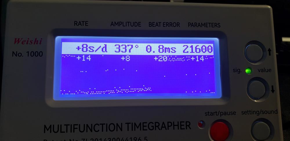

one of the things you have be very careful about is looking at everything. When it's supposedly doing 337° does it visually really look like it's doing the 337°?
one of the problems with timing machines if the amplitude is too low the timing machine can read the wrong part of the waveform and give you really happy numbers. If this doesn't just occur on the Chinese machines I've seen witschi machines get fooled for the same reason.
So for instance image attached one watch to timing machines and they were attached to the same watch at the exact same time they should be exactly the same and here's an example of this super low amplitude in this case the witschi is right. But the Chinese machines reading the wrong part of the waveform and look at the happy numbers you're getting.
This is where you also have to visually look at your balance wheel what is it doing is it really look like it's running at 337°?
one of the things that sometimes occurs with super low amplitude is beat error seems to increase. It's basically where you don't worry about beat error until the amplitude is closer to 200° because often times that goes away it's a byproduct of a super low amplitude.

Interesting.  I hadn't thought of the machine reading the wrong end of the wave.  Visually, it definitely was not. Just over 180 when I used the slow motion video feature on my phones camera. Condition of the watch was fair.  It was an ebay buy missing a few parts that I pulled from a donor movement.  The biggest piece being the balance and bridge.
As far as lubricants d5 on barrel arbor and calendar works, 9010 on gear train pivots except escape wheel, hp 1300 on escape wheel pivot, and 9415 on the pallet pins and jewels.  The are alot of conflicting charts out there on what oil where.  Please let me know if I got that wrong.  In total transparency I havent researched this alot.  Just found a chart that seemed legit so went with it.  Can't remember where I got it from.
