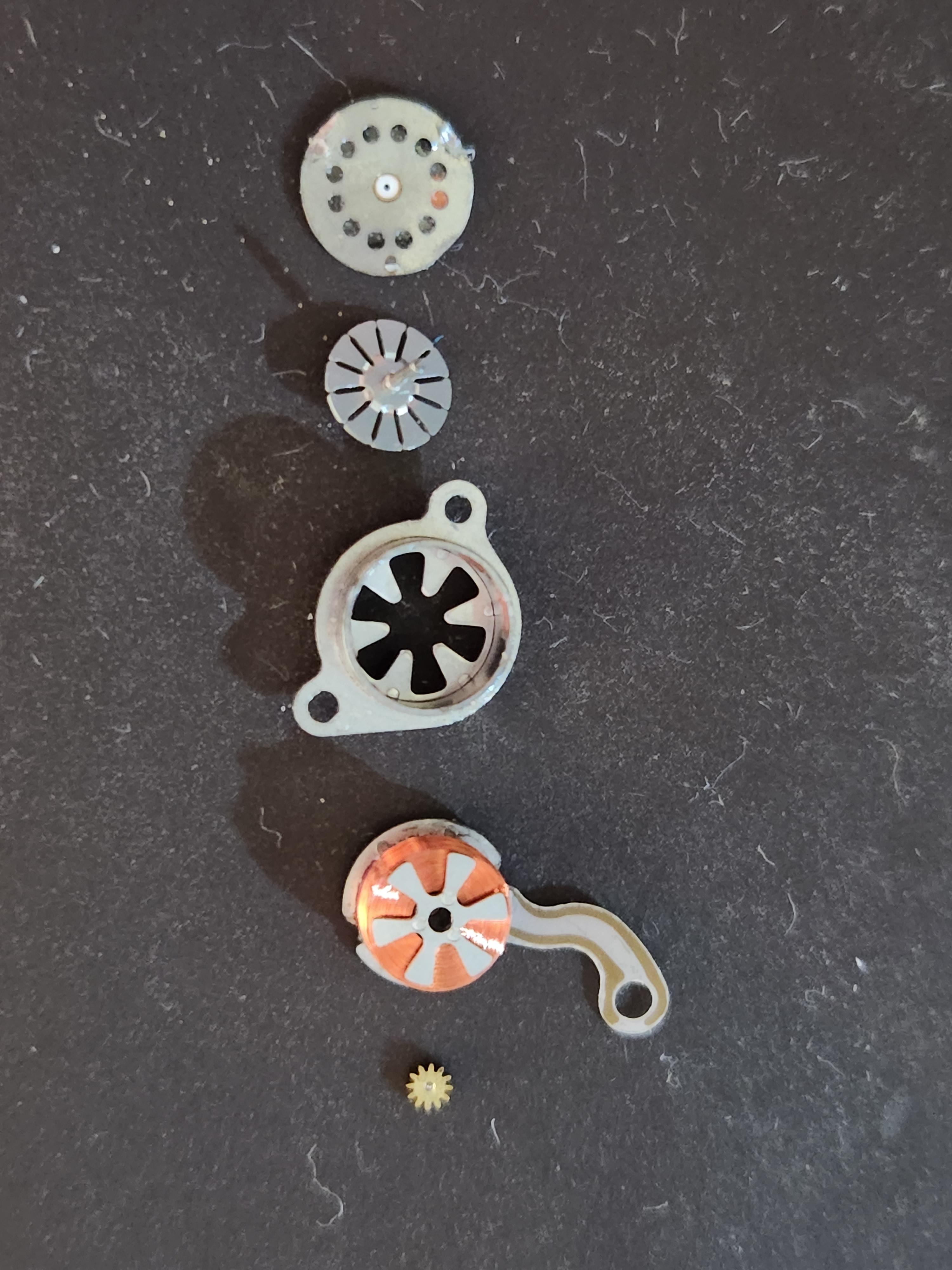

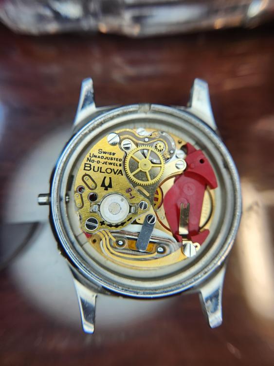

I just got this non-working Bulova Quartz this week.
It houses a Bulova 2426.10 movement. When power was applied, the motor just twitches. My Bulova meter showed that the pcb appears to be functioning. A resistance check of the motor was around 640 ohms. When 1.5V was applied directly across the motor contacts, the rotor only twitches. This is something that another member, @PastorChris, experienced a couple of months earlier.
I decided to cut open the motor to investigate. The pivot of the pinion was so brittle that it snapped off the moment I pulled on it.
The spot weld of the top cover was so weak that my razor blade cut through it with one tap and went straight into the coils, thus cutting it. 😥
The lower cover took a bit of bashing to remove it. I discovered a couple of metal filings across the leaves of the magnet. That was probably shorting out the magnetic field and the cause of the twitching.
This is a really brilliant design but probably very expensive to produce. I'll be on the lookout for another similar movement.

Hello thank you for your reply.
My theory was to demagnetise the magnet temporarily to shift the debris.
Whether thats a flawed theory or not i do not know but it worked.
The 5 ticks i was getting after was actually due to the battery being drained, i accidentally put in the original right sized battery after demagnetizing instead of the brand new slightly wrong sized that i had started with.
Its been running flawless for the past 24 hours.
