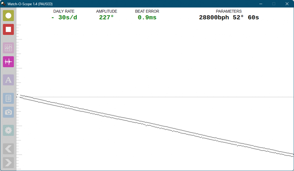

Okay, still needs work, but definite progress. Got the spring almost flat, and wanted to test it out before I went any further. In the video below, the train is lubricated (including epilame for the escape wheel/pallet fork/cap jewels, and 9415 for the pallet jewels), but the balance jewels have not yet been oiled. The train runs very free, and end shake looks good on the wheels.
I set the balance end shake as recommended in the tech sheet: backed off the screw until the balance just stopped turning, then back in about 90 degrees.
I can see the pivots in the hole jewels, but the wobble of the rim has me a little concerned. I'm going to take the jewels off again and double check and lubricate everything.
Slow motion video link.

Casually of course you amplitude it looks too low but we do have to see the oscilloscope to see how that looks. Then one side of your escapement is rough when you lubricated the pallet fork with the 9415 may be put just a little bit on the other pallet stone because it may still be dry sometimes you do not careful lubrication one of the stones ends up without lubrication and you can have stuff like this
oh and as far as the balance wheel wobbling a little bit it may not be the pivots in the jewels it could just be that the balance wheel wobbles the balance. I've seen that with the Rolexes we do in our shop where somebody is probably restaffed it in the past they worked perfect about truing the balance wheel and it wobbles. So if it was brand-new from the factory of the absolute perfect but if somebody else worked on it though building and walk so little bit isn't going to your problem a lot could be
oh and of course the rate is a huge problem. But I can't remember what the software whether there's a way of calibrating it? Because if your software is relying on a time base that's not perfect and you trying to time a Rolex watch that has to be perfect then you might be seeing a problem from the lack of calibration.

I did, and they were very happy. I'd call this a significant improvement.
I'm going to let it run overnight and check it again tomorrow. The hairspring could still use a little more tweaking, but at some point I'll have to leave well enough alone.
What causes the balance wheel to wobble if it’s been trued?

if somebody replacing a balance staff is not careful they can screw up whether the thing is running flat or not possibly. Then if they put it back how closely do they put it back what if they don't.
So you end up with Rolex watches that should be absolutely perfect but the balance wheel is still out of flat by a very tiny amount. I've seen that I work were looking at Rolex on the timing machine egg and see it vibrating up and down a little bit and nobody's worried about it because are not going take the time to fix the problem but there it is out of flat. So I assumed it was from replacing a balance staff.
in other words just speculation on my part
