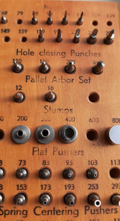

Could you take a photo of the hole-closing attachment? I’m curious how a lever jeweling tool could close a hole where a staking tool didn’t.

I hadn't realised until I just looked, my jewelling tool has hole closing bits.
I don't know whether you are supposed to just press the lever, or hammer on the top ?
That’s an interesting “pusher” for hole closing. Do you use a flat faced anvil at the bottom? I’m also curious if just using the lever will generate enough force to deform the brass plate, or do you use the spindle (with hole closing punch inserted) with a hammer like in a staking set.

6 minutes ago, GregG said:
Mike's already beat me to it, but these are the ones I bought.
https://www.cousinsuk.com/product/seitz-jewelling-reducing-jewel-hole-tools?code=J30577
I use it with the regular jewel press, no hammer involved.  The lever will give you a huge mechanical advantage.

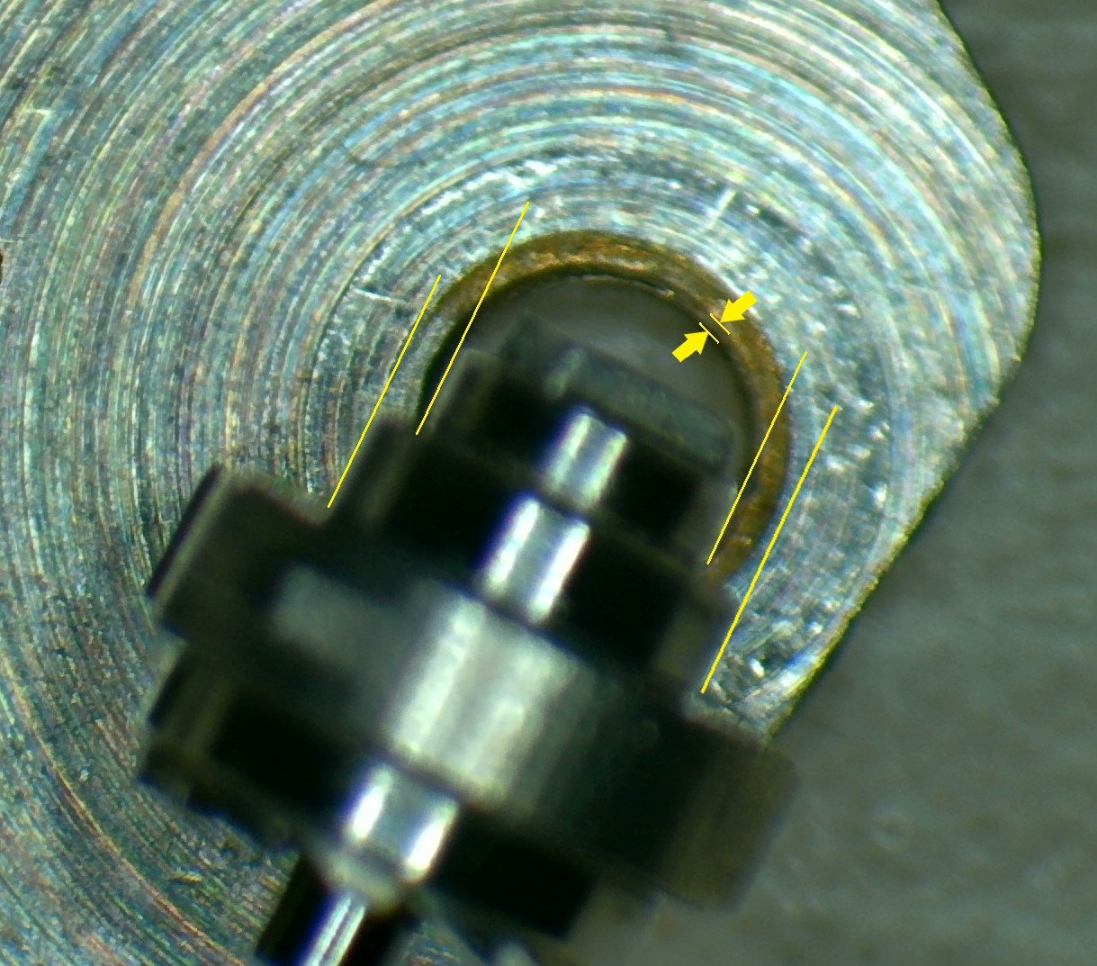

That's how I did it until I saw Kalle Slaap's video. As @ifibrinpoints out, if the plate isn't flat, it can be difficult to sit it on a flat stump, and get the punch exactly centred.  I had this problem and ended up with the created chamfer not being symmetrical.
Using the two punches makes it much easier to get the plate and punches perpendicular, and the punches centred in the hole.  As @praezis points out, there is a danger of increasing vertical play, but this shouldn't usually be a problem. The pic shows one I just did, with the chamfer arrowed, being much less than the width of the arbor shoulder.
Also a question of the dome radius.
A high domed punch will leave a small chamfer but rather push the metal aside. A lower domed one will push the metal more down and close the hole, but produce a wider chamfer.
A bit dangerous just with those narrow shoulders of barrel arbors, where all support is needed to avoid digging into the brass.
I admitted that I do this, too, to avoid higher cost and prolong the period until a "real" repair will be done. But this punching is just a short term, not lasting repair.
