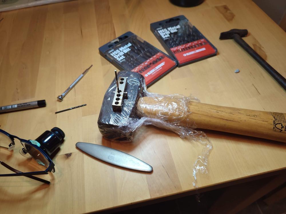

If there is one tool I love more than any other it is my Jacot tool. We often emphasise the importance of perfect pivot holes, but the truth is we need perfect pivots as well.
With apologies to those who find poor workmanship viscerally painful (I admire you), hobbyists on a small budget might be interested in an existence poof that sometimes barrel bridge arbour bearings can be closed with only improvised tools, no staking set.
The watch is a Rotary bought for £5 on ebay with a Peseux 350 (those images on ranfft.org are from me). After cleaning and lubing, the watch would still not run for long because only a tiny wobble of the barrel causes it to rub.
Raiding my toolbox, the stakes were the wrong ends of HSS drill bits (2mm and 5/64"). They were already domed but I dressed them using a Felco diamond stone, bought for secateurs. One "stake" was held vertical-ish in a salvaged earthing block on top of a club hammer as an anvil. The bridge was held roughly in place on top with blu-tack / rodico while I held the second stake in place above. Then I got everything as aligned as possible freehand and did very gentle taps with a pin hammer, lots of rotating and testing.
It wasn't difficult to close the hole until the arbour wouldn't fit. I improvised a broach by stroking a screwdriver lengthwise with emery paper and carefully opened up the hole.
I had to tighten the bearings in the barrel and lid with similar bodges, including use of the jaws of a pin vice as a conical hollow stake. I reiterate: these are clearly execrable practices. But my watch is running nicely (for now!) and I enjoy not having spent money.
I'm not entirely sure how this would work not being tapered to keep the ream central, i guess a little file here and a little file there , not ideal but it appears it worked for you.
I was encouraged to give it a try by this section in "Staking Tools and How to Use Them" (1910)
though it's talking about pocket watches. (This publication is freely available online.) In my case, without any taper, I applied sideways pressure by hand. As you said, gently and little by little.
Thats an interesting idea, i think you could broach as normal with a taper but the difficulty with a straight tool is not being able to make use of the even size variation possibly elongating the hole .
