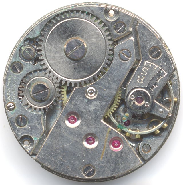

looking in the bestfit book gave me a clue and the website has a picture
http://www.ranfft.de/cgi-bin/bidfun-db.cgi?10&ranfft&0&2uswk&FHF_150_0

I don't know who or what Orient Star is, but surely no Ebauche member, who used that coat of arms frame.
But FHF did, it is a FHF 150, John already found out.

The bridge design of the FHF 150 is very different though!?

True.
Maybe Boydie should offer his picture to Ranfft?

the fingerprint system identifies the watch by the setting components. Ideally you would have the physical bestfit book because the pages are printed to an exact size and the parts will lay on top of the book.
As someone else pointed out the bridge design has nothing to do with who made the watch. Lack should be quite common to have variations in bridge designs.
Then conceivably but I don't feel like looking it up it may be that both watches are actually the same would have to look up how the parts cross reference as to whether they cross reference.
Like for instance if somebody purchases OEM movement and re-brands it as their own and possibly changes stuff or possibly dozens then with the fingerprint system they may appear to be identical.
