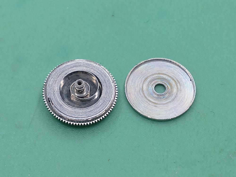

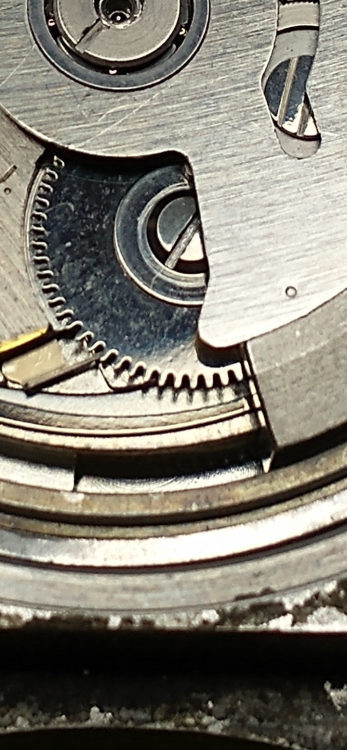

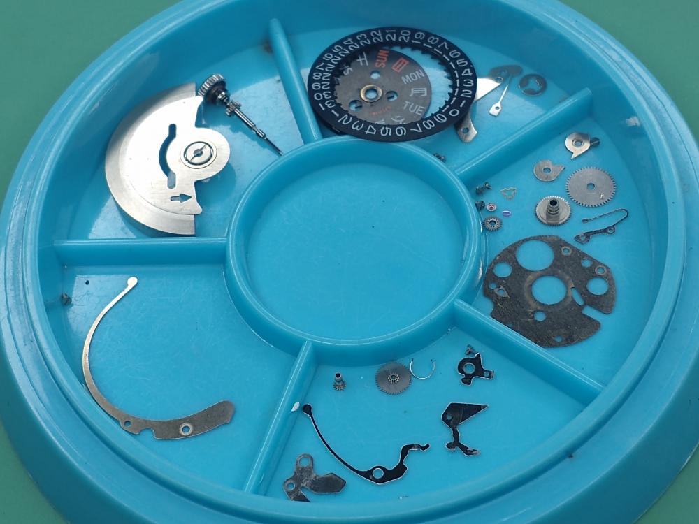

Okay, so I inspected further and figured this out:
When I tighten the top screw for the flat wheel on top of the barrel (image 3), the barrel tilts downwards on right side of the image 1 and make resistance with the bridge of centre wheel (image 2) and the bridge above barrel. When I don't tighten the barrel screw, the barrel lays flat. And the barrel screw aren't bent either. Now I just don't know where the fault is😧IMG_20221119_033407079.thumb.jpg.351041cd1b0a7d9004753391764a5132.jpgIMG_20221118_225222878.thumb.jpg.51c80ab31fd38d8f5a35fa6cc0a72be9.jpg
Edited by Khan
 Further investigation is needed to reveal whats causing the barrel to rub on center wheel's bridge, most common causes are as follows.
1-  Incorrectly seated barrel lid, The lid should be seated flush level in the barrel , if tilted or not flush ,it can rub on the barrel bridge or center bridge or center wheel. if seated too deep in the barrel it rubs on the mainspring.
2- Bent bridge( barrel bridge or center wheel's bridge )  or bent center wheel.
Turn the barrel while observing the center wheel, if the wheel is bent it wobbles as it turns, unbend it to streighten the wheel.
 Streightening a bent bridge is kinda hit and miss game, I would just shim the bridge to free whatever rubs, cut a shim out of real thin aluminum foil to place  in between the bridge and mainplate so to raise the bridge, you need to find which bridge to raise and the location the shim should be placed.
3- Damaged barrel teeth .
Good luck pal.

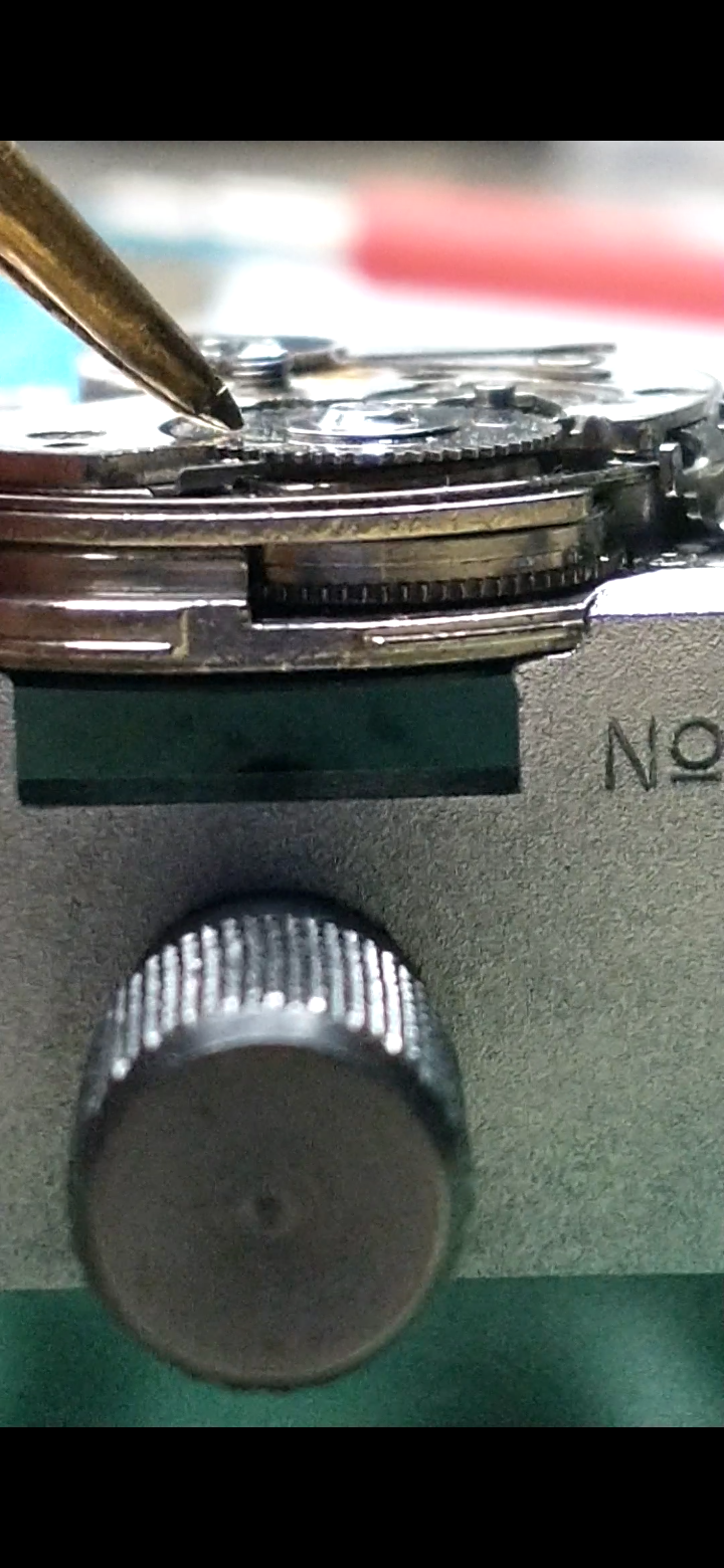

Hi Nucejoe
Appreciate your time for giving ideas.
I figured out that the barrel tilts when putting power on the barrel by turning the screw, when pallet fork installed. It actually runs freely and smooth (with and without Chrono on) when pallet fork not installed and turning the screw head on top. I noticed that the barrel tilts when I push on the left side of the barrel top wheel, see last picture. So this barrel wheel gets wavy when tightened with top screw. What could be the reason? Screenshot_20221120-133702.thumb.png.4b4491a7975b41ce2f6f96205256cef9.png
Edited by Khan
Hi khan,
Its due to excessive side shake on barrel arbour, which in turn is caused due to worn bushings in the mainplate or barrel bridge or the arbour itself is worn thin.
I remove just the ratchet wheel and check the barrel arbour's side shake, you should feel almost zero side shake.
Good luck pal.

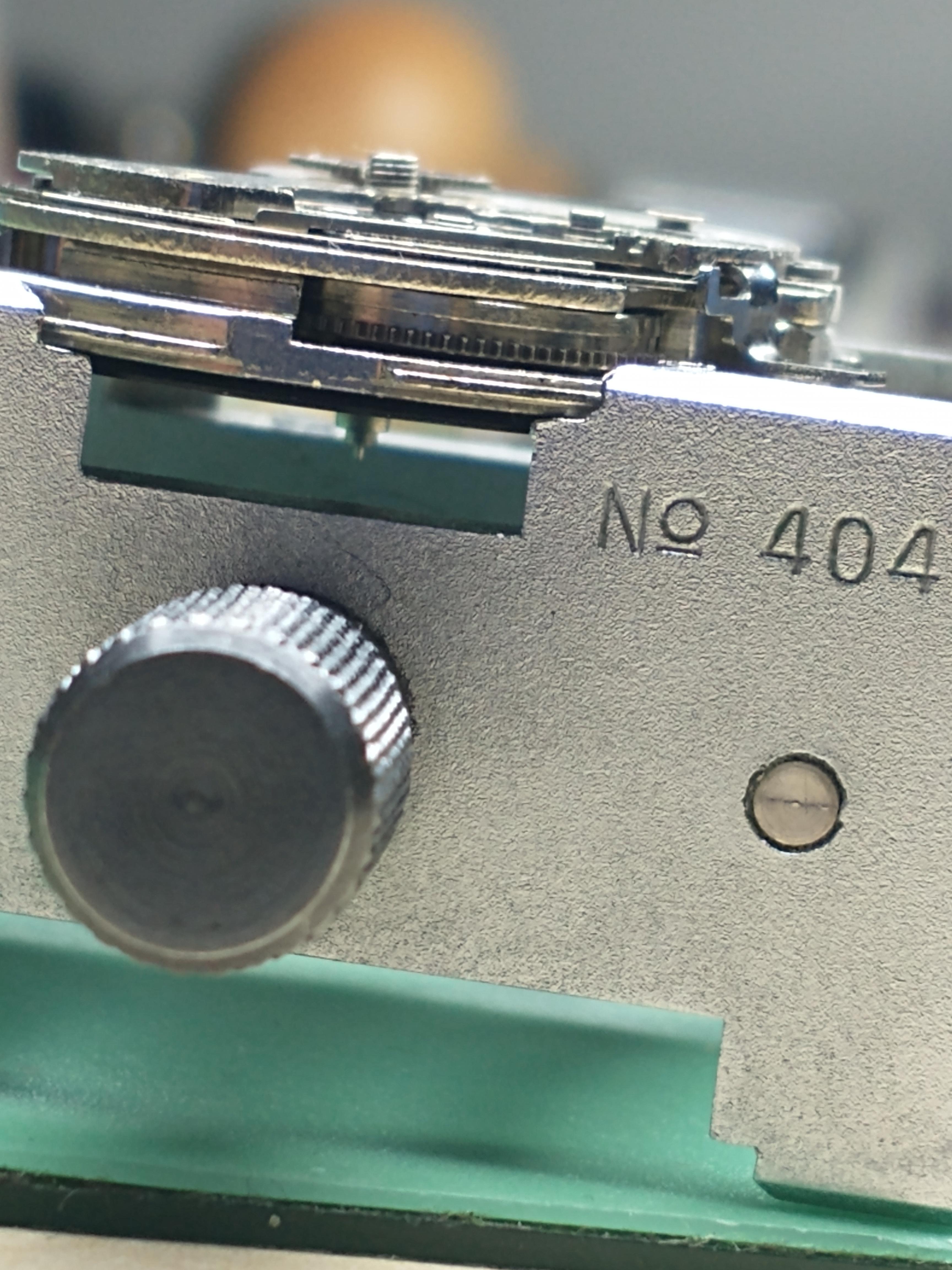

Hi Nucejoe
The barrel bridge seems to have too big bushing compared to arbour diameter. I wonder why so much difference. There is also wear beneath the barrel bridge where the barrel touches - will it help with some grease to minimize resistance? I can tilt the barrel by moving it vertically with a tweezer around barrel teeth and also by moving the arbour horizontally on top. But when the mainplate is installed, then the arbour top doesn't move horizontally but moves/tilts when moving vertically around barrel teeth. I also replaced the mainspring with a better one as the old one was not aligned good enough when laying on the table.
IMG_20221120_235459454.thumb.jpg.5ff7e4436e166dfcc1563aa9ed6e3bc2.jpgIMG_20221121_002908473.thumb.jpg.248a89bbe5d310eaf7e3c58682e15434.jpg
Hi Ammar,
You have spotted the fault, completely worn out or missing the mainplate bushing.
Your local watch maker might source you the bush.
Rgds

I think I have a solution.
I placed one dial adhesive dot below barrel bridge to raise it - Close to where barrel was hitting the bridge. I now have a straight space between the bridge and barrel and the barrel runs straight horizontally. I checked all this without the Chrono parts. With balance and power on, the amplitude was around 230 so not bad at all. BUT when turning dial side up, the watch stopped. I assume the hairspring stud was touching the balance wheel which was running wobbly possibly caused by worn pivots. So I'm out for sourcing a new balance. I bet the 7005 balance must fit?
Edited by Khan
Seiko parts manuals show the same balance complete for both 7017A and 7005A movements.  All of the following movements share the same balance complete assembly (P/N - 310020)
Balance cocks will obviously differ.  The only one I found that shares the same balance cock as yours (P/N - 171033) is the 7018A.
 Have you checked the balance pivot for wear?    And if shimming the bridge creates new problems then shimming isn't  the right approach.
We are still not sure of the exact cause of the wobble in the barrel nor that of the balance.
Rgds
Surprisingly, the barrel isn't wobbling now. I guess the alignment of the barrel bridge by the adhesive dial makes the connection between arbour and barrel bridge more stabilized.
