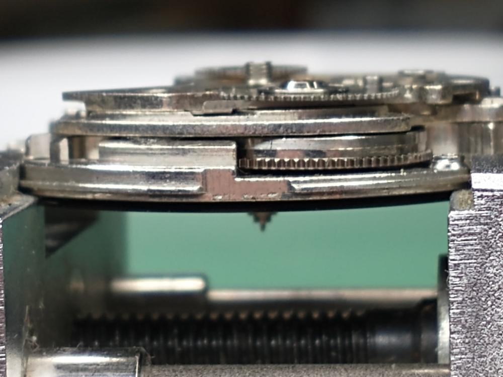

Although I have limited experience, rarely are dial dots a solution for anything. I can’t offhand remember the company in Oz that can provide jewels for some Seiko movements, this maybe something to look at to have a more permanent solution. This is for barrel arbor as a lot of seiko movements have this problem.
Tom
Hi
Tom, I totally agree - I should source a jewel for a long-termed solution.

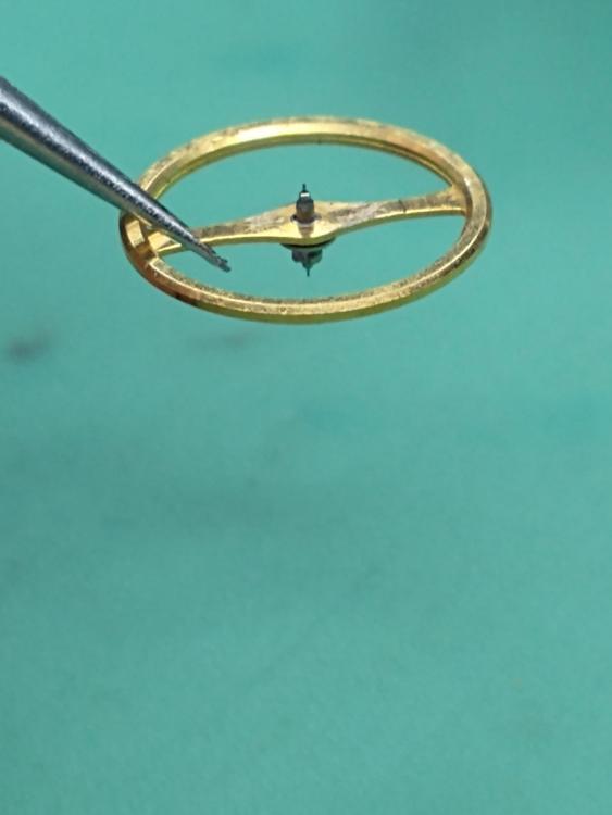

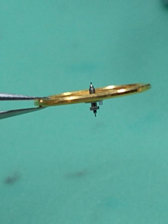

I just attached a cross section where the dial dot gel is located. And images of the balance staff, how looks the condition? Hope the resolution is okay or I can try get a closer look.
Worn pivot on the cock side.
A trick that works, is to flip the cap stone so the domed side faces the short pivot. Some folks call it dirty trick but it works. 😩
A chrono Seiko is worth getting new balance. This one doesn't need bin residency, I usually instal them in cheap pieces.
Good luck.
