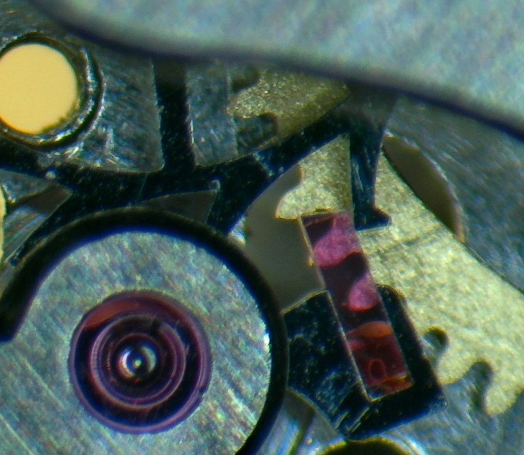

Interesting. Looks like something wrong with the entry pallet, but why would that only occur CU ?
The entry stone is right under the centre seconds wheel, so hard to take a pic.
It's very hard to see, but I noticed that the the roller jewel looked very close to the bottom of the pallet fork (bottom of the cut out, not the guard pin). I wonder if it's hitting? Could that explain the CU plot? - in this position the pallet fork is hanging vertically down, so any play in the pivots would move it closer to the roller jewel.

That's a ton of lock on the entry pallet. Like more than double necessary; that alone will eat 30+ degrees of amplitude.

I took a better pic of the entry stone with the seconds wheel removed. The lock is more than half with width of the stone!
The exit stone has similar lock.
Exit stone :

This is a perfect example of why when diagnosing problems you should look at more than one position. Dial-up and dial down should be identical it will rule out pivot and jewel issues. Then going to the vertical positions also helpful for diagnostic purposes. I ask you like to do six positions but I get spoiled at work the machine just does that all by itself. But still even at home I used to do all my watches and six positions just because the microphone does rotate makes it easy to do.
Then your interesting waveform is not just the pallet. It's basically one side of your escapement appears to be having a problem. So it can be the pallet stone it could also be the roller jewel a could be also the fork slot even though it seems like it should show up other places. So basically one side of the escapement. When it's doing this interesting waveform what does the amplitude look like? In other words visually does the amplitude look like what you perceive the timing machine says. Often times of the amplitude is way too low you'll start to see all sorts of interesting things which may be an amplitude issue. But I'm still bothered by the waveform kind of well basically is not Street is weaving around a little bit that's an interesting issue caused by what?

It's not uncommon at all for it to be necessary to adjust the escapement a bit on a watch this age
Is there any reason why this is so? Were such movements in the past just not adjusted out of the factory to have high amplitude, due to the excessive lock on the pallets?
WOW
@nickelsilver you have opened my eyes. I didn't realise such a small tweak to the pallet stones could make such a difference. And I can't understand why they are wrongly positioned when the pallet looks original.
After reading your explanation, and Fried's, I had a play around under the microscope to get a better understanding.
Then I just pushed both stones in a touch, and gained about 40° : 275° DU/DD. CU/CD are both about 225° and clean plots.
I need to clean and lube the pallet (looks like something on one of the escape wheel teeth), so it may get better.
I think it would be safe to move them in a tiny bit more, but I'm happy with what it's showing.
