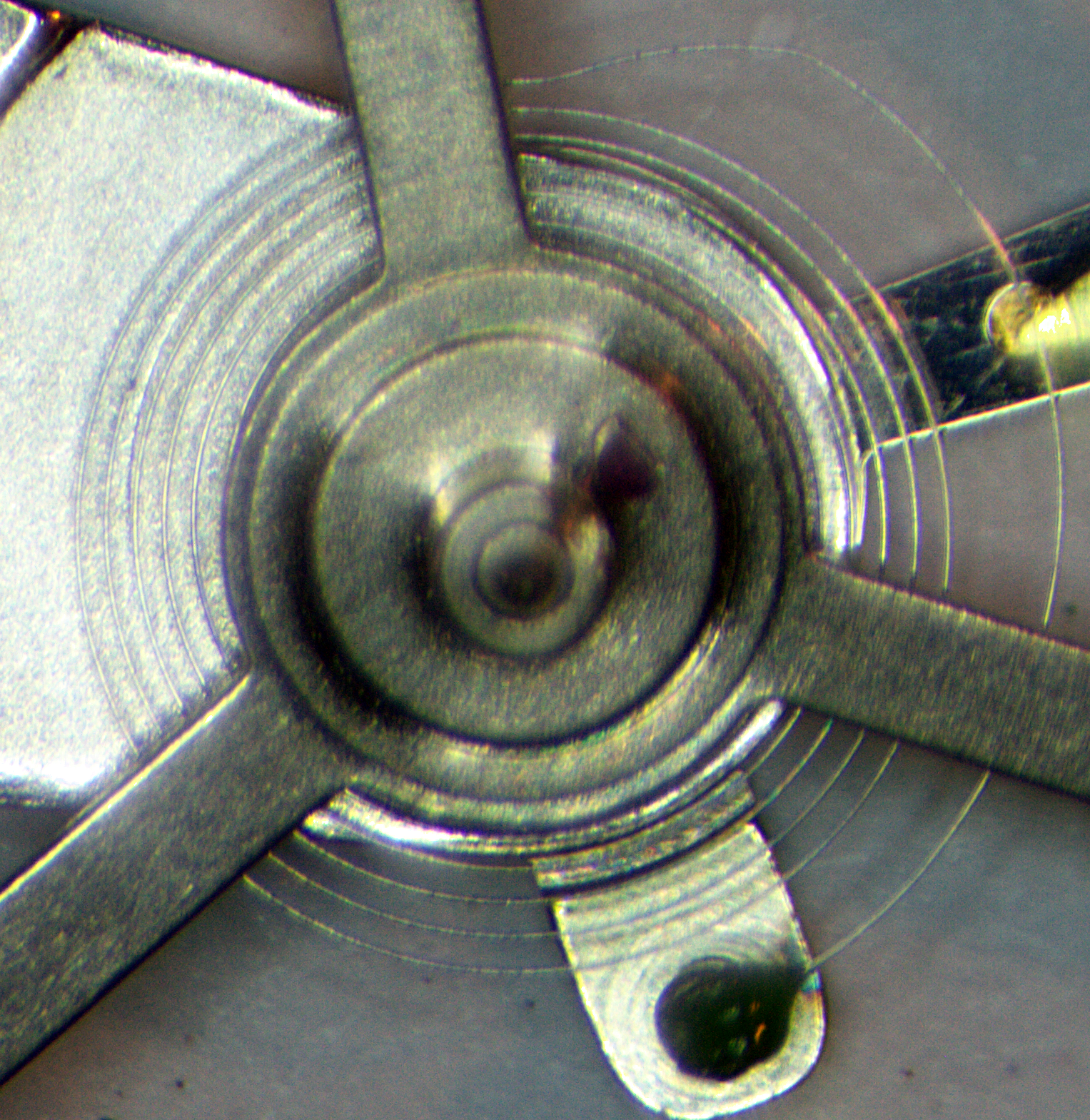

This AS 5206 from the Jules Jurgenson is going to be the death of me. I've got it back together, and it's running very poorly. I noticed the hairpspring keeps bunching up when running.
It looks good off the movement, but when I push the coils together they stay stuck. I demagnetized a few times with my Elma antimag, but no change.
I've already cleaned it in lighter fluid/naptha twice, but I can't come up with any other ideas besides "dirty hairspring" and "demagnetized."
Do I need to get a better cleaner? How do I know whether the problem is magnetism or a dirty hairspring?
Adding a couple photos at rest, and after giving the coils a little push.
Are you rinsing it after cleaning in lighter fluid? If not there may be residue. Try rinsing with 99% Isopropyl alcohol, and dry it with gentle heat,  with the parts in a basket you can use a hairdryer.  A puffer works, too, if you have one.  Fluid can get trapped between the coils and take forever to evaporate,  but I'm not seeing that in your picture.

But my real guess is that you have something sticky on the hairspring and lighter fluid really isn't's a good cleaning product for watches despite the fact that everyone on this group thinks it S getting something more appropriate would be better.

I'm with David on this one. Last month working on an old sekonda, i was convinced the hs was magnetised as it looked visually clean but kept sticking. After demaging several times with no change, so i got in very close with a scope and with a little experiment when  magnetising a hs i could see the coils pull together when they got close enough. Other contamination needs a closer contact to stick. A thorough clean by pulling out the spring, some agitation of the cleaner with a puffer and even got a very fine artists brush involved. No more sticking of the coils.
