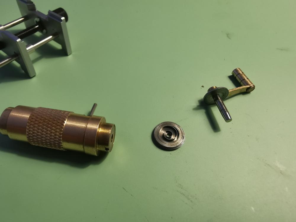

Welp, I got the cheap set in the mail this week, and I also got 4 spare seiko 7009a movements for parts, so a good time to break some more mainsprings.
They aren't bi-directional although I initially thought they were.
As said above, they're definitely made for specific calibers, and the closest I could find for the 7009a barrel was the miyota 8200 set, which is honestly probably too small. There's another set where the winding barrel sat exactly on the mainspring barrel, not inside it, that might have worked, but it seemed like a recipe for disaster.
That said, I managed to obliterate one mainspring through my own inexperience and testing/practising. But the next mainspring I happily got wound up and back into the barrel.
Good enough for a hobbyist I'd say.

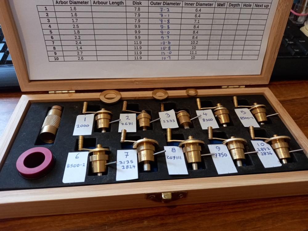

Sizes mm
Left to right top
2000 = 7.2    2671 = 7.1    2235 = 7.8    8200 = 9.8   8500 = 9.0
Left to right bottom
8500 = 9.3    3135 = 10    CO711 = 10.8   7750 = 12.0    2892 =  10.7
All Right Handed. Left as well if you use brass washers filed out to the same size. insert, then reverse
I purchased some brass washers and have spent some time filing out the innards to fit the outer size of each of the Chinese winders. I now have the facility to place 10 different size springs left or right. It would have been too long to wait whilst I purchased springs of each size. Total cost £6.69p.
I don't follow you on the brass washers.  Do you have a photo?
7 minutes ago, gpraceman said:
I see mention of the Bergeon #5, 6 and 7 being common mainspring winder sizes.  Does this budget 10 piece set cover those sizes?
Here you go.
On the box above the holders are the washers I purchased. I filed them out to fit each individual wider and have inserted them on the winder.
Edited by rossjackson01
more information
39 minutes ago, rossjackson01 said:
Here you go.
I like the cheat sheet.
You've still got me puzzled on the washers.  How do those let you do left handed?
