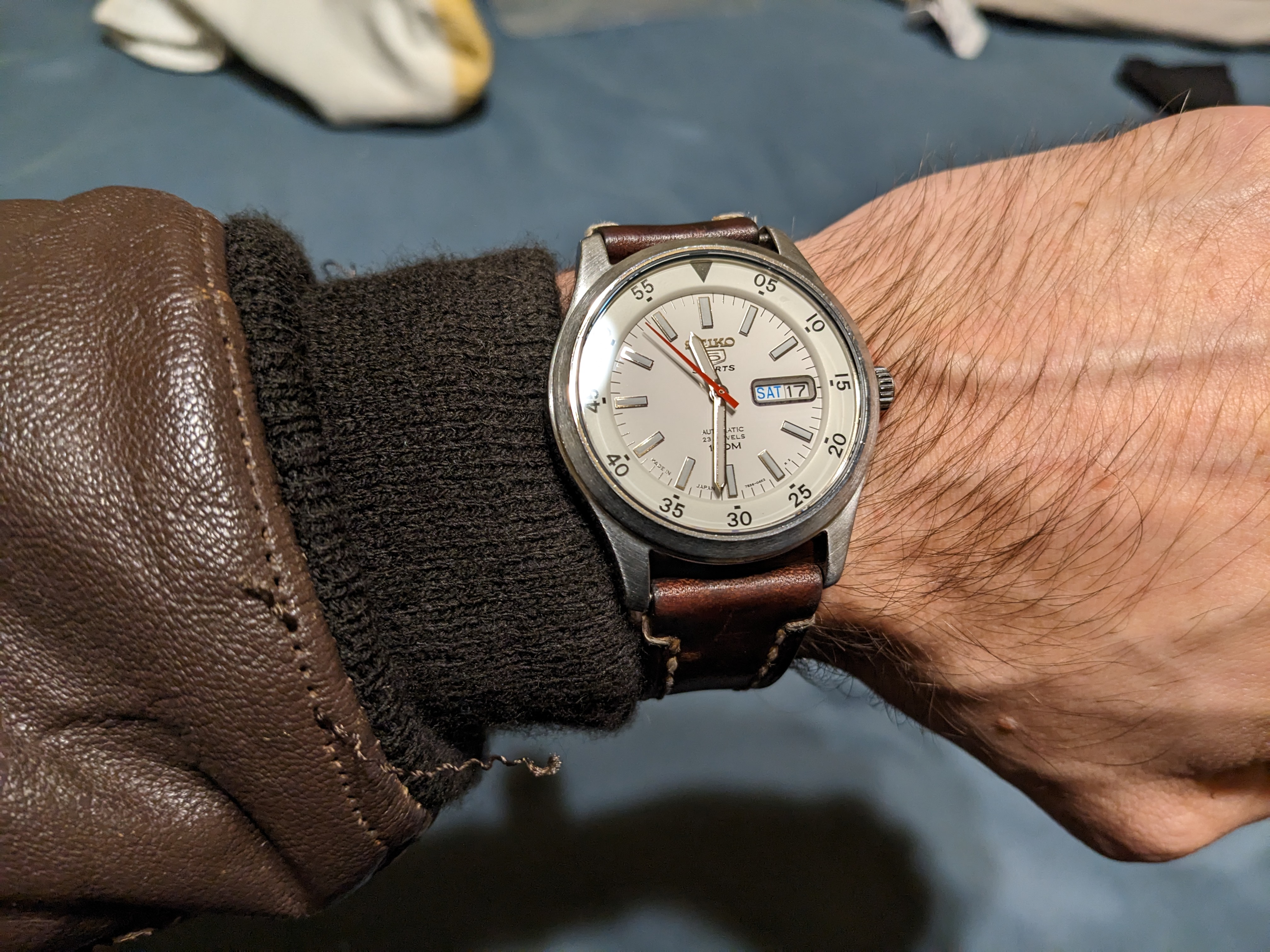

As another aside. Got the damn gasket in for archives sake the correct part number is indeed 86622310 even though it does not come up as compatible with this case code. It appears once you fit the bezel it deforms the gasket so much it can't be reused. Using a cheap chinese crystal press i got the thing in and managed to...mostly set the damn new crystal in the new gasket. Using the strength of f'ing THORE i managed to get it seated 100% in one side and about 98% in the other, that 2% will drive me nuts but i'm calling it done, if imperfect.
My second watch repair and service is done and i'm so happy to get her back on the wrist.
On 12/9/2022 at 3:12 AM, aac58 said:
The Seiko code for the gasket you're looking for is 86622310 (according to Boley.de). Cousins has it in stock (8.15 pounds plus taxes and delivery), I don't know about other suppliers.
This ended up being correct. Appreciate ya and everybody who helped!
